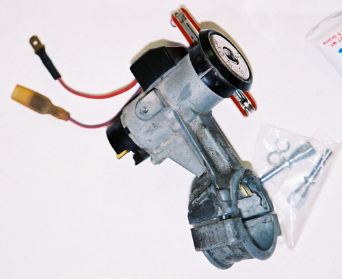

I think Kats is talking about this type of ignition switch. Notice the black box on top of the cylinder.
That looks like the replacement Ignition Lock /SW assembly that I bought a year or so ago. The black part is just a cover for the two lugs that those wires are soldered to. (I had to remove this cover to reconnect one of the wires that was ripped out by a would-be thief. The switch must be internal to the lock itself.
What other type of Ignition lock/sw is there (other than this one?)
The other style did not have that hood, and the wires just led in directly into the switch which is located at the "top" of the cylinder housing. That is, the wires are almost where the bezel meets the cylinder.

You mean the one Chris (26th-Z) posted? As I went to take pictures of my Ignition Locks I've discovered that mine are somewhat different than the one Chris shows. The wires on mine are on the opposite side of the assembly.
On my parts, No, it couldn't be for a lamp, it's completely enclosed, except at the end where the wires protrude. Inside the enclosure, there is only the lugs that the wires are soldered to.
All 3 of my Locks have the wires in a different location from the one shown by Chris, and only the New Replacement one has the hood.
I have attached 1 pic (IMGP1059 Large) of a new OEM Replacement Lock that I bought from Courtesy about 1.5 yrs ago. The other two pics (IMGP1060 Large and IMGP 1061 Large) are original Ignition Locks from 3/71 and 11/71 mfg'd HLS30-U's and don't have the black plastic hood over the wires.
I also have a (4 yrs relatively new) Replacement Lock installed in my car and it is identical to the one shown with the hood.

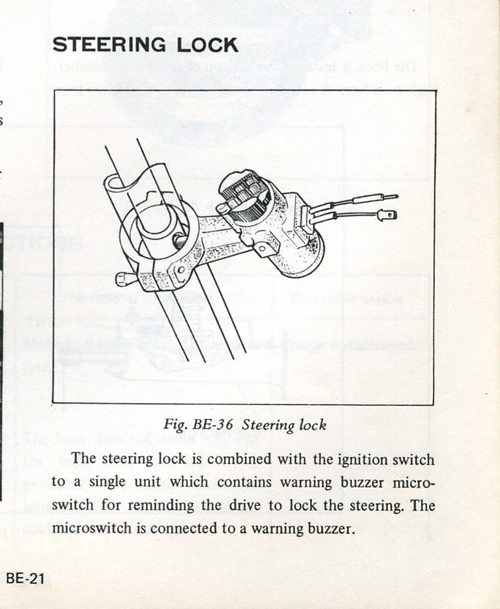

All of a sudden it occurs to me; "Look it up in the book"!!! Here is what I have. The FSM goes on to say; "WARNING BUZZER It operates if the door is unlocked with the key inserted in the steering lock" The warning buzzer is installed on the steering support.

....The FSM goes on to say; "WARNING BUZZER It operates if the door is unlocked with the key inserted in the steering lock" The warning buzzer is installed on the steering support.
Then from the picture Chris posted:
"he steering lock is combined with the ignition switch to a single unit which contains warning buzzer microswitch for reminding the drive to lock the steering. The microswitch is connected to a warning buzzer."
Mine only operates when the door is OPENED and the key is still in the lock, regardless of whether the steering wheel is locked by the ignition lock or not.
The translation from the FSM may have mistaken UNLATCHED i.e. opened; with unlocked, but the picture text doesn't "compute", unless there was a separate switch that we're presuming is the same as this one.
