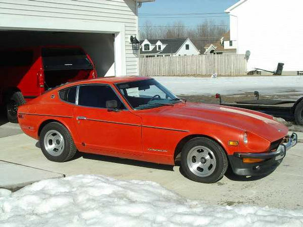

The yellow Z in this picture has 20 percent on it it looks pretty dark fron the outside but you can see out of the car just fine. this is the only pic I got at the moment, the car is at my brothers house.

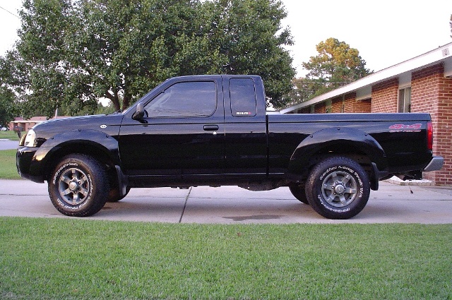

Here in SC the law is 30%. The police WILL check if they pull you over, most carry the light gauge in their cruisers. My Frontier has a black 3M film on it that has a "metalic" content to it so that it reflects heat but the tint does not look silver or metalic in any way. I believe the film is 34% and after being applied to the window it equates to 32%... Legal for SC. I have a guy locally I've been using since high school and he charged $50 for my truck and was finished in about 30 minutes. The 3M film is guaranteed for life and he guarantees his work completely. On my last truck after all the bubbles and haze went away, about 5 days, it became evident that the passenger window had a small bug trapped between the glass and film. No problem he replaced the piece and it was perfect.

Also here is a pic of the Frontier @ 32%. Still had the stock tires...
