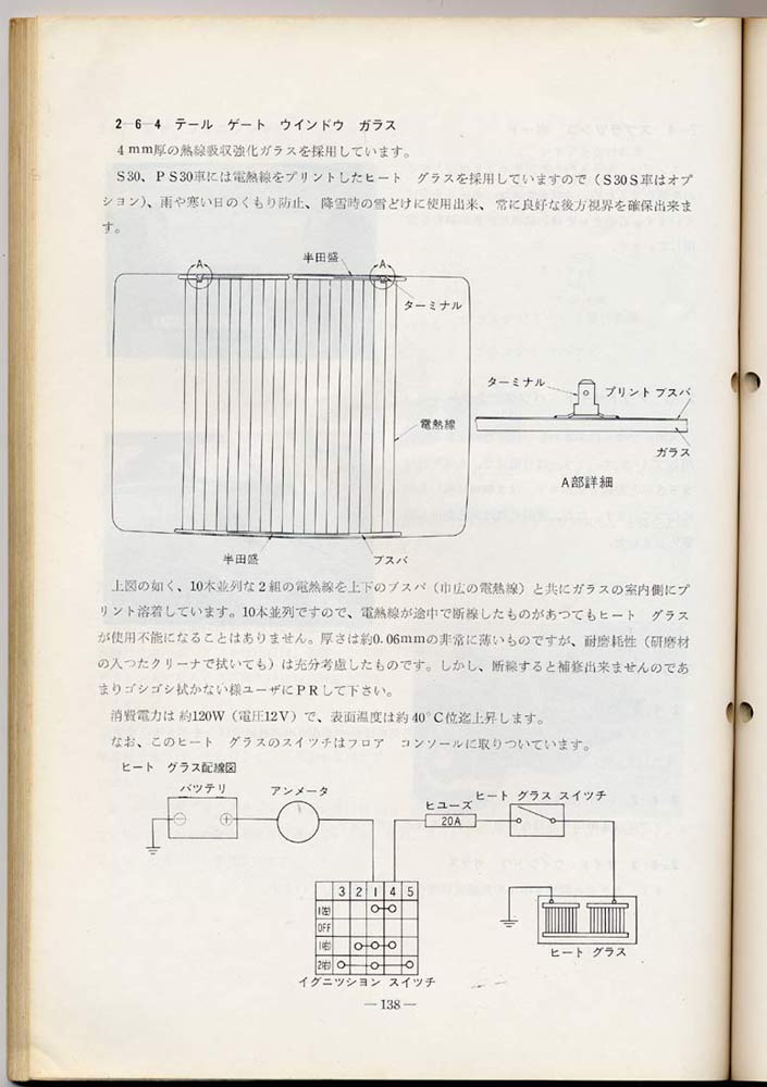

A scan of a couple of pages from Nissan's first "Service Shuho" booklet from November 1969, introducing the new Fairlady Z models to the dealerships. Page no.138 has a line drawing of the HRW element system and wiring, and mentions that this is fitted as standard to the S30 and PS30 but is an 'Option' on the S30S.

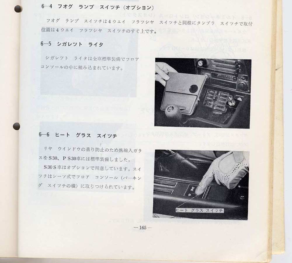

Page no.165 shows the operation of the HRW switch on the console panel. I think the gloved hand is Matsuo san's.

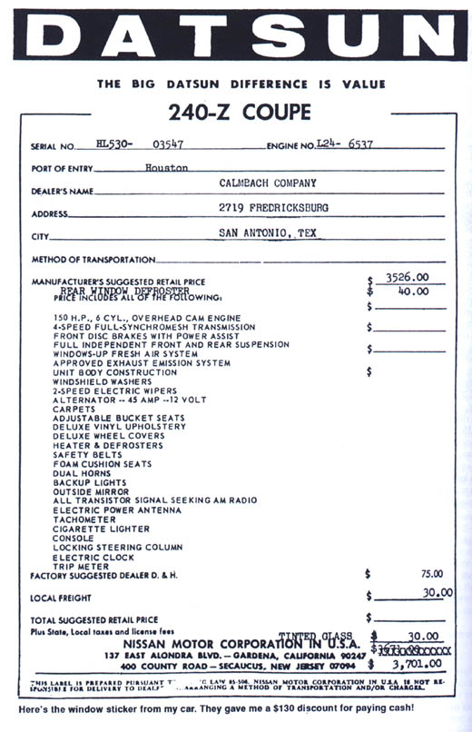

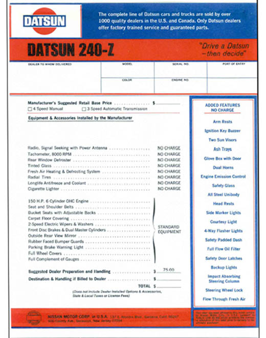

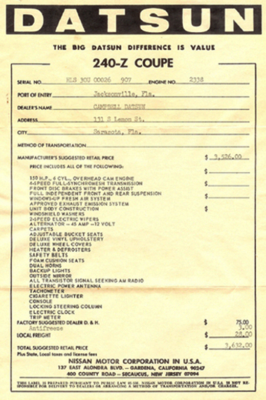

The first "window sticker" I have posted is from Her Majesty; the yellowish print. The second is from a known 1970 production car. And the third is a blank from the 1972 model year. I am working on a collection of North American Service Bulletins which may indicate when the "change" was made, but this is a patient game and it may be some time before I aquire the information. I DO know that the illuminated switches began in January 1971 with what is refered to as the Series Two cars.
