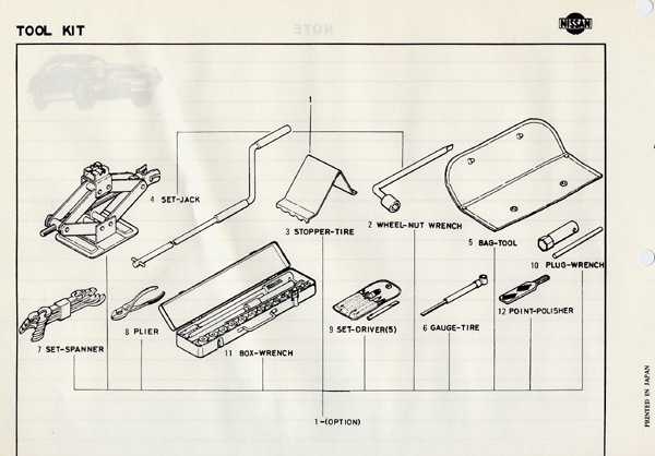

I was quite surprised to find those pages in the parts book I just received. To the best of my knowledge, tools did not come standard with North American delivery cars. My quest to find them begins at once! The hold down straps for the wheel chocks and clip for the jack is particularly difficult and the ones I have seen on eBay usually come with the complete set of jack and tool bag.
Sorry Mike, my R-DRIVE books only go up to 1974.
However, if its any help or consolation, the illustration that applies to the Export "RS30" and "GRS30" is the same as the one I posted.
Don't forget that many of the tools on that illustration were listed as "Option" parts. In my experience, that means that 99.9999% of customers buying a new Z were actually unaware that they even existed! I think the 'full' on-board tool kit is a very rare beast indeed.
And if a customer specified all of those optional tools on one of the earliest cars, then I think they would surely have trouble finding enough places to store them all?
