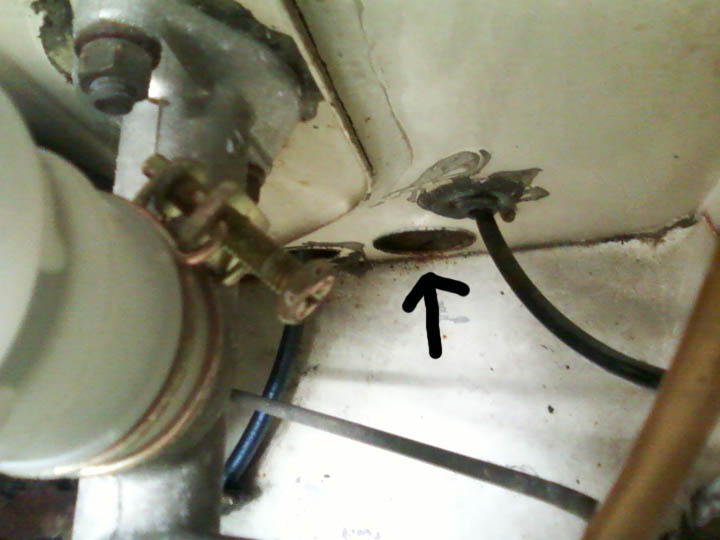

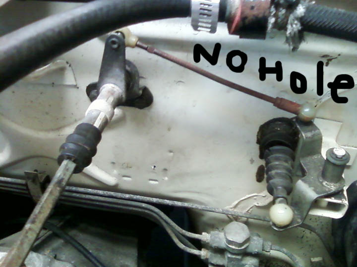

Posted May 7, 201114 yr comment_355054 I am trying to install a choke cable on my 73 because it didn't have one installed when I bought it. I took the cable off of my 71 and thought I would install it on the 73. Then realizing the hole that the cable goes through on the 71 isn't there on my 73. Sooo..... My question is: A) Is the 71 and 73 cables different Do I have to cut a hole in the 73 to make it work. (Doesn't sound right) C) The picture with the arrow is the choke cable hole (below the CMC) and I need to find one that will work for my 73. Because it would need to be longer because the position of the hole. :stupid: I hope this makes sense and any help would be appreciated as always. Link to comment https://www.classiczcars.com/forums/topic/39498-installing-choke-cable/ Share on other sites More sharing options...
May 7, 201114 yr comment_355071 I seem to remember having the same problem when I bought my '73. Turns out the hole is on the passenger side Link to comment https://www.classiczcars.com/forums/topic/39498-installing-choke-cable/#findComment-355071 Share on other sites More sharing options...
May 8, 201114 yr comment_355128 I agree with BadDog, if the '73 is like the '74 260z it will be on the passenger side. I only say this because I have seen Vitamin Z's 260z. Since goes through the passenger side, I am not sure if they need a little longer cables or not. I am sure another Z expert has the answer. Link to comment https://www.classiczcars.com/forums/topic/39498-installing-choke-cable/#findComment-355128 Share on other sites More sharing options...
May 8, 201114 yr comment_355135 Yes, the 73 cable is longer, right at 6 foot, had mine out for a good lube 3 days ago. If you want to use the 71 cable a hole will have to be made on the drivers side, in the same spot as the 71's, use the choke grommet, then plug the passenger hole with a rubber plug. Or sell the 71 cable and get one for a 73. The 73 will have a bracket that bolts to the valve cover that holds the cables down to keep from rubbing on the hood.Bonzi Lon Link to comment https://www.classiczcars.com/forums/topic/39498-installing-choke-cable/#findComment-355135 Share on other sites More sharing options...

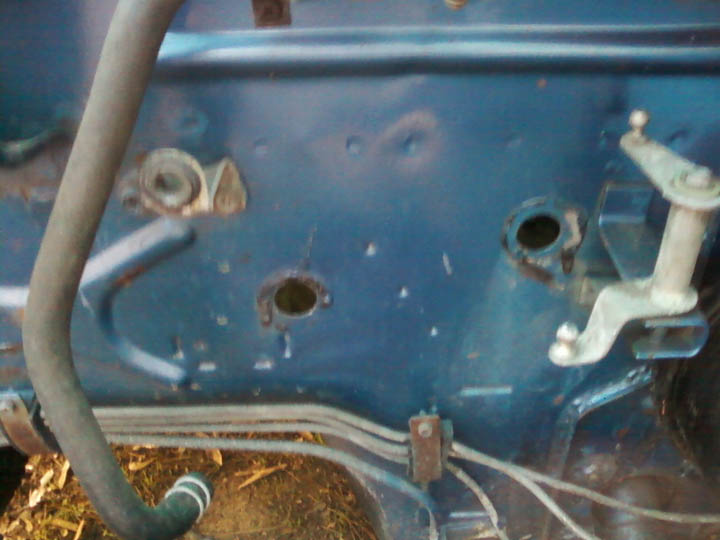

May 8, 201114 yr comment_355146 Don't know how well this pic will work, but that is stock 73 cable location. Don't cut the fire wall for a choke cable, thats just wrong. You can see the dual boot peaking out just under the hood latch bracket. Edited May 8, 201114 yr by 5thhorsemann Link to comment https://www.classiczcars.com/forums/topic/39498-installing-choke-cable/#findComment-355146 Share on other sites More sharing options...

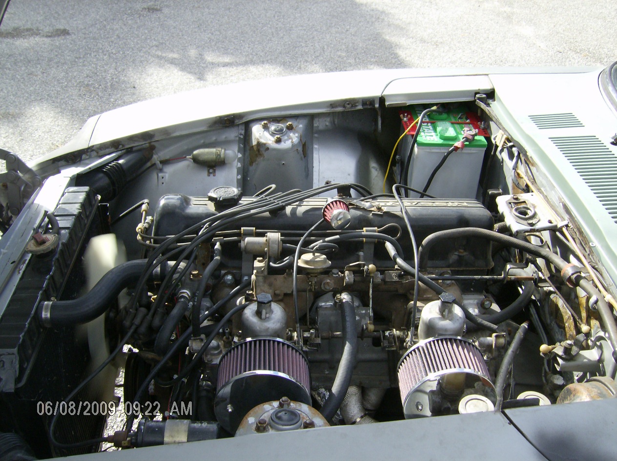

May 8, 201114 yr comment_355150 Here is another shot of the choke cables from my 74 260, I've been looking for new ones also and they don't come up very often and when they do they are quite expensive. If you find a good source let us know. Mike Link to comment https://www.classiczcars.com/forums/topic/39498-installing-choke-cable/#findComment-355150 Share on other sites More sharing options...
May 8, 201114 yr comment_355155 FWIW, I moved the choke cables on my '73 to the pre-'73 position when I utilized the original hole for my A/C install. If you remove the firewall insulation (also there is a pre-punched hole in the insulator that hasn't been punched out and it is in the exact place for the hole you need to drill) you will find a dimple in the sheet metal where the hole for pre-'73 choke cables can be drilled. It's right under the throttle control rod mount on the firewall. I found that the longer cables were very stiff resulting in broken levers. By shortening the cables they are much easier to use. Good luck.Cheers, Mike Link to comment https://www.classiczcars.com/forums/topic/39498-installing-choke-cable/#findComment-355155 Share on other sites More sharing options...
May 9, 201114 yr Author comment_355204 Wow, great info as always. I don't like to modify my Z at all but am willing to adjust as needed. I will weigh out pricing and availability. I checked and my 71 choke won't work because of length. Ill think for a few days and then decide. My 73 runs so smooth and starts up so quickly a choke wont become a factor till late fall so I have time. Link to comment https://www.classiczcars.com/forums/topic/39498-installing-choke-cable/#findComment-355204 Share on other sites More sharing options...
May 21, 201114 yr comment_356428 As the other replies have stated, the '73 240 and the '74 260 had different choke cables, longer and they snaked around under the dash to come out on the right side of the engine. They were always known for not working properly, stiff and difficult to get them to open all the way due to binding. For several years I tried all sorts of things to get them to work right. I finally gave up and bought a pair of 240 cables and drilled a hole in the left firewall, the same diameter as the cable grommet, and installed them. The choke has worked great ever since. I did this conversion probably in 1978 or 79. I know that alot of owners are loathe to start hacking and drilling on their prized babies, but this is one time that I wouldn't hesitate. It is, in my opinion, the only way to make the choke cables work properly. Just be sure to cover up the original hole or you will get engine bay fumes inside your car! Link to comment https://www.classiczcars.com/forums/topic/39498-installing-choke-cable/#findComment-356428 Share on other sites More sharing options...
