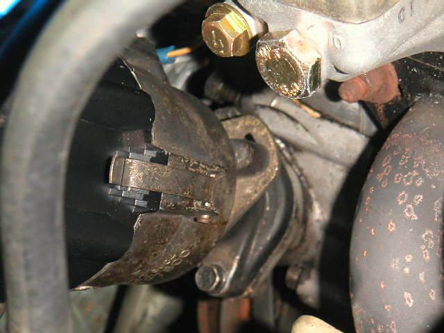

this is the screw I am refering to

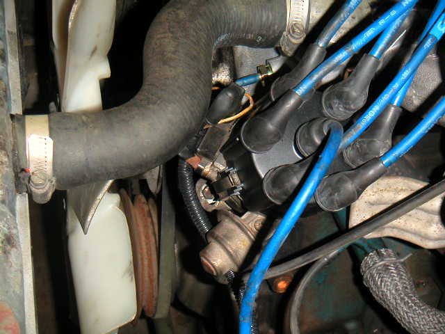

Robin thanks for the link , I switched out the mount and turned it 180 to reverse the mount of the dizzy , but the vacume advance hits the top radiator hose housing, and the distributor shaft will only go in one way , kinda sure I have it in correctly , any thoughts?
