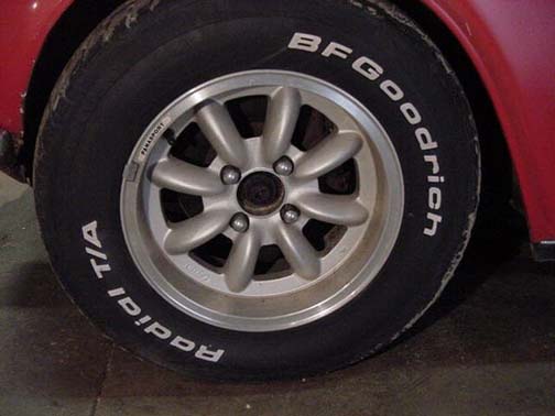

Hi, this is my first time trying this forum out. Yes, some four lug Fords are the same bolt/lug pattern as the Datsun 240Z - 280ZX, check this site out http://www.alliedracingwheels.com/patternref.html it is one of many such charts I've found by searching google, and shows there are many options, even wheels from old Chevy Corvairs, MGs, SAABs, Triumphs, etc. You've got to scroll down a ways for the big list.:D My Panasport wheels were on a TR6, but fit my 240Z fine. Still looking for original Panasport Center Caps, 1,2,3 or 4. Hope this helps. ROFL
