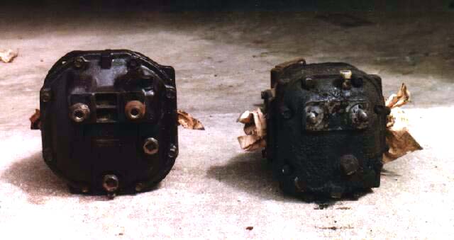

So is this a r200. The owner said it came out of a 1976 280Z but I did not think that the r200 came in that car. Am I just mistaken on this? I was curious because Motorsport offers a LSD for a r180 up through '76 and a r200 from 77 on.
Thoughts?
SuDZ

Sorry, forgot to add the picture :stupid:
