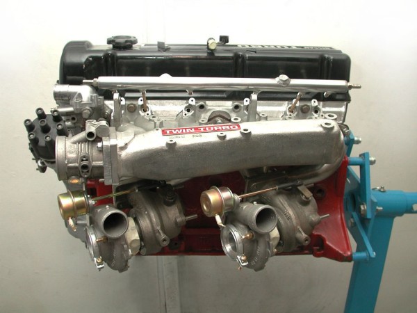

This is the second time I heard of this. I went to the Tuner Bash here in Florida, and met the guy who had his 1971 Skyline in the January 2003 edition of "Super Street." He has a L28 in his car. I asked him what type if setup I would need to rebuild my L28. He said that with the big bore kit and supercharger from Jim Cook, all you will put out is 500hp. (est) He said that a company in Aussie makes a kit with a twin turbo setup for the L. He suggested to use small turbos because they would spool up faster. Now, of course I would have to do some internals to the engine, but I really want to know if this company is still around. I asked the same question on Hybrid Z, but no answers yet. Help please.:cry:
Here is a pic, If I can get it to work...
Sincerly:
That picture looks like the intake manifold was from an RB26DETT or some RB motor.. and those turbo's too.
Looks like someone swapped out Skyline parts for their L28

So does that mean that the intake and exhaust manifold will mate with the L? I would assume scence you say that it looks like it was from a skyline, and it is also a Nissan engine. What would the price of the manifolds and the turbos cost? (NO EXPENCE SPARED!)
