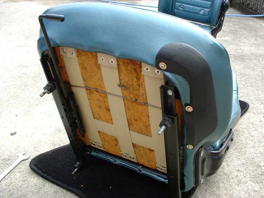

I got restored early seats for my 240Z.

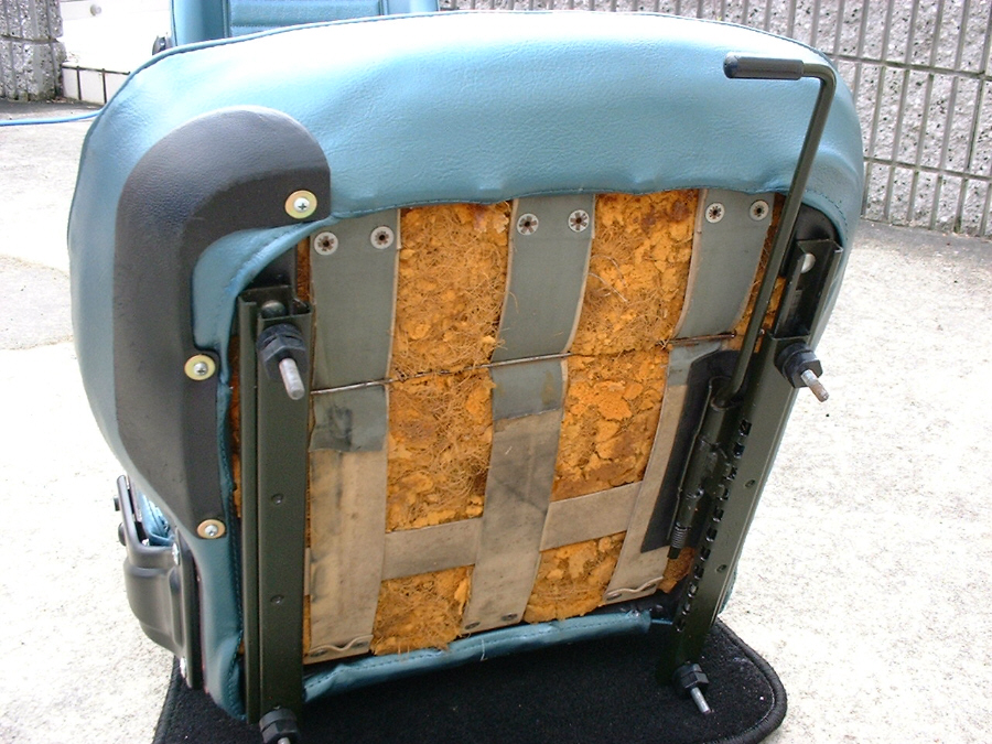

This driver's seat bottom cushion got new pad and new webbing
while passenger's pad and webbing is intentionaly remained as it is because I think it is still very beautiful.

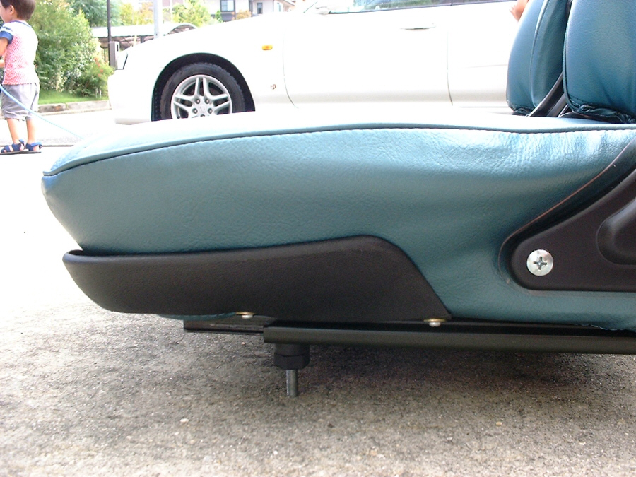

I want to know this side plastic cover for the bottom is common
for early seat?I know we can see it in parts catalog and owner's manual which mentioned for the seats,but I do not see many nowadays.

close up view
passenger's bottom,
pad and webbing is reused as it is because I think this is still beautiful.

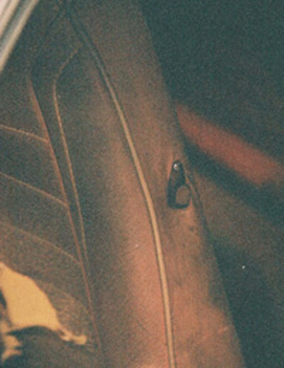

seat belt holder
seat vinyl surface is colored with special technique and all compornets are refinished or applyed new parts.

I had those plastic covers in a box that came with my car. I never knew what they were. Thanks! I would love to get a new set. I will look at the other early cars to see if they have them the next time I go visit.

For all seat mounted seat belt holders:
The very early seat belt holders were made of metal, covered with a rubber material. On my car the rubber has worn away and fallen off one of holders. The other holder still has the rubber intact. The later seat belt holders, which includes yours, are made of plastic.

Your seats look great. I have never seen that plastic protector piece before. I just acquired a seat bottom Saturday, that appears to have remnants of that piece at the anchor points. Is that still available from Nissan?

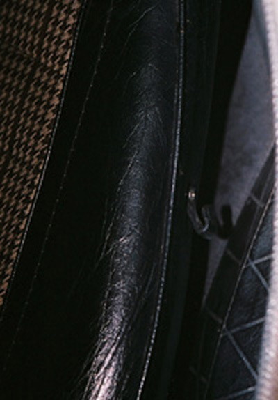

Steve,I agree with you.This seat belt holder is not original,it is modifyed from 1971later one.I have original holders made of steel with rubber,but they are so bad almost broken.
