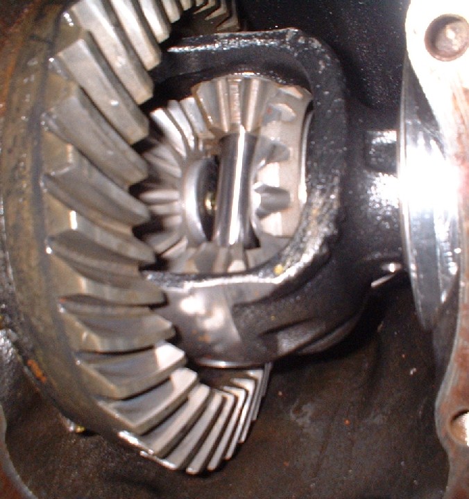

Picture doesn't show the faces of the ring gear very clearly, but it doesn't look to be galled. Spider gears have some wear but that isn't the most important part.

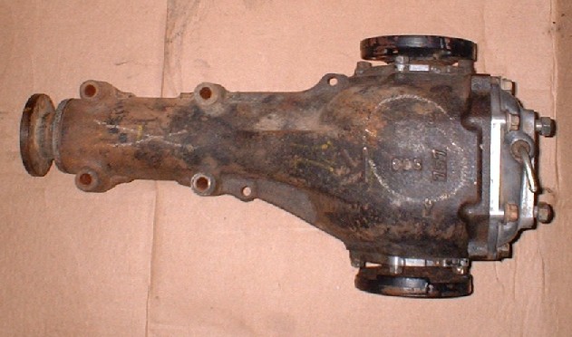

Looks pretty good to me...
:classic: The picture of the gears is a little fuzzy , but I would go for the set , I think they look good . For $100. what are you worried about , acouple of hours or labor? If you are looking for 4;11s go for it.
I don't have the luxury of an inspection as the unit is half way accross the country. But from everyone's input I will get back with the seller and let him know I want it. Thank you all very much!!
