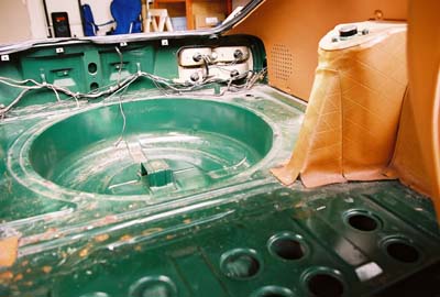

I would love to see a photograph of the tool doors in the rear deck AND tabs for the tool lids. Fascinating. Better yet, install the tool lids AND THEN take a picture. Now THAT'S rare! Congrats.
This is the best shot I have of my deck. The rear deck wall with the tool lid tabs is just below and out of the picture. But, you can see my rear deck has simple cutouts and no tool doors. I sent some photos of the tabs to mdbrandy some time ago, but must have erased them. What does yours look like?
The tool box lids for the tool boxes IN the rear deck are metal. They also have a 90° twist locking lift handle.
The tool box lids for the ones in FRONT of the rear deck (and behind the seats) are plastic. The lids have a full width hinge that screws to the floor, and the knob at the other side screws (if I remember right) onto the captive nut on the brackets on the vertical wall.

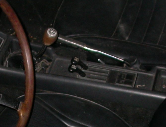

I have the hand throttle. The stupid PO removed the cable, and lost the plastic handle, but the actual lever is still there. Attached is a pic of what I had when I bought it. The second lever knob is actually a second choke knob that the PO had on the lever.
BTW, anyone know what picture is on the knob that the hand throttle would use?
Thanks.

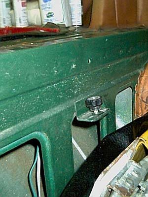

Chris,
Here's one of the pics you sent me of your toolbox tab and knob.
