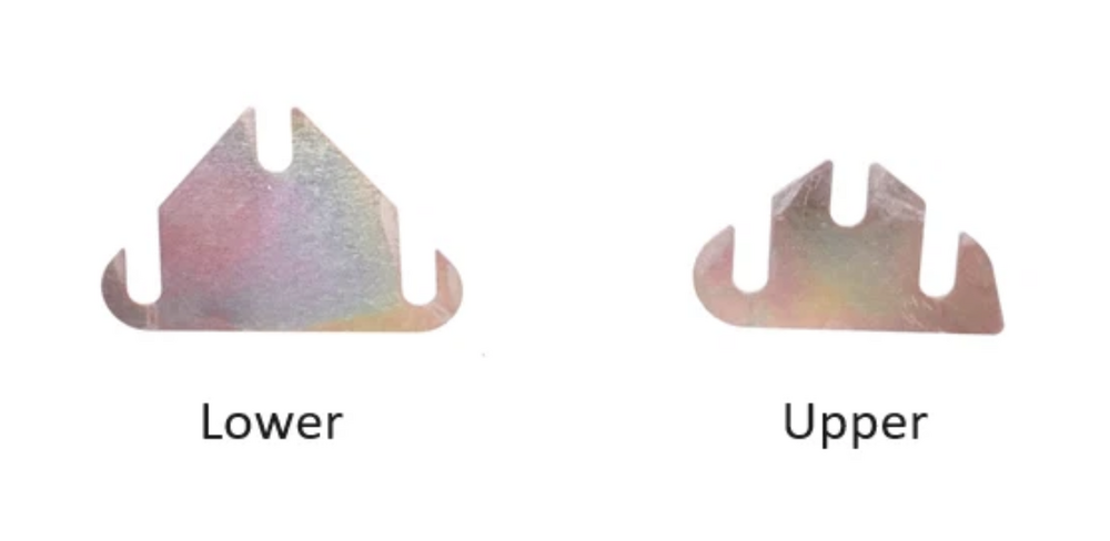

The shims look like these, I have some on my car to pull the door out some to match the fender line. These do not look like the CPM diagram either.

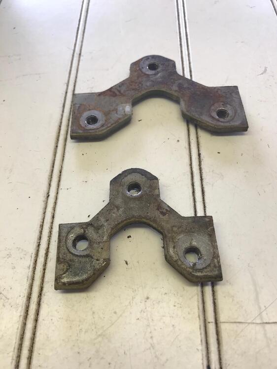

I have seen these plates in those pockets you speak of, but only on the 280Z's They are threaded and the hinge bolts to them through the body.
Oh, I do have some of those shims. I didn't know where they were to be used. I'll clean and yellow-zinc plate them and have them ready to go if needed. Thanks, @Terrapin Z
As for the bolster plates, mine are unthreaded. The threaded portion of the assembly on the door hinges. Trying to get bolts lined up inside those upper door pockets is a royal PITA, especially if you don't have slim fingers - and I don't.
While the whole assembly nominally only needs a 25 or 30 mm bolt length, I ended up using spare 40 and 50 mm bolts to make engaging the hinge threads easier and then cut them off nearly flush. Once I have the doors aligned, I'll sequentially back each bolt off a bit and apply blue thread locker even though there's a lock washer at the other end.
