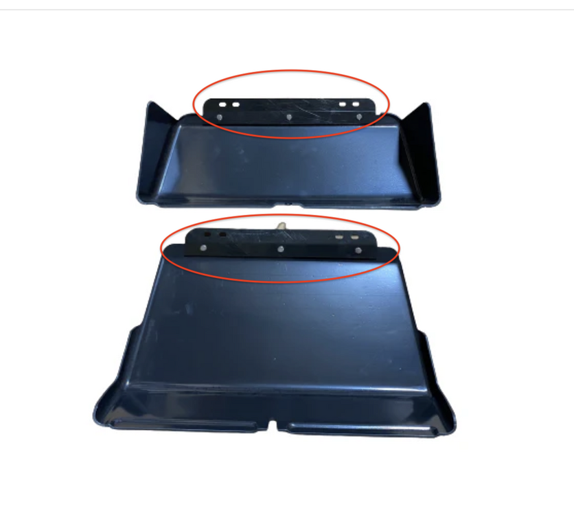

Hello
I have the boxes but no hinges
As the hinges (not a good picture Resurrected Classic site) look quite simple I thought I would try printing some
If anyone has pictures and dimensions that would be greatly appreciated
Thanks
Nick
I bought new lids with the hinges and one is already broken. I might be able to get you some dimensions
That would be great
Thanks
Nick

My original ones are out of the car sitting on the shelf if necessary.
Some pictures of those would be greatly appreciated
Nick
Nick
Datsun 240z series 1 (Jan_1971) rear storage bin hinge measurements.jpg20260607_191035.jpg20260607_190216.jpg20260607_190350.jpg

It looks like the hinge is made from a single material I can't tell from the pictures how rigid the material is?
It looks like it has a degree of flex?
Im thinking of using pla and then merging tpu for the hinge.
I guess one could go for years never having to open the box so as long as it holds together to be fitted it should be ok!!
Thank you all again for your help
Ill let you know how I get on
Nick
I think I would do the whole hinge in TPU and use some epoxy down the surface of the hinge faces to increase rigidity. If you are going to print the cover PETG would be much more forgiving than PLA.
