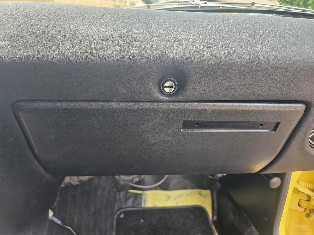

Hello all
Does anyone have a good photo or photos of how the glove box door should be installed? I put mine in this afternoon and it just doesn't sit right, nor feel right.

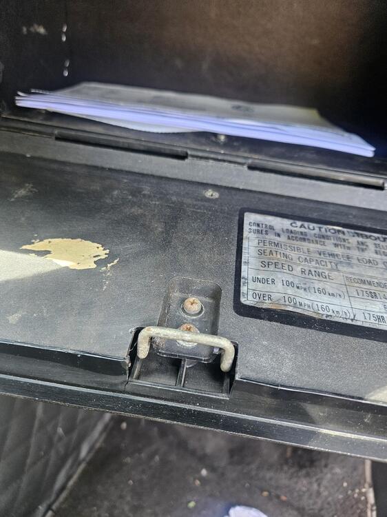

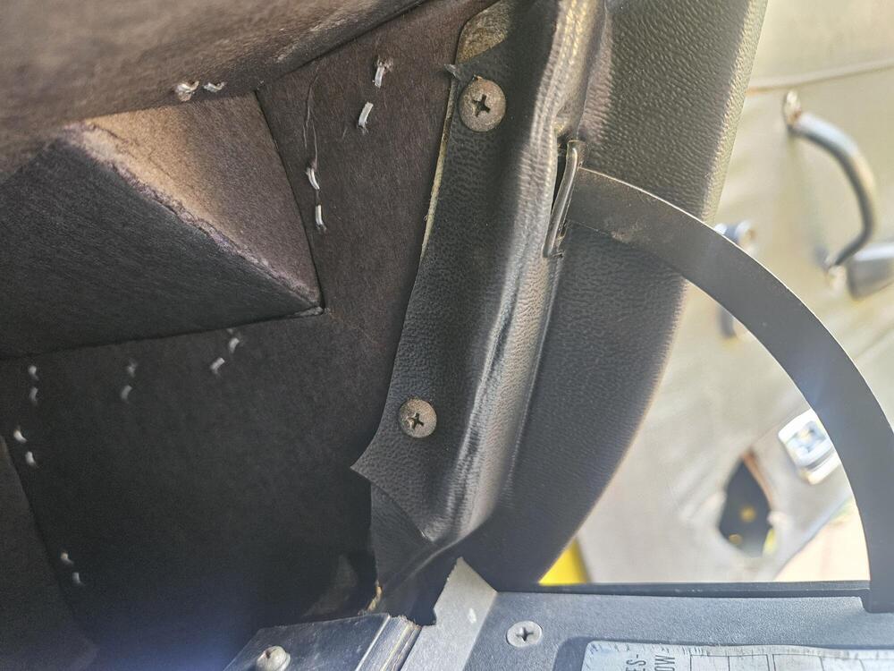

Some additional
There is a bent piece of metal that goes around the plastic lid flange
There is some adjustment at these screws because the holes are larger and allow some adjustment
There are two screws on each side that hold the glove box liner in. Not much adjustment there

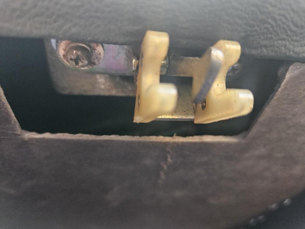

The latch on the door side can slide if you loosen all the screws on the latch and the panel screws slightly
The actual catch can be moved around some. I also had to oval out the holes in the latch to get enough movement to line up with the hole in my new dash pad.

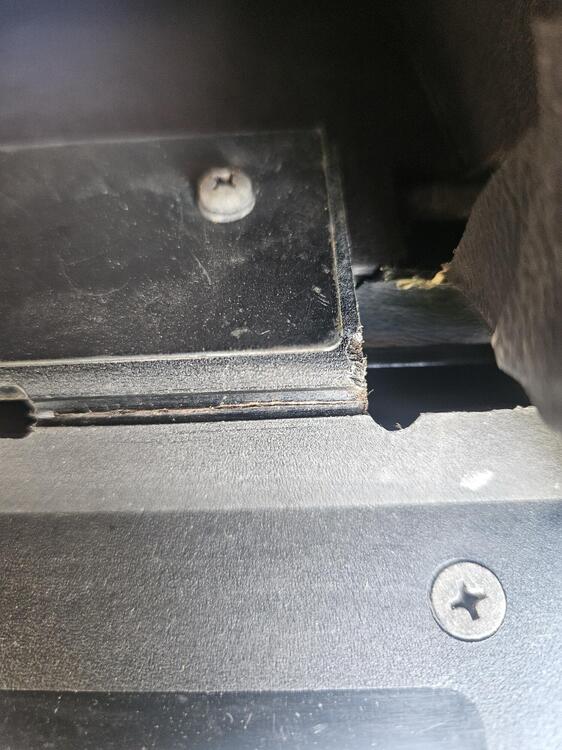

Even so, my glove box isn't in perfectly and the top line is partially warped by the glove box light pressure.
I need to design a retro kit to reinforce the top edge of the glove box door
