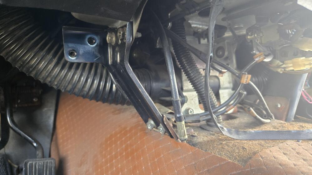

I have my center console out right now but this shows the defrost hose as it attaches to the blower housing in the 260/280. The 240's are similar. My hose is not original. Okay, I'll do the dusting before I put the console back in...
The blower end of that hose is basically just above the transmission tunnel and at the rear end of the blower box - which means it's almost to the center console front. That's fairly easy to see once you get down on the floor. Everything is a bit crowded on that side of the dash but once upside down under the dash you should be able to see or feel it all. The hose isn't very long and it goes straight up into the plastic "diffuser" piece. If it was disconnected from the blower housing you'd probably see it hanging loose near your calf as you sat in the car - and you'd feel the defrost air blowing sideways into your leg.

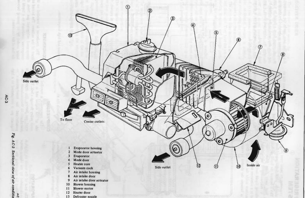

Now hang on - mine is definitely not plugged in, I always thought that was where the hot air was supposed to come out when you turn on the heater! Where is the heat actually supposed to come out then??
7 minutes ago, Zed Head said:
Interesting - in that case my 78 sends heat out of that defroster port regardless of if it is on heat or defrost. When I move the slider from recirc heat to defrost, it is definitely moving something though, which is strange.
Yup, 12. There's a door closer to the firewall that is heat to the cabin - pretty much right in front of the defrost port. It flaps up and down - well swings from closed to partially open anyway (on the 240 it's controlled by a cable - I don't remember on the 260/280...). Warm air on your feet... I have a blower box in the garage. I'll see if I can pull it out and get a pic or two. I think maybe closing that might be what diverts air to the defrost.
