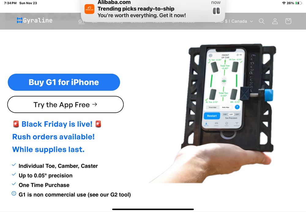

It consists of a little flat 3D printed plate that you mount your iPhone into. The plate has nubbins that let you place it against your wheel’s rim lip in a dependable way so you can align your phone to the rim correctly. Fire up the app, place the phone in a few key spots, push buttons, BOOM. Out spits your alignment.
I will say I have their version 1, been using it for about a year, and that it works. I can get a toe in and camber measurement in literally 1 minute. All four wheels. Yeah……

For the 'G2' android version, the Black Friday sale price (15% discount) is US$340 (plus shipping, tax, etc). Lots of videos on You Tube, by both the manufacturer and users.

I just used the link that Zkars provided in his #2 post. The Gyraline website currently features their Black Friday deal and offers the option of having the price displayed in the currency of the customer's location. IIRC, I had to select the 'G1' (iPhone) or 'G2' (android) product first, add it to my Cart, and then go to the Cart to see the price. I tried this posing first as a Canadian customer, and then as a American customer. The quoted price in Cdn $ for a Canadian customer was significantly higher (numerically) than that for an American customer -- but maybe that was purely the result of performing a currency conversion. Additional costs for shipping/handling and duties/tariffs might get tacked onto the Canadian price afterwards and not become visible until later in the check-out process.
