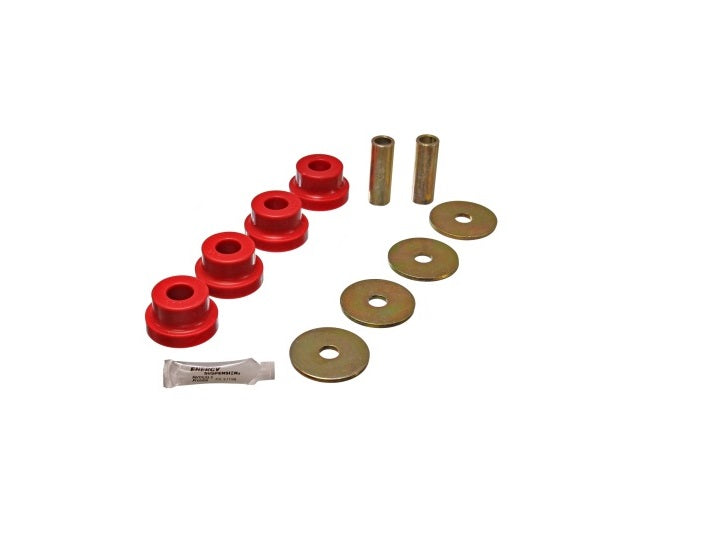

Did you replace the factory diff mount? When you use a bumper with the RT mount it essentially just replaces the strap. It reduces upward movement but the diff can also move downward if the stock mount is worn.
Also, the bushings and bumpers on the ends of the mustache bar look worn. If you crawl under the car and grab the mustache bar end with your hand you'll be surprised at how easily it can be moved up and down.
New bushings might help, although sometimes they can bring some diff whine in to the cabin.

Mustache Bar Bushings Poly Differential 240Z 260Z 280Z
Mustache Bar Bushings Poly Rear Diff Mount S30 - 800-172 (). New Energy Suspension black polyurethane bushings for 1970-78 Datsun 240Z 260Z 280Z mustache bar.

  2. I am ordering the poly bushing kit for the mustache bar. The diff whine will probably get droned out by my MSD-2225 fuel pump :-) anyway. I insulated the FP with some nice rubber padding, and it is still loud.

I replaced the mustache bar bushings and re-torqued my rear strut insulator lock nuts. I didn't notice any play there when the springs were compressed. The good news is that the clunking noise is gone.
