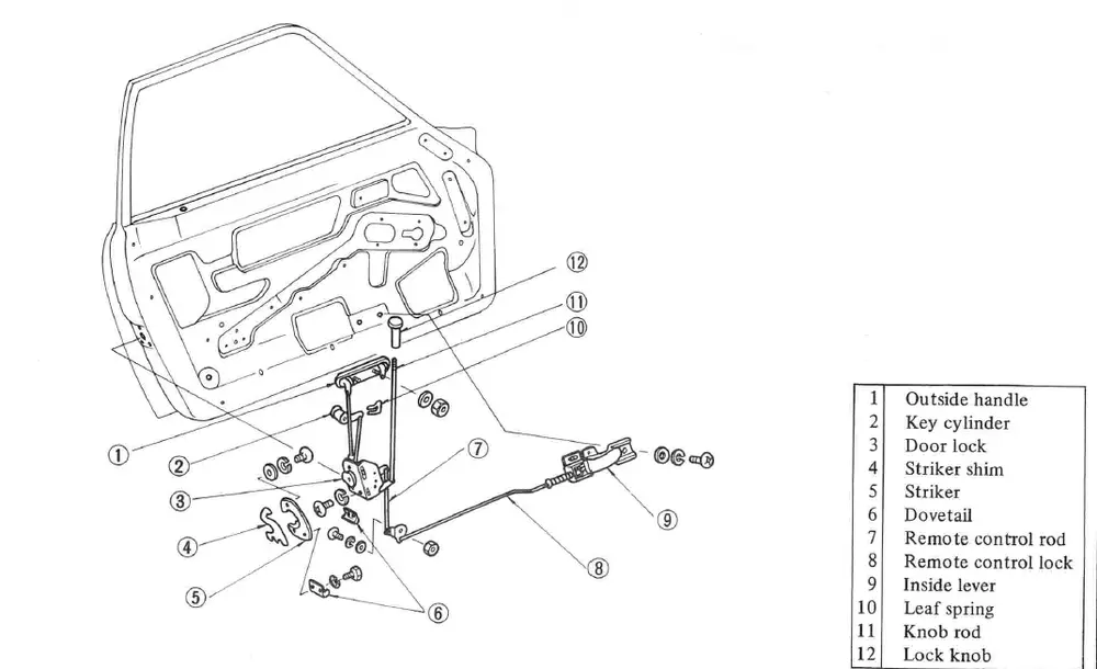

Posted April 17Apr 17 comment_675729 I purchased a 240z that had the knob rod and key cylinders deleted. I thought I could put in an actuator to trigger the “lock”, but I think I’m missing something or maybe the key cylinders is a required part of the lock working?To be clear, there’s no vertical knob rod ie no #11, #2 per the diagram. When I reach inside the door to wiggle what I think the knob rod is connected to, it just moves up and down a little bit and as far as I can tell, there’s no way to lock the door that way either.Any help would be appreciated! Please let me know if I can provide more information.Thank you! Link to comment https://www.classiczcars.com/forums/topic/69340-can-door-locks-work-without-the-knob-rodkey-cylinders/ Share on other sites More sharing options...

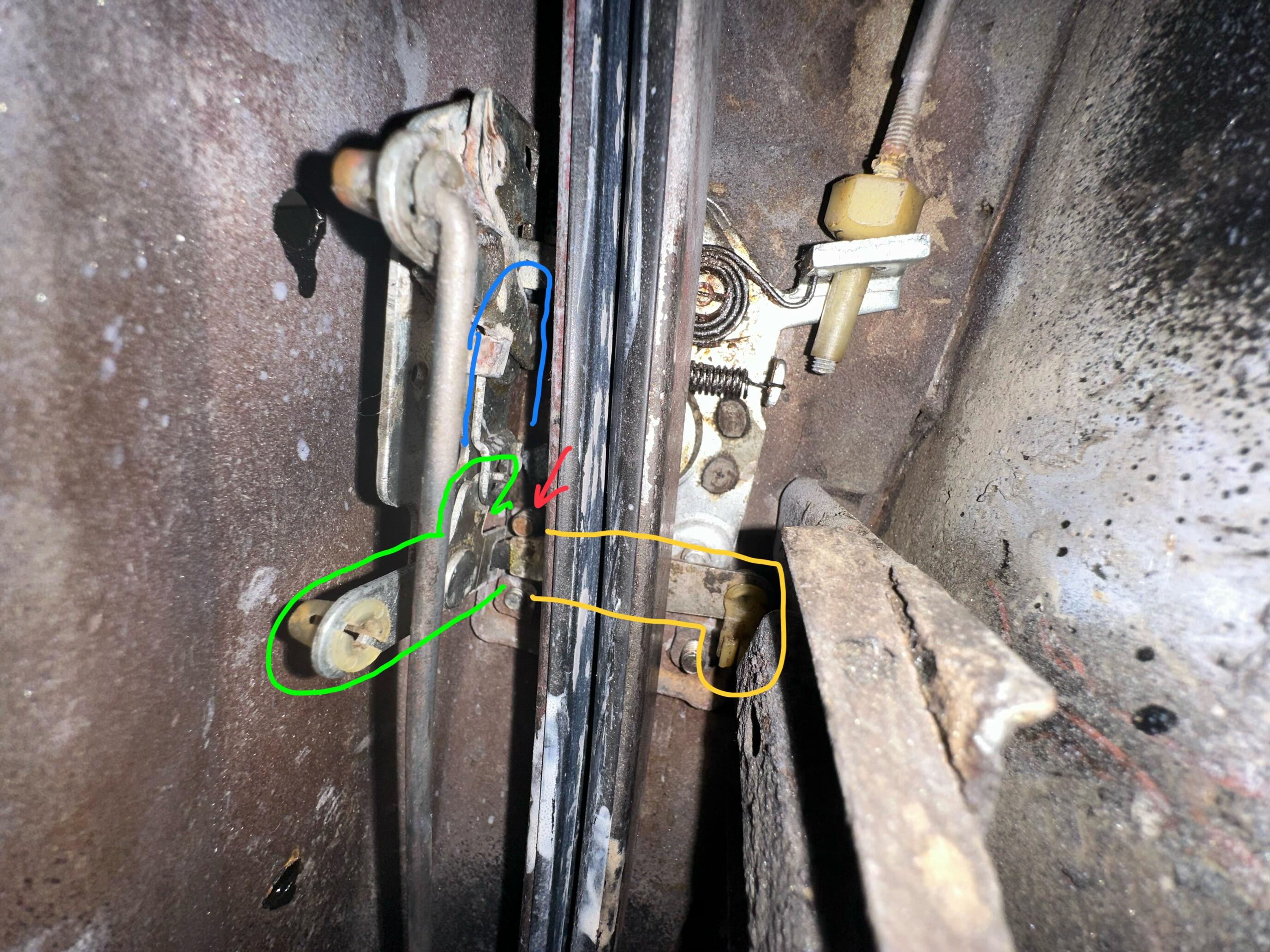

April 17Apr 17 Author comment_675739 So before I go and dismantle the window/door etc, I have a question about how this is supposed to work.As it sits now, the door latches and opens fine.You can see the red arrow pointing at the mounting screw. This looks like it prevents the knob rod (green) and the keyhole tab (yellow) from moving downward.Is this expected?If the knob rod (green) was working as intended, would the blue part move as well?With the green/yellow parts in that position, are they in a door locked or door unlocked position? May be an obvious answer, but I thought I would ask to be 100% sure.I’m wondering if the previous owner did something crazy like weld it to keep it “unlocked” forever.Thanks in advance! Link to comment https://www.classiczcars.com/forums/topic/69340-can-door-locks-work-without-the-knob-rodkey-cylinders/#findComment-675739 Share on other sites More sharing options...

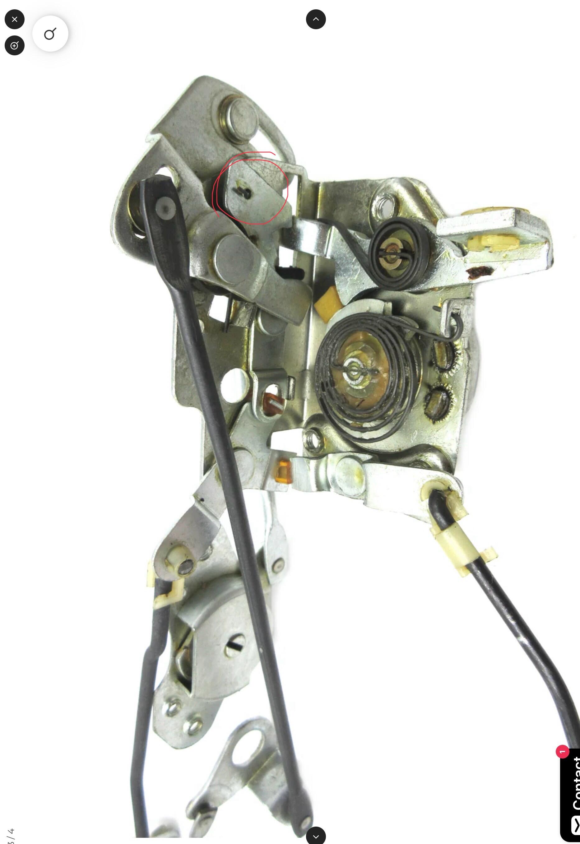

April 18Apr 18 Author comment_675740 sigh, i think i know what’s going on.the previous owner put a rivet on the lever here so it wouldn’t move.when it should look like this instead: Edited April 18Apr 18 by brobromelon Link to comment https://www.classiczcars.com/forums/topic/69340-can-door-locks-work-without-the-knob-rodkey-cylinders/#findComment-675740 Share on other sites More sharing options...
