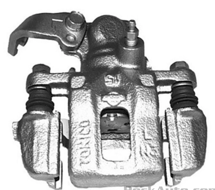

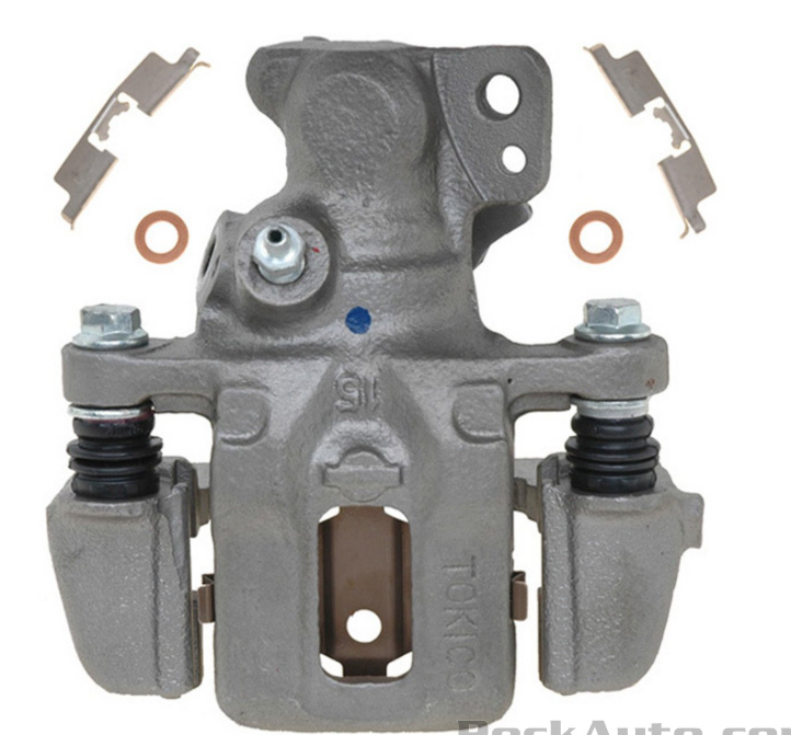

Does anyone know if the 240SX and Maxima rear brake caliper used for rear disc conversion have the same bolt patterns and offsets?
I had one of my Maxima rear calipers torn down in the shop. My dehumidifier went out during that time and it's got a good bit of rust in the bore. The Maxima calipers are not available anywhere. So was wondering if the 240SX caliper was a direct replacement?
I have the 240sx calipers with the the ZCD adapter plates. You can email Matt and he can tell you if the brackets are the same. At one time they sold both conversion kits.

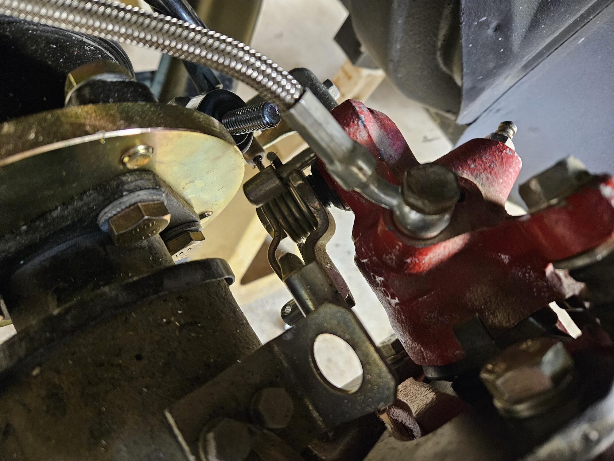

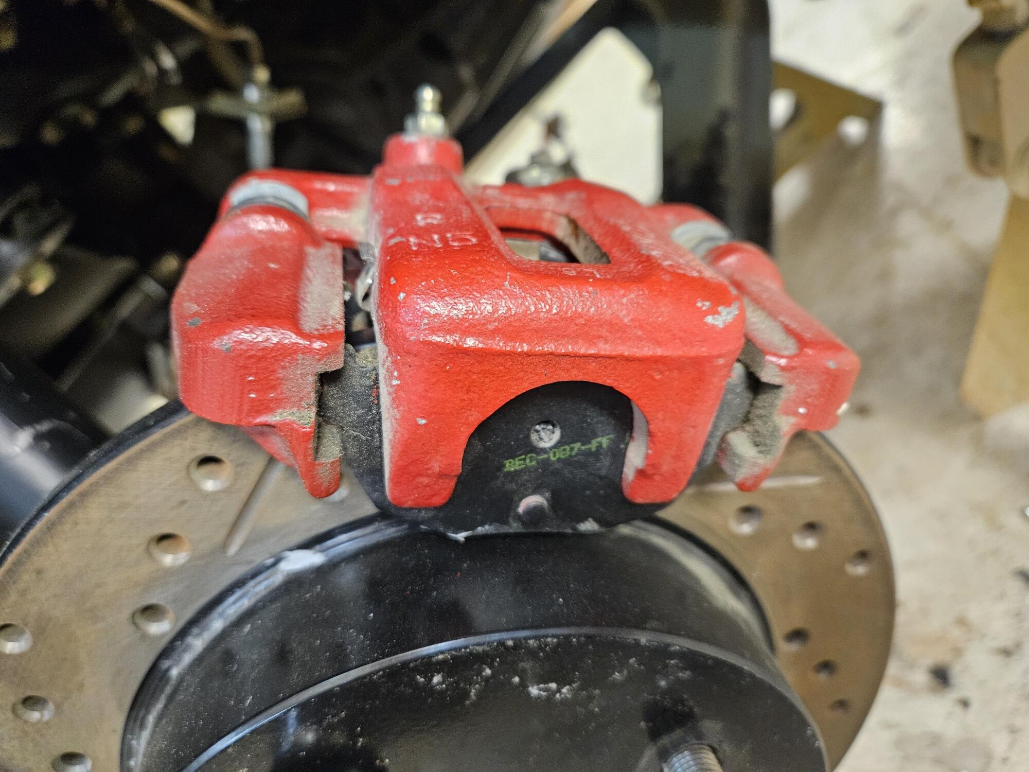

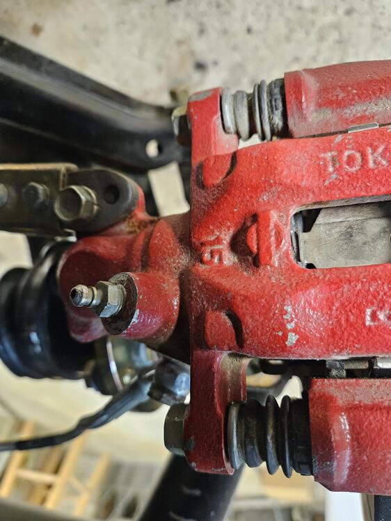

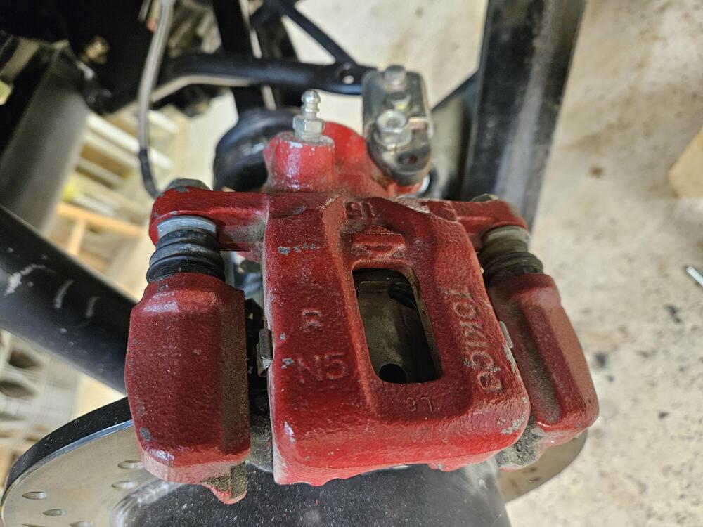

Post a photo of the caliper showing the mounting bracket.
