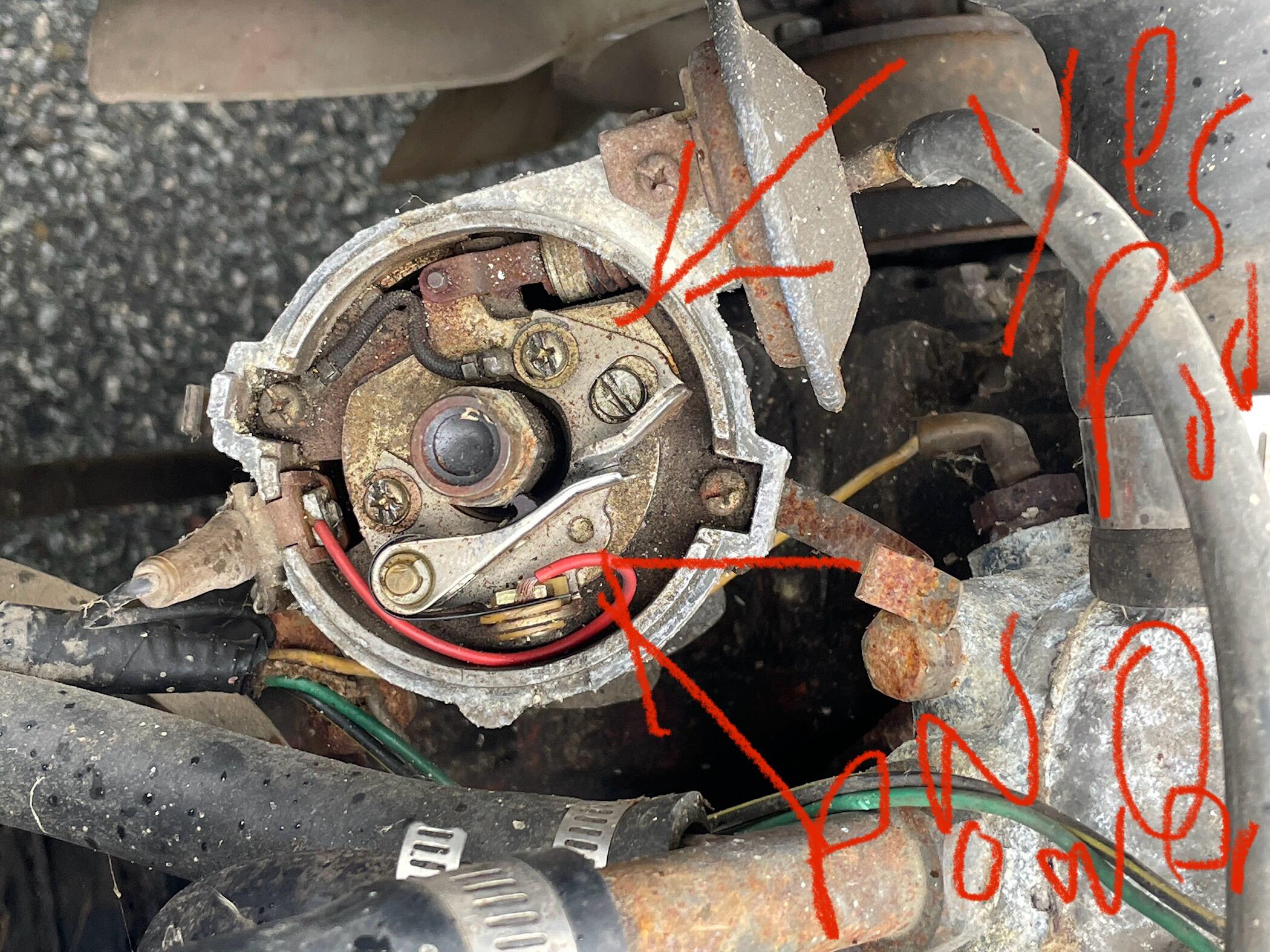

4.  While my test light was attached to pos battery.  I got light when connected to neg side of points. Points would open and close and got no power on other side of points - is that correct?

As for test #4, This part "While my test light was attached to pos battery.  I got light when connected to neg side of points." makes sense to me, and is the desired result. But you kinda lost mo after that. I mean, I know what you mean that the points opened and closed (I assume yo (u were cranking the motor over with the starter), but I don't know what you mean by this part "got no power on other side of points". Where did you have the test light connected, and what did the light do?

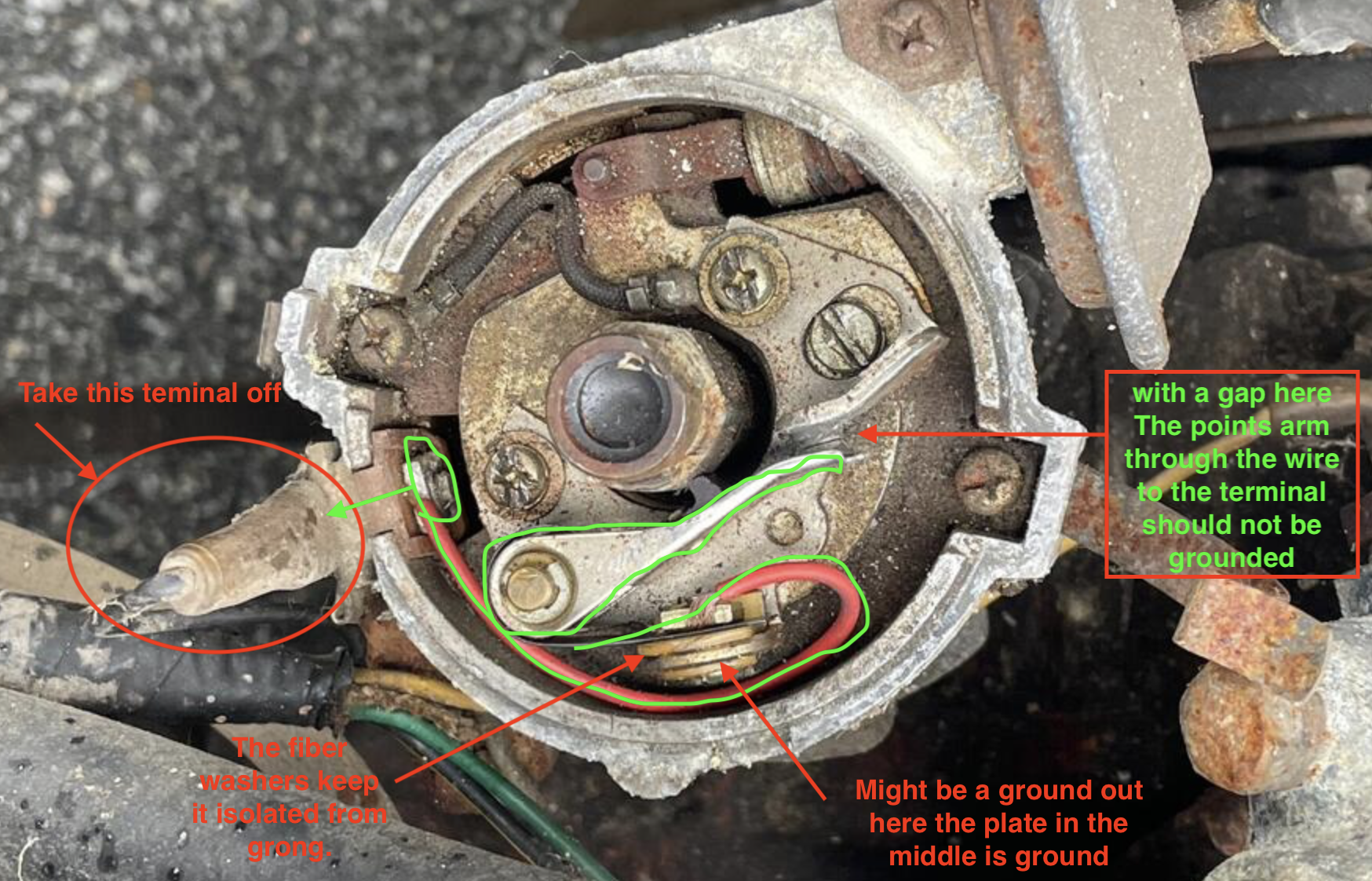

I don't like the look of the red wire attached to the points the metal part there is grounded, the there is a sandwich of fiber washers and the wire should not touch the middle plate. When the points are open there should be no ground contact through the moving part of the points to the terminal through the red wire to where the black wire goes on the flat terminal.
I still also suggest using a plug wire like off Number 6 with an old plug in it directly from the coil wire hole (well seated). then rest the metal part of the plug against the head. The spark should jump the plug gap when working correctly.

Ok.  I will try to explain this again it’s always confusing.  In my photo. Top of points where I says yes. My test light when hooked to pos battery lit up when touching top part of points.  But fit not light up when touching the other side of the points. When either opened or closed.  So what I’m saying is one side was. Grounded and one side was not. When either opened or closed.  And as for the testing I was under the impression if I just took the lead wire out of the coil. The word that goes from coil to dizzy and unplugged it from dizzy and held the metal tip. The part that would plug into dizzy. And held it again engine i would see a spark from that. I was never using a spark plug with wire from dizzy. Only way I was looking for spark from dizzy was with a spark plug tester pluged into a plug in engine.

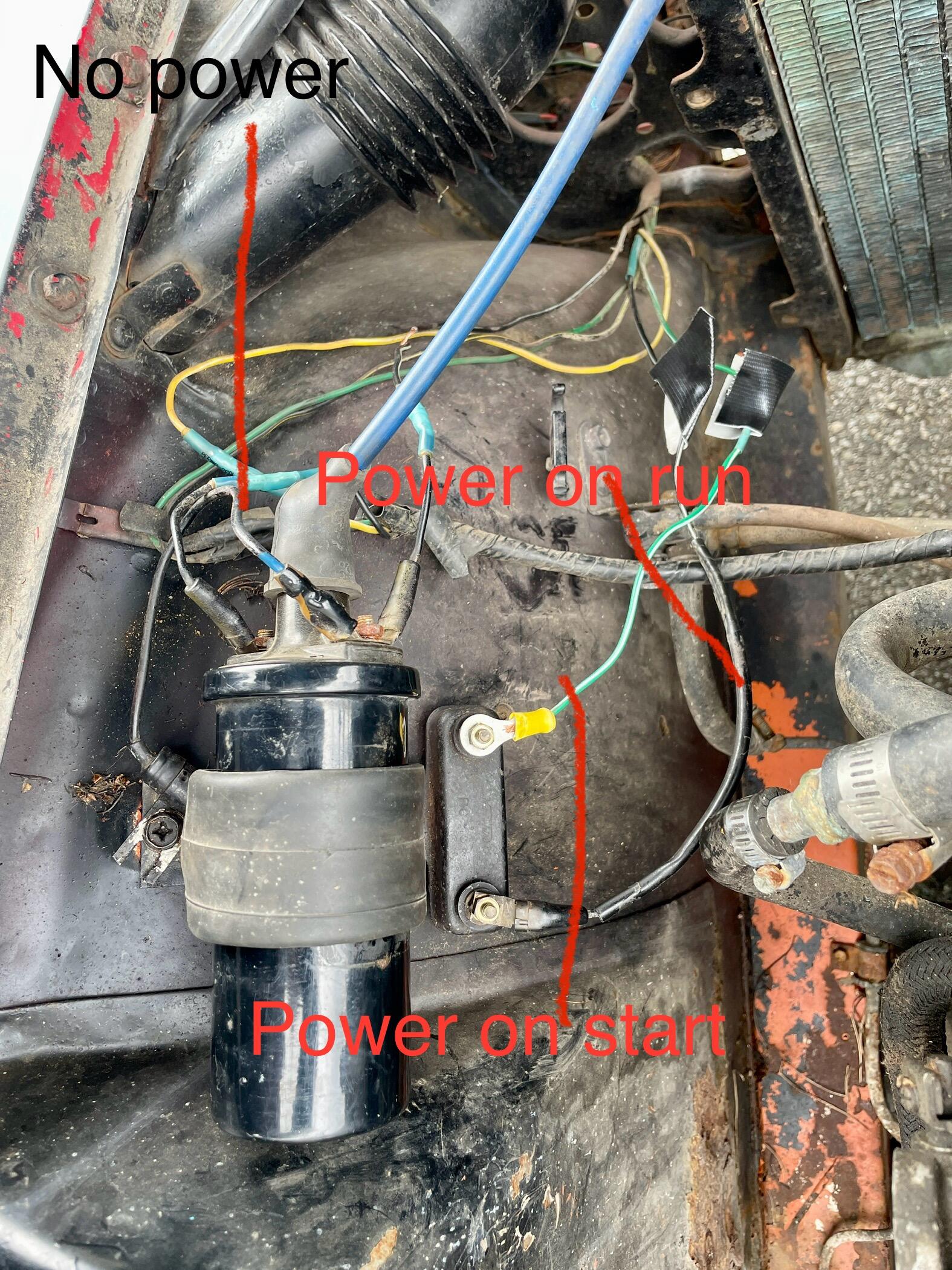

Ohhh. And here is what wires to coil and resister do.  Green white hot on start. Black wt yo resister not on run.  Black white to coil pos no power.  I went over that 10 times and that’s how it should be. Am I missing something. ??
I still think the red wire is grounding. I can't tell what you are pointing at for the NO test. The "top part" is the points base and should be ground. The spring part that moves is ground when points are closed and not ground when points are open. This occurs when the dizzy spins the bumps on the rotor to open and close the points. It has to be in the right spot to test that.

No that is still not correct you should have power on + side of the coil if you have power at the resistor. What is your Ohm reading if you hook up the meter to the g/w wire and the b/w wire at the + on the coil with the wires disconnected from everything?

I also think I know what might be going on here when we originally got the car, the green and black white were snipped there’s a wire going directly from the ballast resistor to the coil that may have been the only hot wire and way to start the car  can someone please tell me what the power should be at the coil positive when the car is in the start position? Here is a photo of the way it was wired when we got the car.
