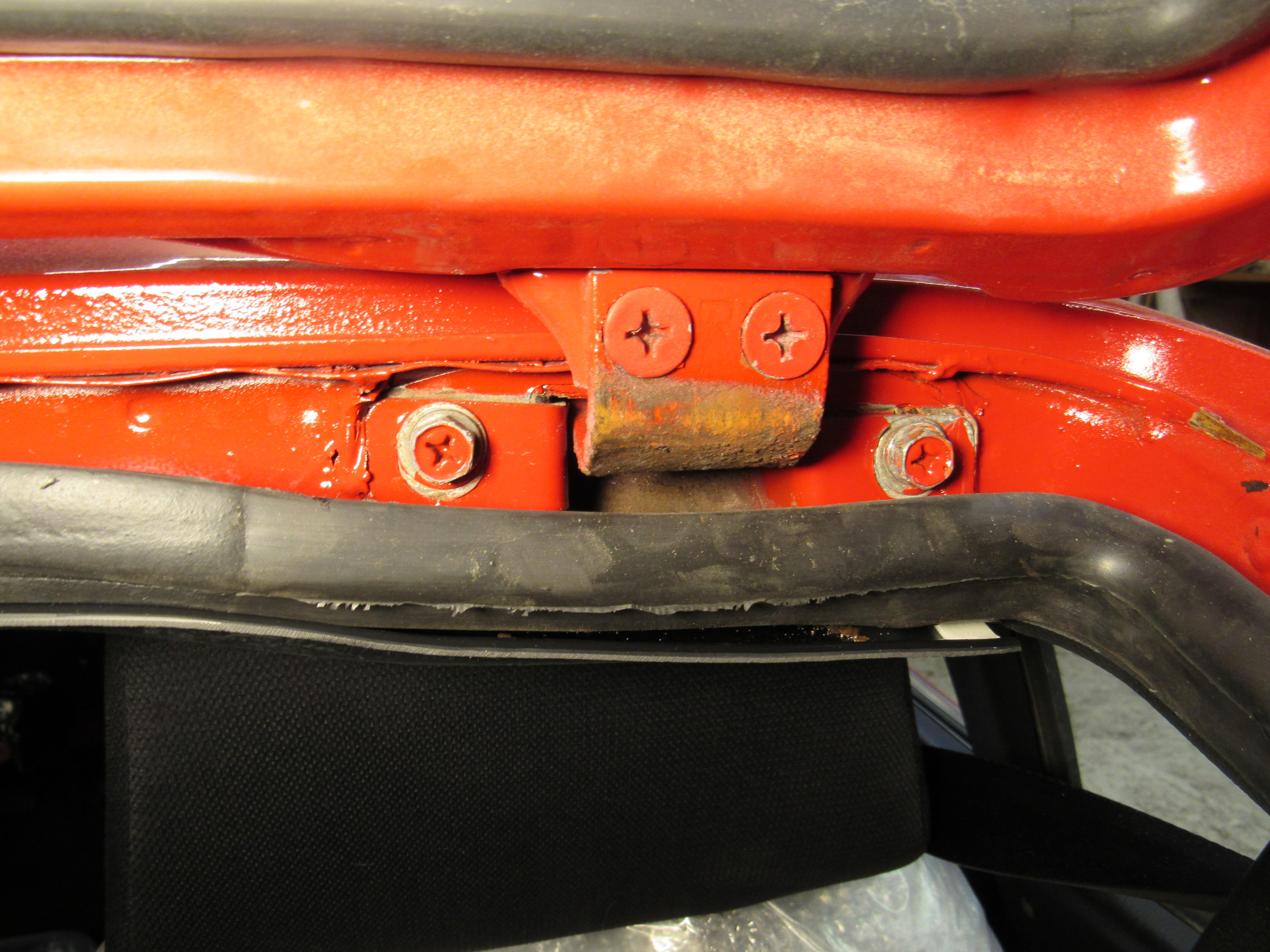

Does anyone know where the fresh-air opening is for a 78?  @grannyknot The rear hatch plugs have an unbroken piece of duct tape over them as a seal.
I'm talking about the rubber boot that surrounds the hinges.

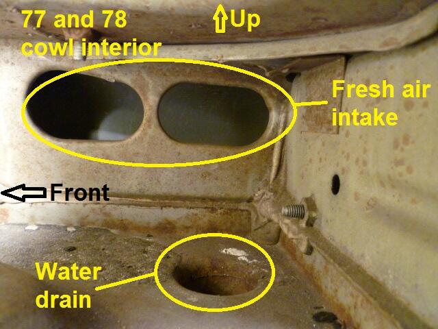

The fresh air openings for the 77 and 78 bodies is under the cowl area. Previous years they piped air through the frame rails behind the headlights, but with the extensive metal redesign in 77 they moved the intake holes to under the cowl panel.
Couple years ago I had my cowl panel off to work on my windshield wiper assemblies, and while it was off, I stuck my camera down there and took a couple pics.
This should explain things:
