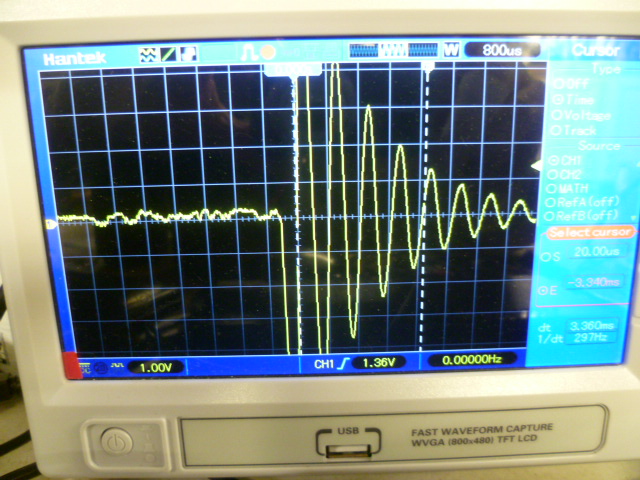

Oh, and just to be ridiculous... Here's how I measure capacitance.
Put the cap in parallel with a known inductance, hit it with an impulse function, and then simply measure the harmonic response:
Little bit of algebra, and you got it!  :ph34r:

You're making my head hurt. I have enough trouble doing the math to determine resistance in parallel  😁
