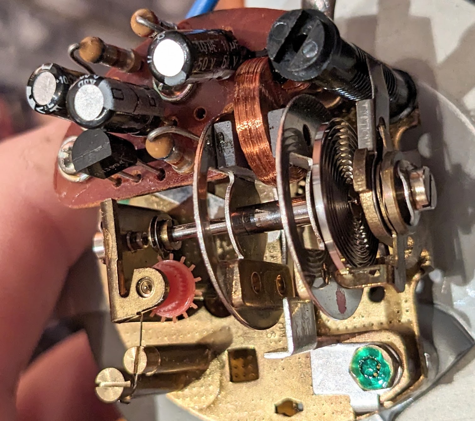

Hussein,
 After you replace the transistor did the clock start on it's own when power was applied? How long did you let it run before you assembled back in the housing?
My thought is that if it was running and then stopped when you reassembled the wiring (ground and power wires) might have touched the mechanism and caused a problem.

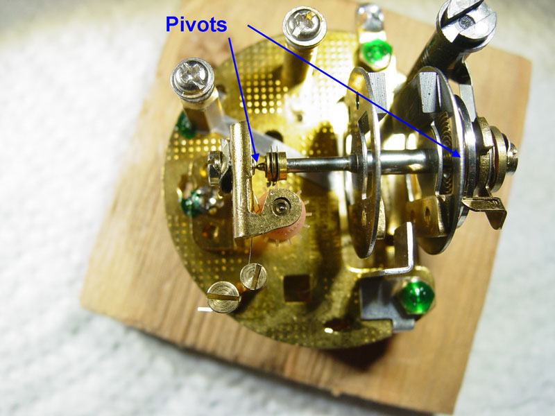

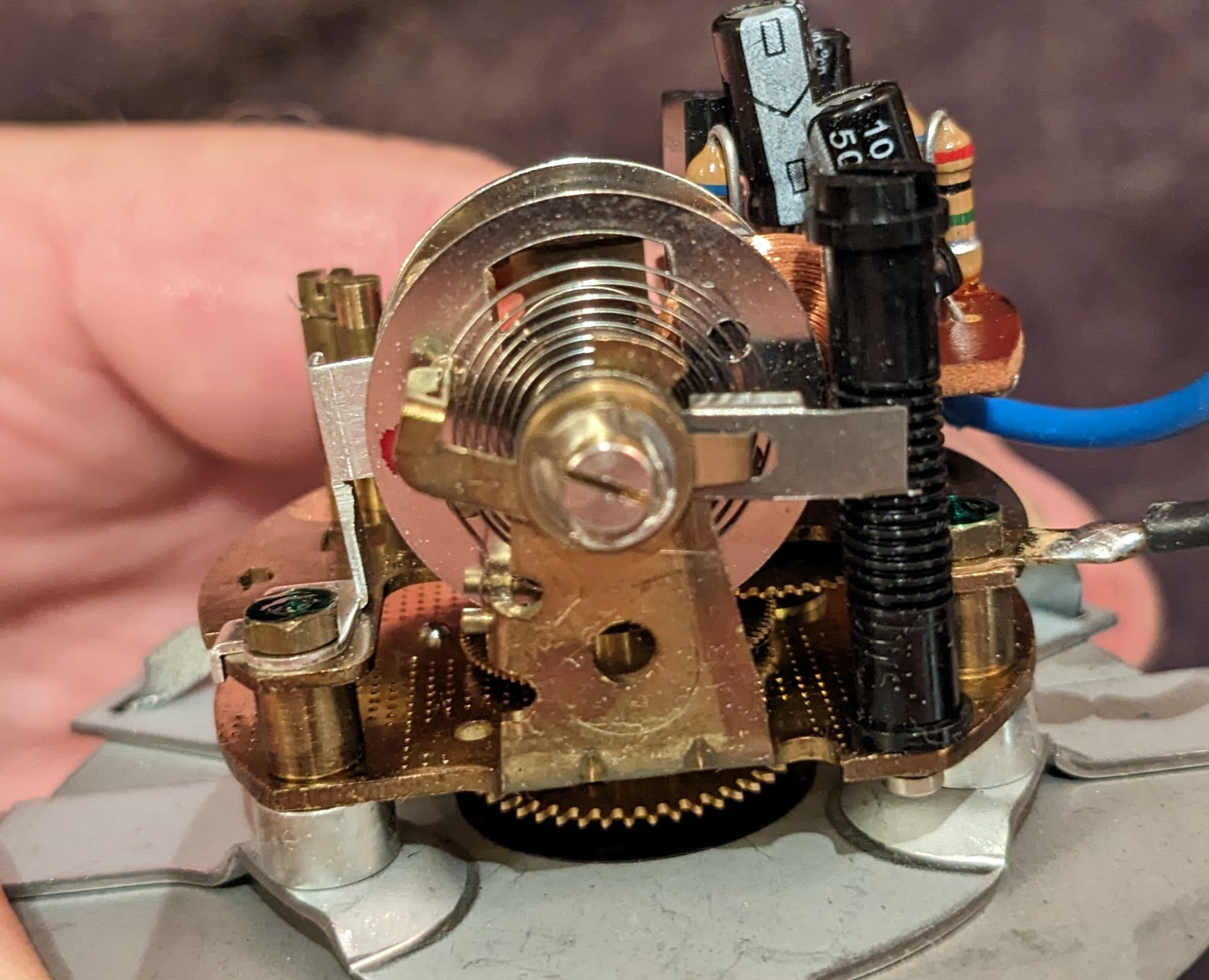

You could have a lot of resistance in the spring and or the pivots of the balance wheel.

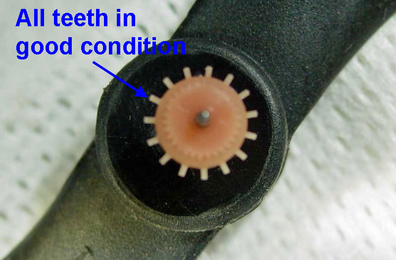

Check the spring shape, teeth condition of the pink wheel, and the pivots. If the bearing are worn to excess the wheel will not run smoothly. If you push the wheel it should take several seconds for it to stop.

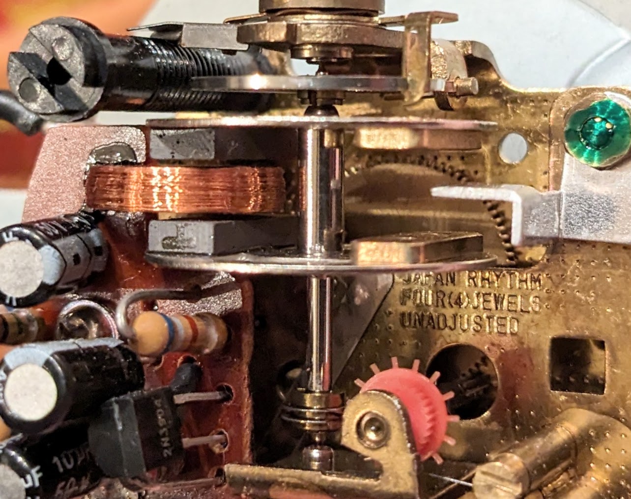

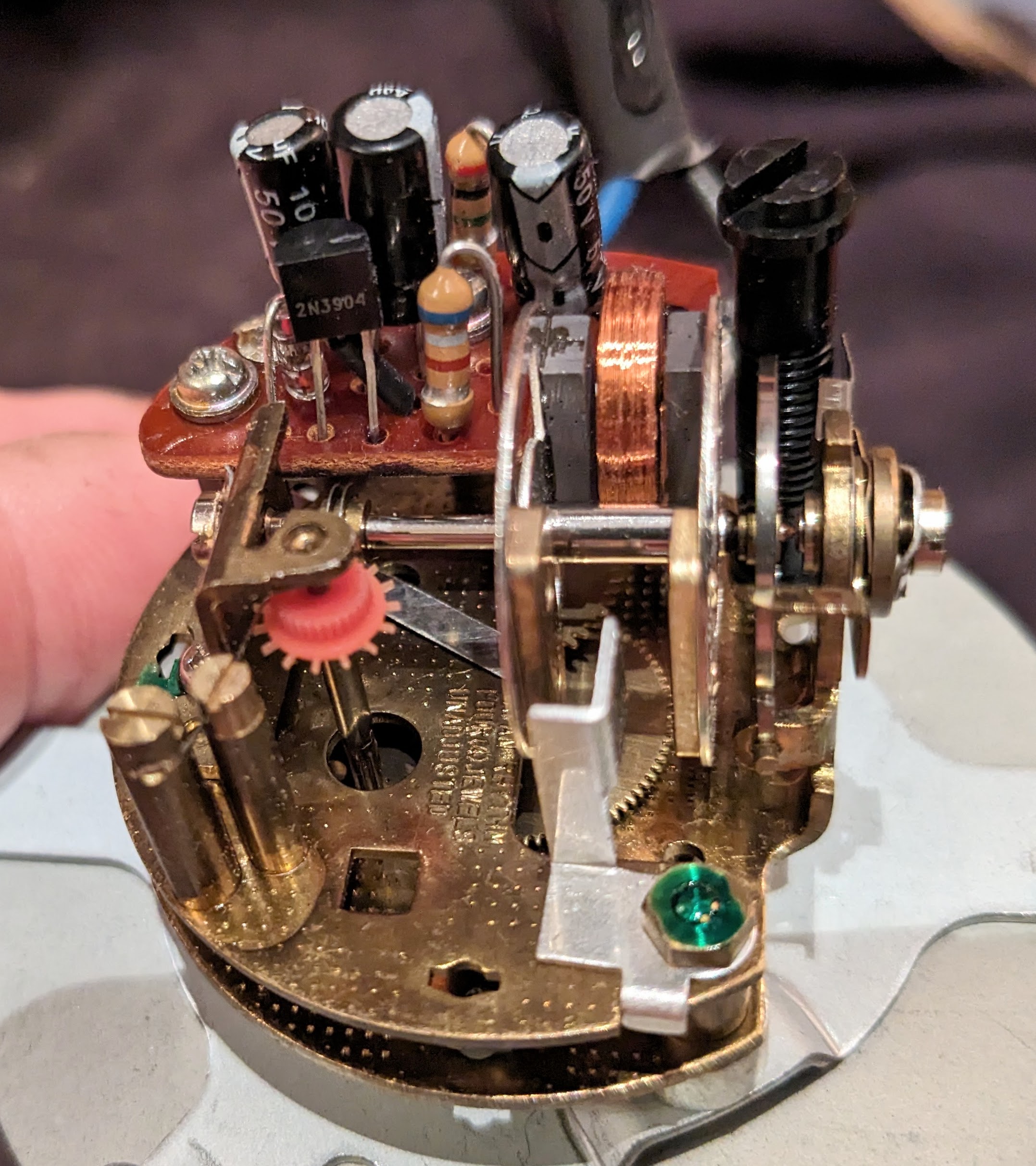

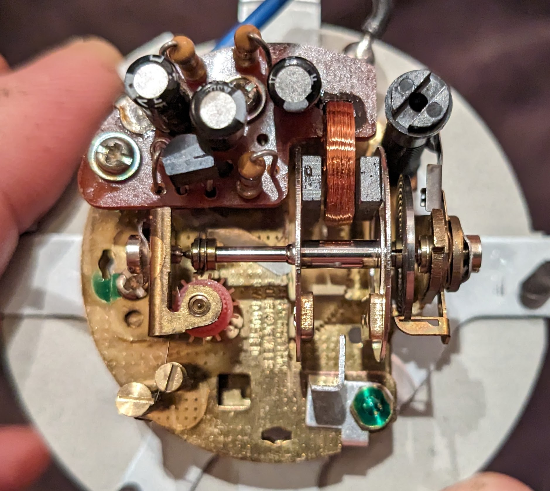

Please post another picture of the circuit board mounted in the assembly.
Ron

Hello Ron
Thank you for chiming in
I think I had to jump start it when I did the transistor. The wheel moved when power was applied (which it did not after just the cap replacements), but it did not cycle/swing of its own accord. I ran it for a few days out of the housing.
I checked that the shaft/spindle was able to move freely without binding or excessive end play - I had thought perhaps the shaft might have been restrained by the end adjuster, because I had to recenter the shaft when I first took it apart & didn't pay attention to keeping my fingers away from the shaft.
When I assembled it in the housing I was very careful to gradually feed/pull the two wires out through the casing as I placed the clock in the housing.
There is no signs of wear or degradation to the spring, balance wheel, gears or shaft / shaft tips or pivot caps. If I spin the wheel manually, it cycles for a few seconds.
I will take another pic of the clock with the circuit board in place. I was careful to center the coils in-between the wheels.
I did not re-use the mis-wired transistor
Edited by HusseinHolland
Have you used  your car battery to power your clock. I really don't like using the 9 volt battery as they degrade very quickly. You might power the clock from a car battery and see if thing change.

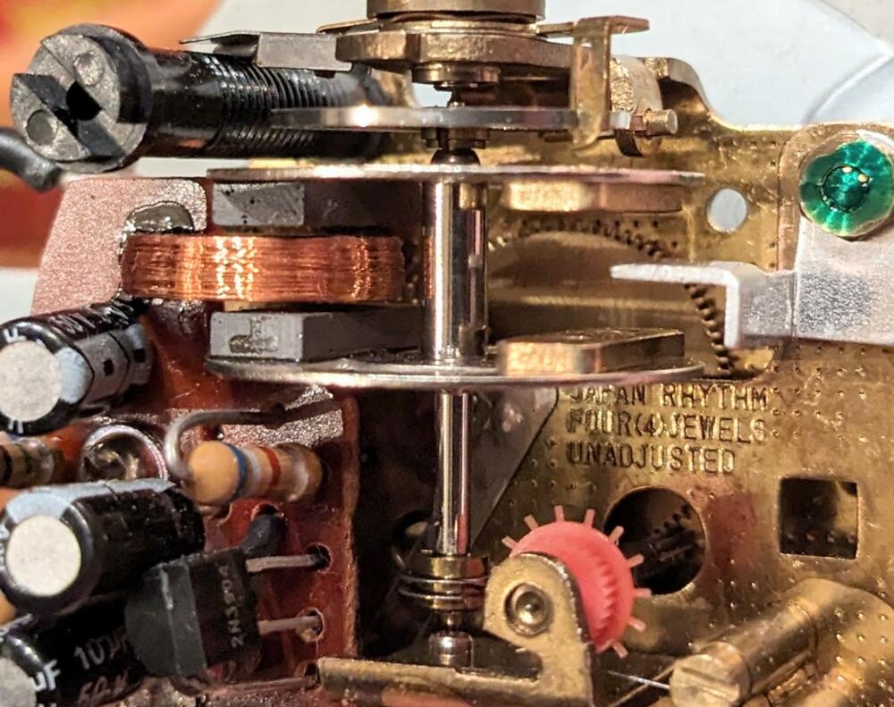

Everything looks good. It acts as if the transistor is not working correctly. When power is applied the transistor is turned on quickly activating the coil which pushes the wheel and everything starts moving.
It might be that a cap that was replaced is not the correct value. It might say 10uF , but in reality it could be wrong. I have a cap meter and measure everything I replace because of the poor quality caps on the market. As the Captain suggested you might check the value of the 2Meg resistor.
I did some checking on the coil values you have, 490 and 153 ohms, and that is right in line with several circuit boards I have so I don't think that 's the problem.
 Ron
