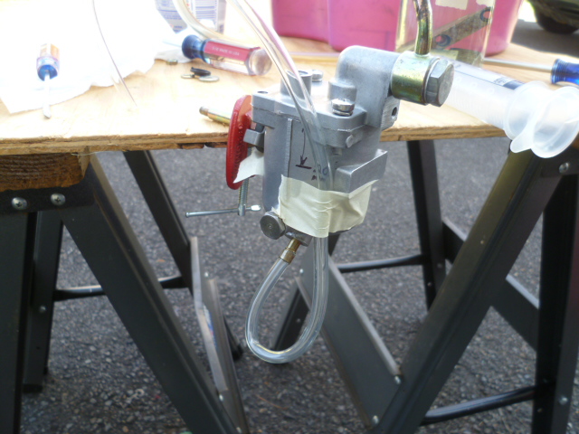

You mean like this? LOL

Here's a couple related pics that might help Separated from the rest of the carb, but here's a 240 bowl:

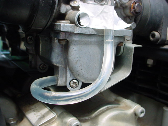

And here's a different carb, but the concept is the same:
