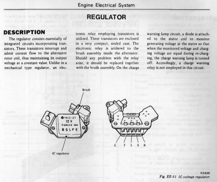

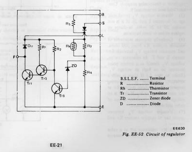

June 21, 20232 yr comment_654407 Also, never really noticed it before, but Nissan put a nice description of the regulator in the FSM. They even supplied a circuit schematic. It's not my field but still pretty cool to ponder.  Link to comment https://www.classiczcars.com/forums/topic/68393-alternator-overcharging/?&page=2#findComment-654407 Share on other sites More sharing options...

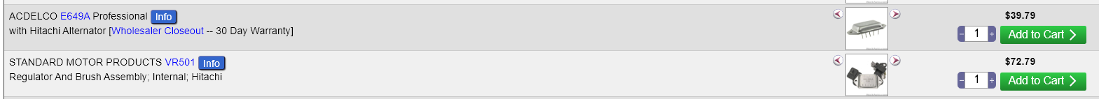

June 21, 20232 yr comment_654408 Here's a clue about the quality of the typical reman alternator. Some of the repair parts cost more than a whole reman. https://www.rockauto.com/en/moreinfo.php?pk=45765&cc=1209260&pt=4884&jsn=394 Link to comment https://www.classiczcars.com/forums/topic/68393-alternator-overcharging/?&page=2#findComment-654408 Share on other sites More sharing options...
