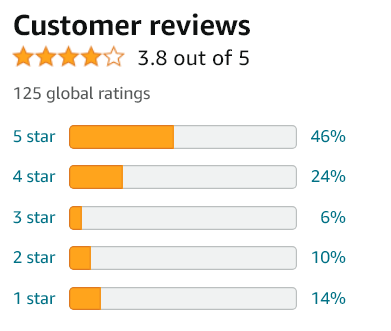

I'm just saying, Ford parts probably don't get these kinds of reviews.  Amazon is full of cheap parts.  I have a set of headphones that broke after a year and Amazon just "disappeared" them and the company that sold them from their web site.

All of the ratings are shown.  If you pick 4 and 5 as "good" and 3 or lower as "bad", you get a 70% good rate.  Who wants that?  Ford has produced millions of them.

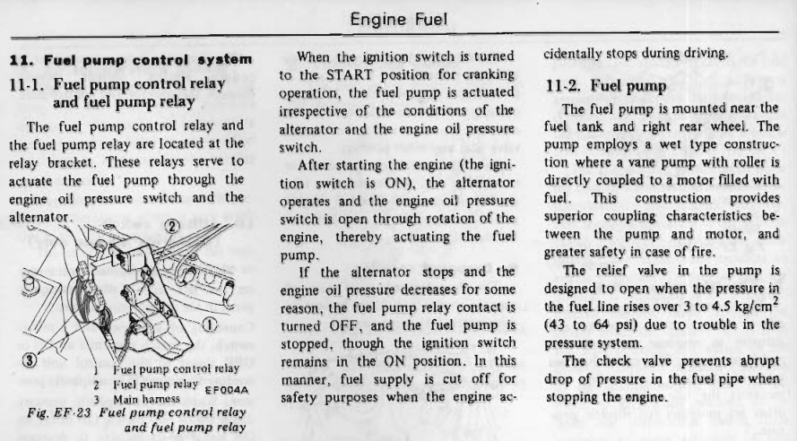

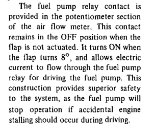

On 5/22/2023 at 5:35 PM, Zed Head said:
Your 77 should already have one in the AFM.  When air flow stops the fuel pump power is cut off.  Your fuel pump should not be running when you turn the key on.  Only at Start and when the engine is running.

I think the fuel shut off in the 77 was actually an orientation thing. If the car was upside down, the fuel was shut off. Porsche’s burn down a lot more often I think. Particularly carburetor models.
personally, I don’t think the 280Z system is that vulnerable to fire as in a perfect world, which you should maintain, it’s a closed system with no fuel exposure. You’re more likely to have an electrical fire.
