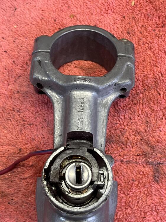

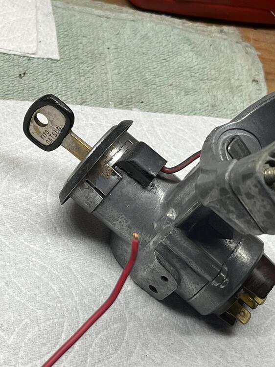

I was cleaning up this ignition switch and one of the two wires broke off from the switch body. I attempted to pry loose the black plastic cover where the wire connects to the main body of the switch, but it just felt like if I kept "persuading" it that I was going to break the cover.
Does anyone have a suggestion as to how I might get this wire reattached?
It's just for the "key in" buzzer. I'm not sure what all you would have to disassemble to get to where it goes.

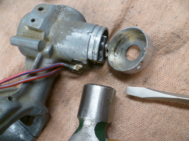

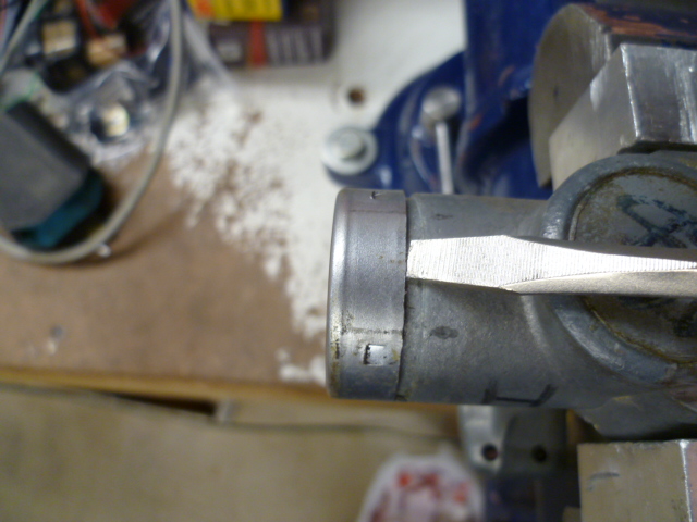

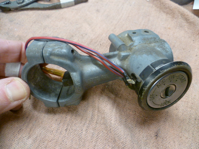

The later versions of that "key in the ignition" switch that I've messed with don't have that plastic shroud over the connections. Not sure if they changed the design over the years, or if the ones I've messed with had the cover removed by a PO at some point. In any event, these pics should help.
Start with this:
Remove this. Should pull off by hand:
Then remove this. Should come off with some light taps:
Where to go after that should be obvious:

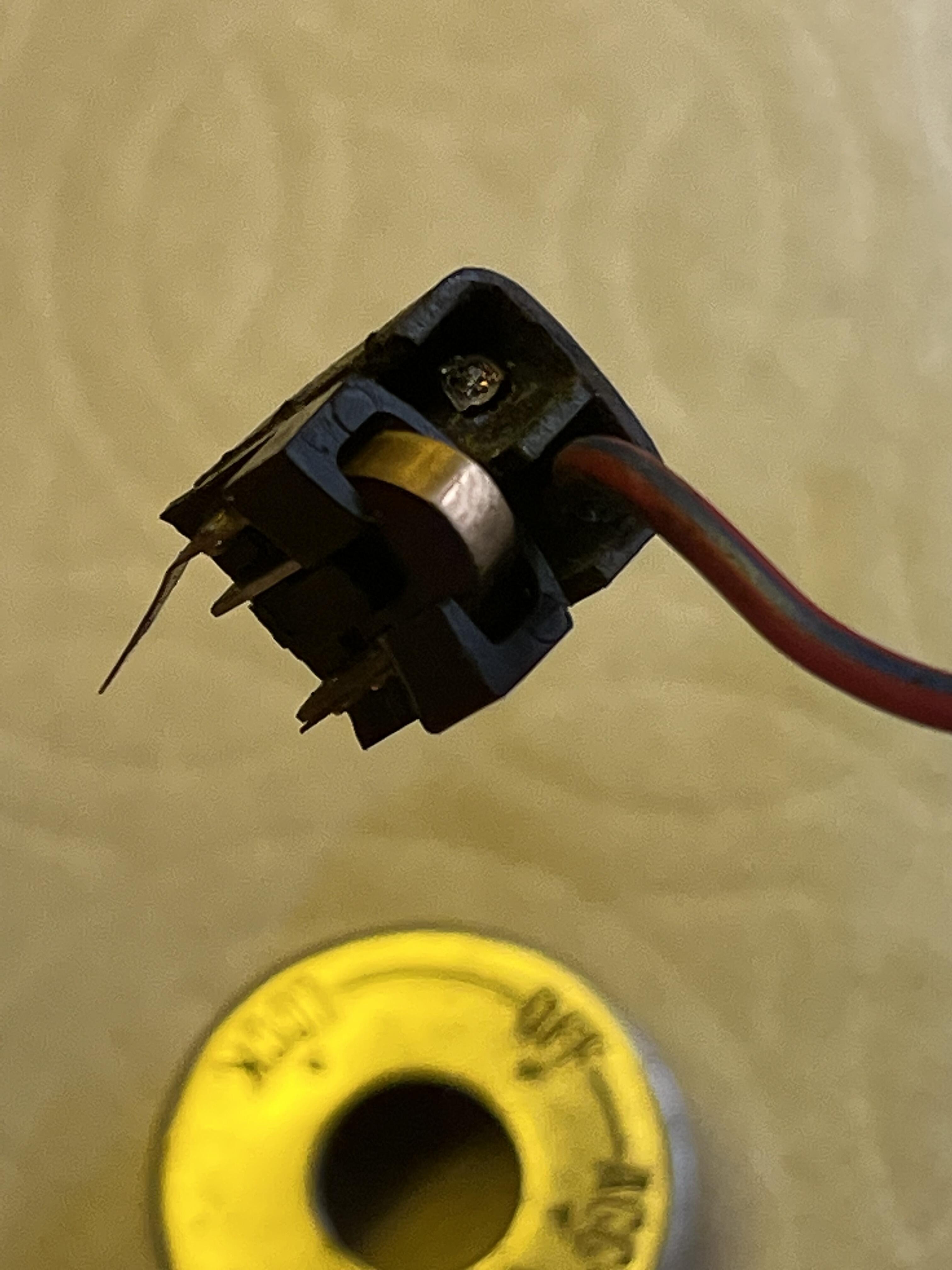

Today I was able to remove the black plastic cover that houses the two wires. Unfortunately, I was not able to loosen the wire connector and remove the wire strands still crimped inside it. I tried using a pick tool and a 1/16 drill bit with no success. The wire connector is housed pretty deep inside the plastic cover and there just isn't much room to work in there. I think that it's probably doable with the right tools and patience, but I just didn't have the right tools and my patience ran out after about an hour of fiddling around with it.
Well you could always just cut (break) the plastic cover off the switch. At some point in the evolution they decided that cover wasn't necessary anyway. And if you're still skittish about it, you could just wrap a couple rounds of tape around the whole switch body to recover it after you've reattached the wire?
