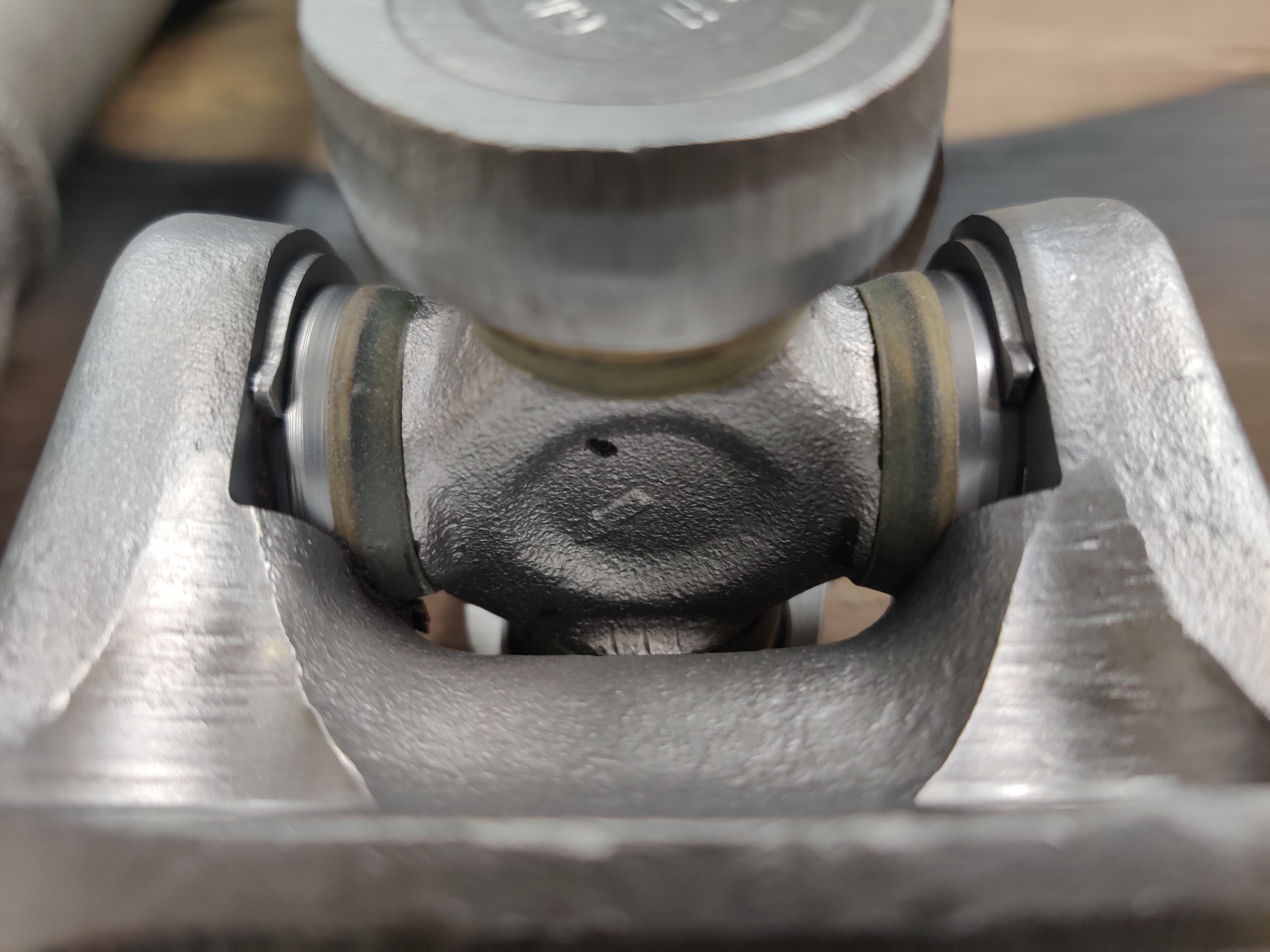

As I was glass bead blasting the axles from the car I am restoring, I noticed something I have never seen before, an arrow on the casting of the factory (I think) u-joint:
I note in the direction it is pointing, it seems to me that the area of the casting between the journals is flatter than the other, similar areas.  Is the arrow indicating that a grease fitting should be installed on that "corner"?

When i saw your first picture i thought there is the inlet for the grease.. but pic 2 told me it's not!  Maybe on the older ones there is the little screw were one can install the greasenipple to grease the thing.. and is yours a newer one that's greased for life and has no inlet for grease any longer.. the arrow is still in the casting but has no use..  just my 2 cents.. could be wrong..
I can see 3 of the 4 corners that could have the little ( brass?) screw were you can install the nipple but i guess on the 4th spot is also no little screw?

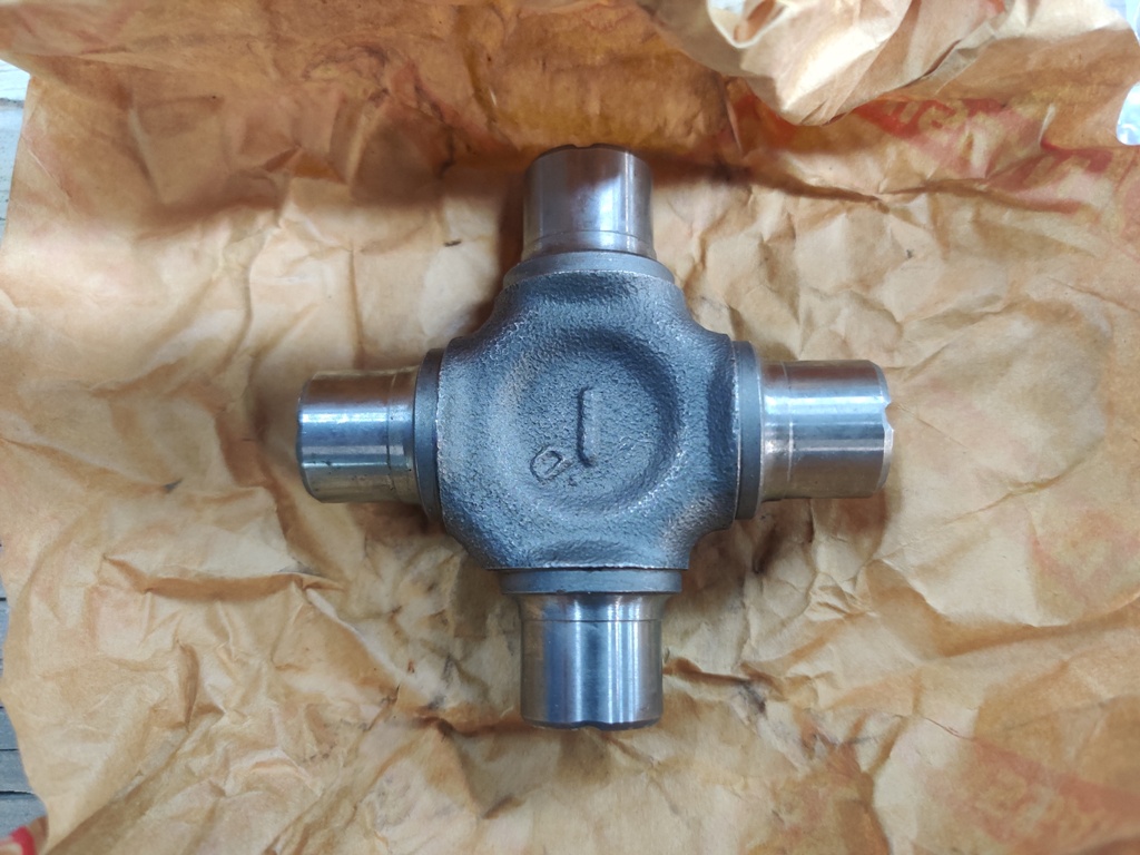

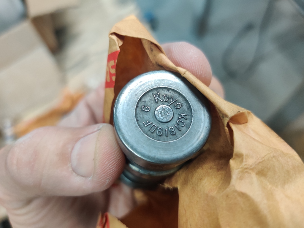

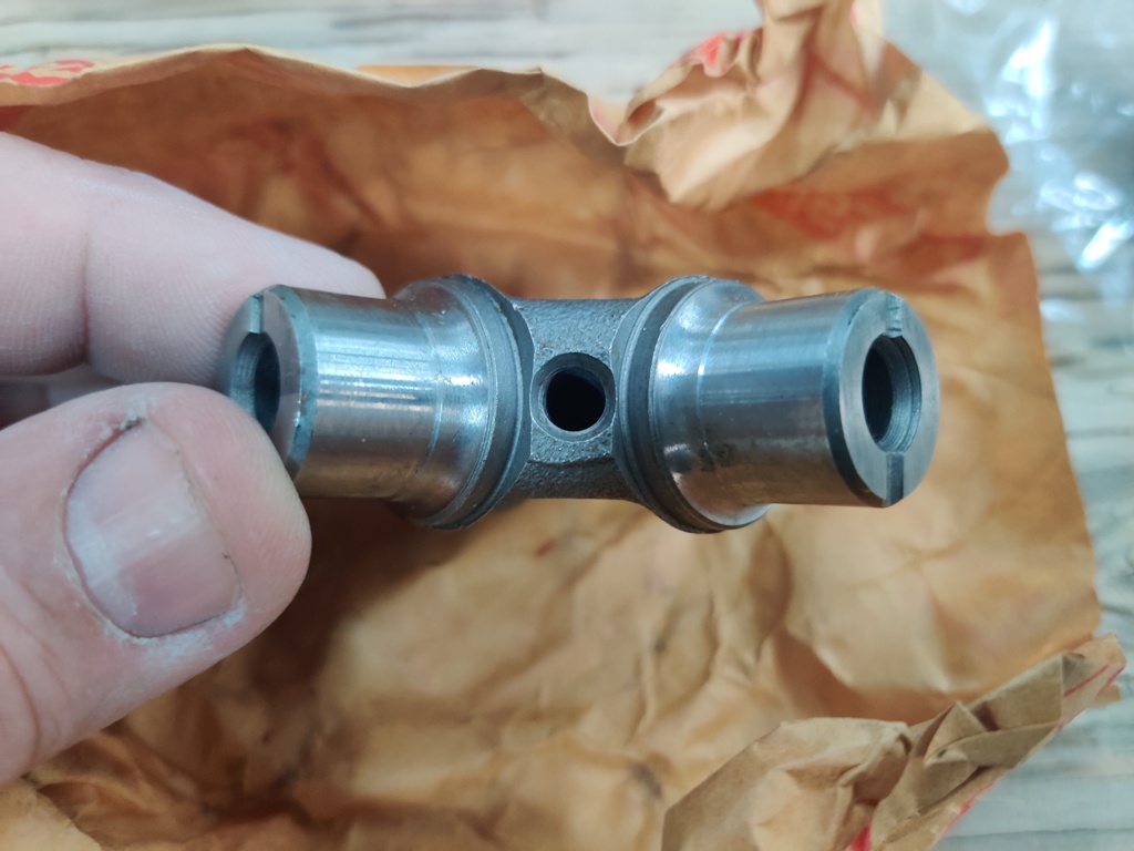

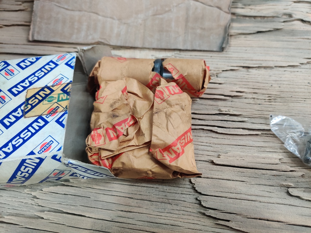

I located a couple of NOS driveshaft u-joints in my "boxes of stuff" tonight.  I was curious if they were drilled for grease fittings.  I found out that they are.  Interestingly, if you look at the corners and markings, you see they are similar to the ones on my shafts.  However, instead of an arrow, there is a D on the corner that has a flatter surface than the other corners:

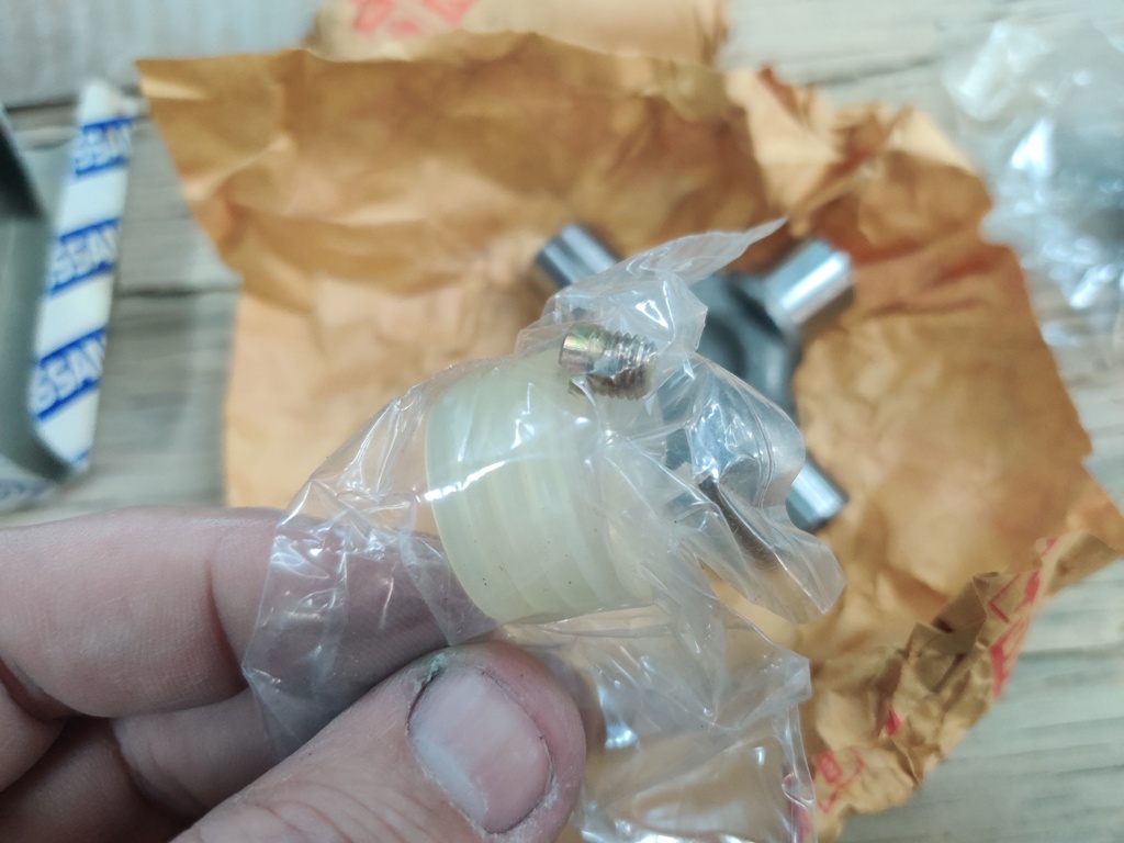

Additionally, the brand is Koyo for the two I have in boxes, and not grease fitting was included, but instead a plug was.
I still suspect that I could drill and then tap the existing u joints for a grease fitting.  I will need to decide how to proceed before I prime and paint the axles.  They were painted after assembly at the factory (paint over rubber boots and bands as well), and I am thinking about replicating that.

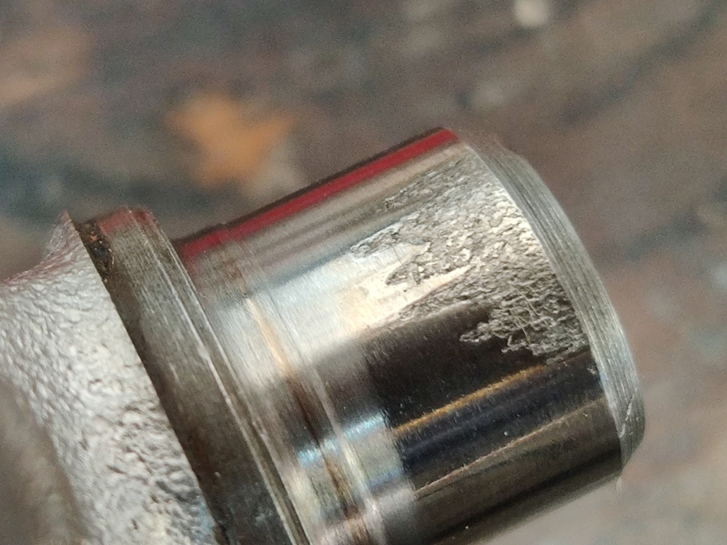

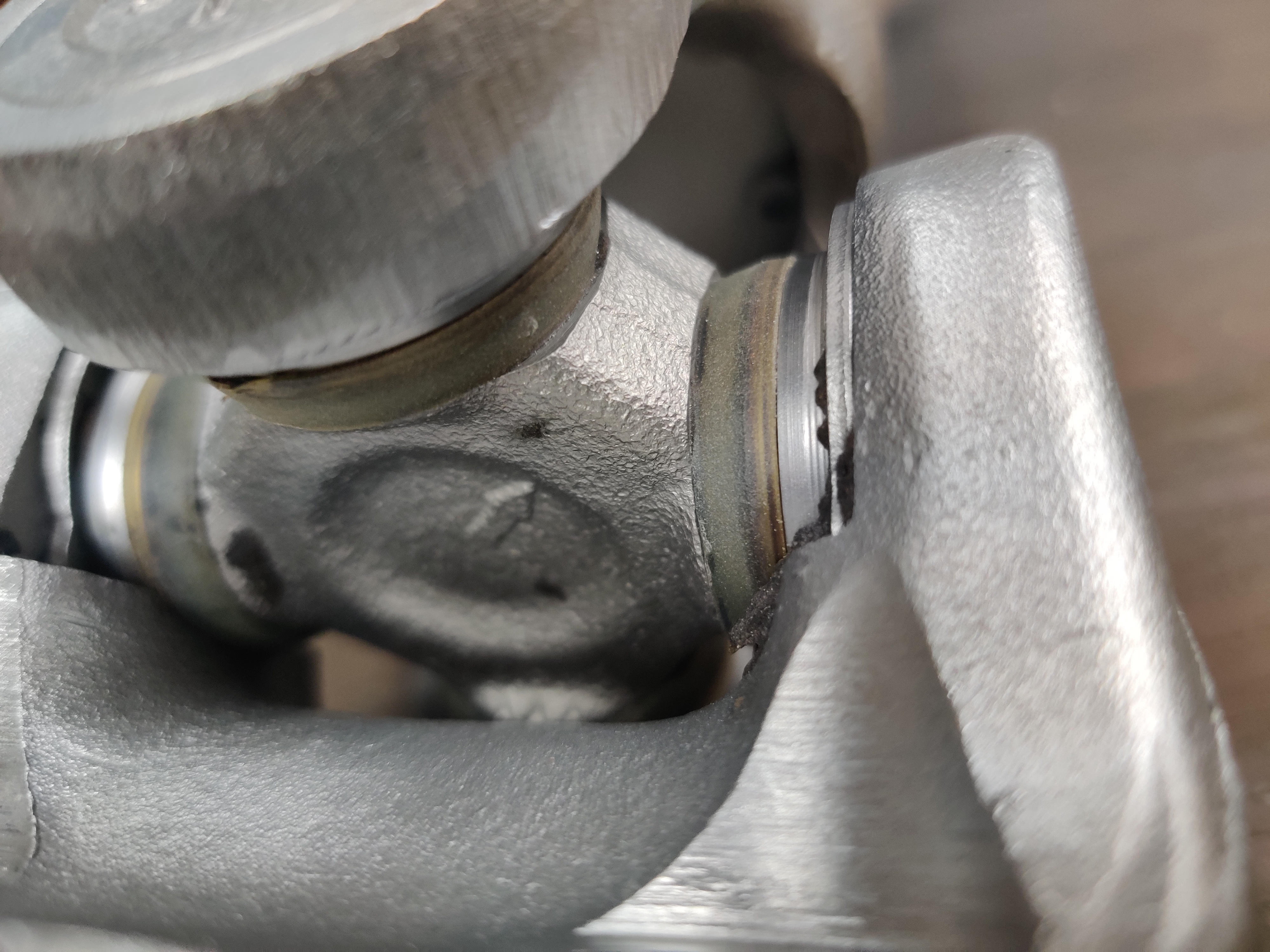

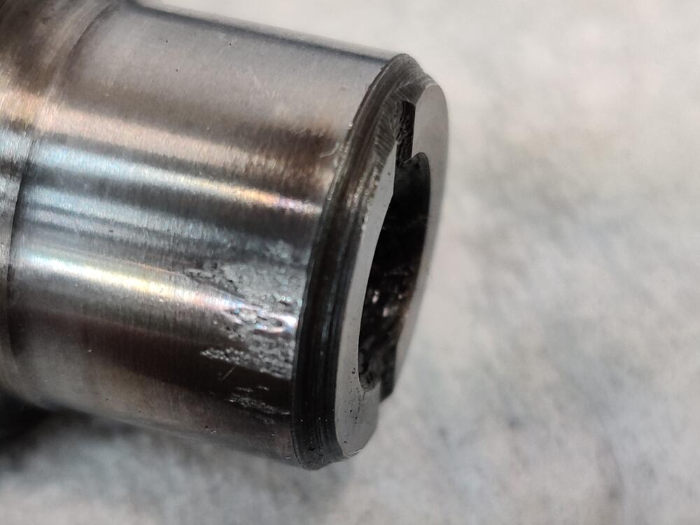

Well, I won't be attempting to drill them because I found a small amount of pitting on the surface of the journals when I took the u-joints out to inspect them.  Time to replace them.
Inner u-joint... and outer u-joint for one axle:
Yeah, that's done for. I'm no bearing expert, but I believe that's known as "spalling".
However, at this point, if it were me, I'd take the opportunity to check the body hardness and see if it was ever a possibility to drill and tap.
