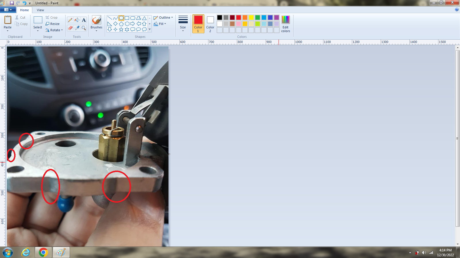

Thanks for all the great info. When I try to remove the cover on the float chamber the top gets stuck under a section of the main body. Is there a way to remove that cover with the float still attached?
Yes, they are made kind of shaped like a circle but idents on the sides where the bolts/screws hold them in place. If you lift up and turn them where the narrow part barely clears the carb body it'll raise up. Just barely but it will.
