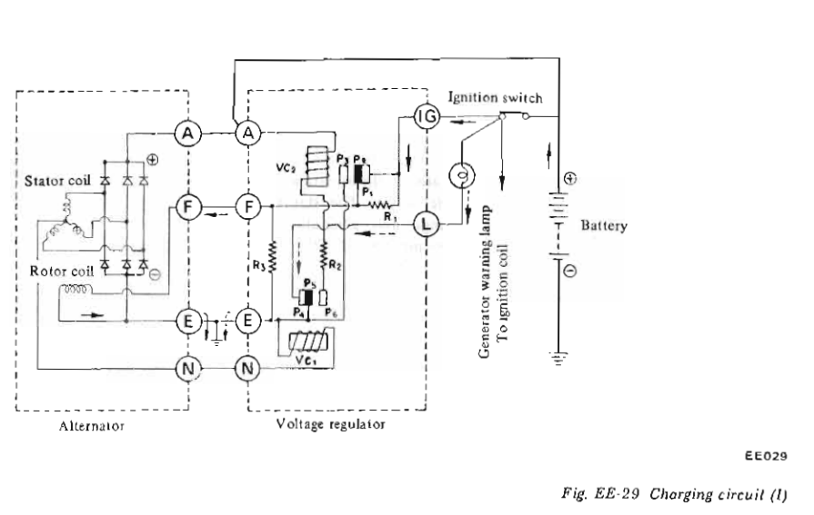

On 12/4/2022 at 10:15 AM, Dolfinz said:
So is the consensus that my VR is bad or what?  Considering it doesn't click when plugged in I wouldn't think so.  Please advise next steps.
The odds seem good that your VR is bad, if it's from the same batch that madkaw and the guy he was talking to got theirs.  Hard to tell, so far it's just a bunch of people talking about parasitic draws and clicking or non-clicking VR's.
In short though, if you don't have a parasitic draw with the VR unplugged but you do with it plugged in that seems like a good indicator of a bad VR.  There are only two paths from battery + to Earth. Edit - there is also the path through the alternator when the VR is plugged in.  Missed that when I posted.  Check with meter.
Poor quality VR's was one of the reasons that many people converted to internally regulated alternators.  You just couldn't find a good replacement external VR.  That was when the market introduced solid state VR's.  Looks like they're back to mechanical but they're still bad.
Edited by Zed Head
Sorry for the delayed response, I was traveling for work.  So, it appears that you're saying the VR is bad, or at least suspect as the current draw is considerably higher 3-3.5A with it connected versus not connected .25-.5A.  I don't remember where I bought it and there's no info on it regarding manufacturer or part number.  Can anyone recommend a place I can buy a replacement that is reputable and should provide me with a known good VR?  I'd like to get beyond this issue and get the car running again.  Just to confirm, the feed to all other wiring and the fuse box is fed from the VR correct?
Given the purpose of the VR, if there is a current draw when it is plugged in that is absent with it unplugged, yes, it's bad.
I have a 74 VR that I bought from Black Dragon many years ago that I never used. You can have it for $30 shipped. No warranty. I opened it up only to see if it's similar to the VR you have.
I can't confirm what you're asking because I don't know what you mean by "the feed to all other wiring and the fuse box" Feeding what to what? What other wiring?
I retract this statement.  I didn't really look at the diagram I posted.  If the alternator A circuit is shorted through the alternator stator coil then you'll have a draw also.  It would short when the VR was plugged in.  You could easily check it with a meter.  I think it might actually be a test procedure in the FSM.  Heading there now...
