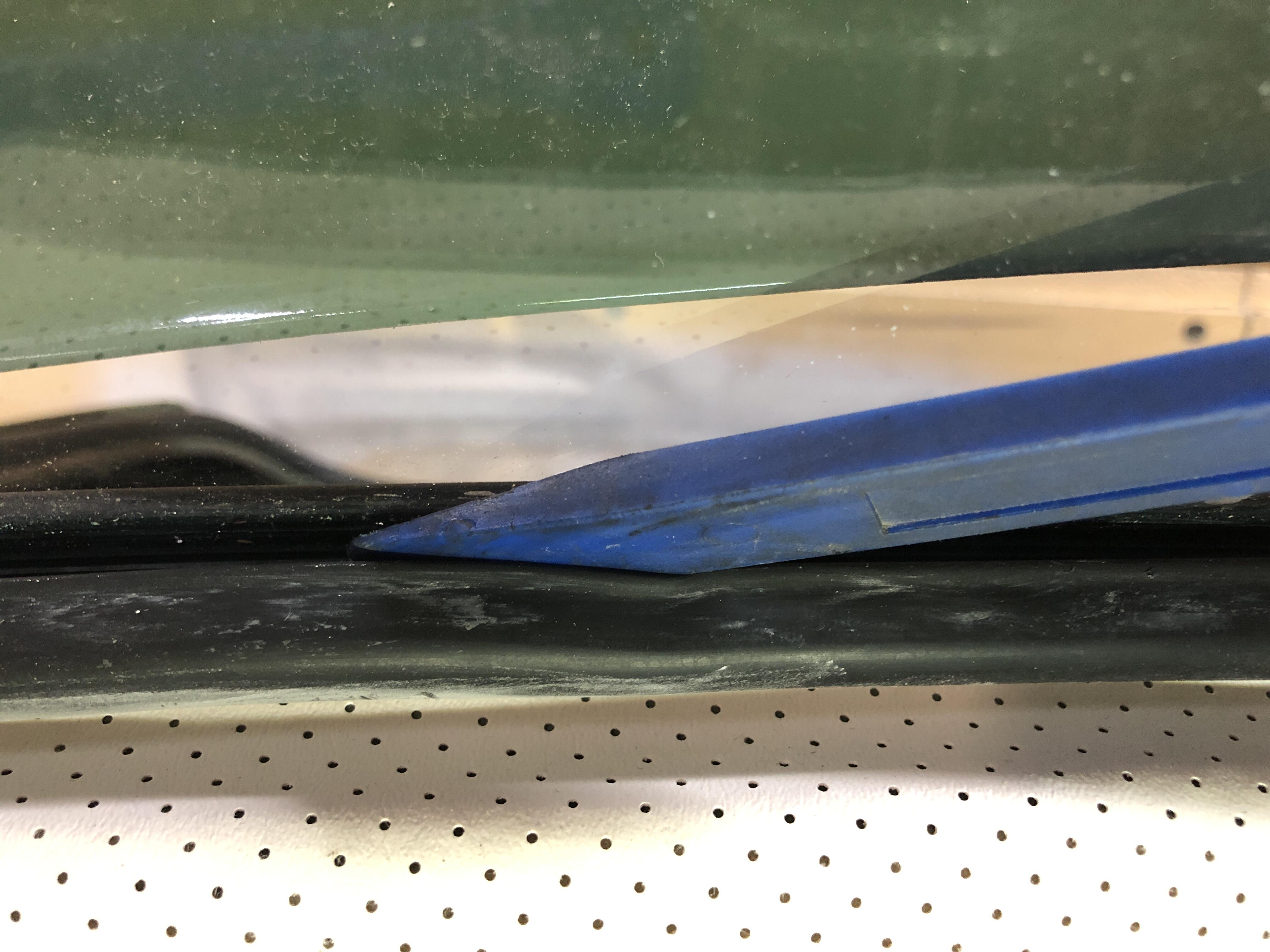

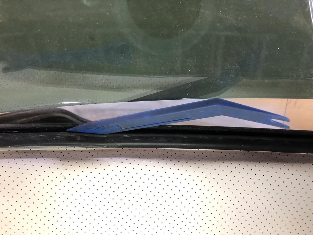

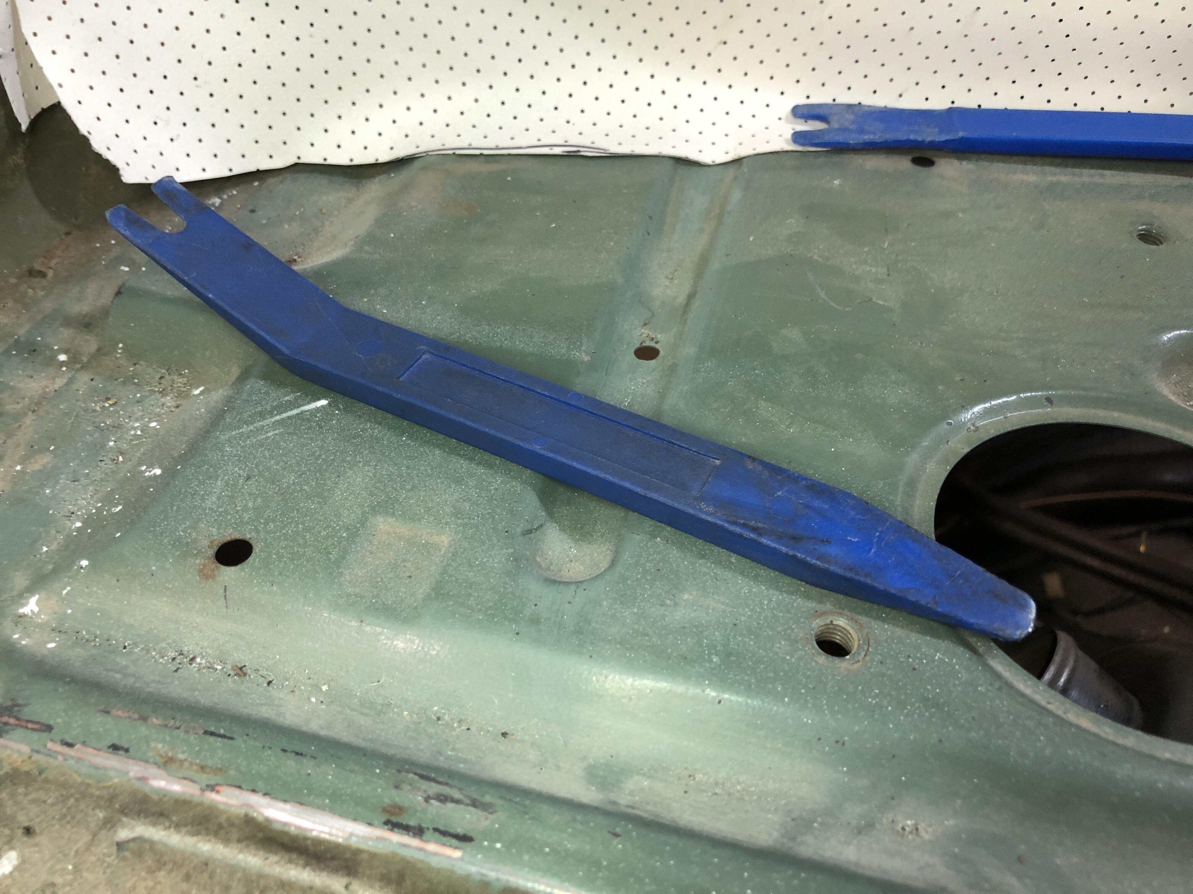

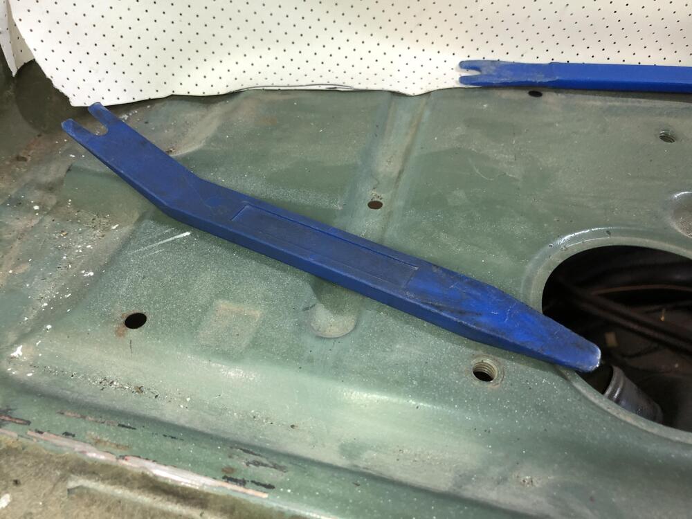

July 18, 20223 yr Author comment_642566 Ok, this will seem real obvious when i say it, you’re going to kick yourself for not thinking of it, but here goes. Use two ropes. Start center top AND center bottom. Pull the bottom left and right a little, pull the top left and right a little, keep working out to the edges. Stop about an inch short of the sides. Keep prying the gasket all the way over the pinch weld with a flat plastic tool all the way across the top and bottom. Just put the tool between glass and gasket, and push the gasket down and toward you, away from the glass, and push it down hard over the pinch weld to seat it fully. Do not pry against the glass, no need to, you are pushing the rubber lip all the way (down at the bottom, up at the top) over the pinch weld. Once both top AND bottom lips are pulled over the pinch weld and seated, that sucker is trapped in place. Now go around the bottom two corners and up the two sides with the two separate ropes and finish by going around the top corners. Bang you’re done. I did the rear glass by myself. Did not require any outside pressure. Yes I went out a couple of times and taped the glass/gasket to help it lay as deep and flat as it can. Did not struggle in any way shape or form. Took under 10 minutes from start of pulling. Z windshields “should” work just as well. They have more curvature, maybe a friend to help keep the gasket/glass flat and seated deeply as you pull both top and bottom over the lip. Should have some to do this summer, will keep you posted. Edited July 18, 20223 yr by zKars Link to comment https://www.classiczcars.com/forums/topic/67658-making-replacing-your-windshield-yourself-easier/#findComment-642566 Share on other sites More sharing options...

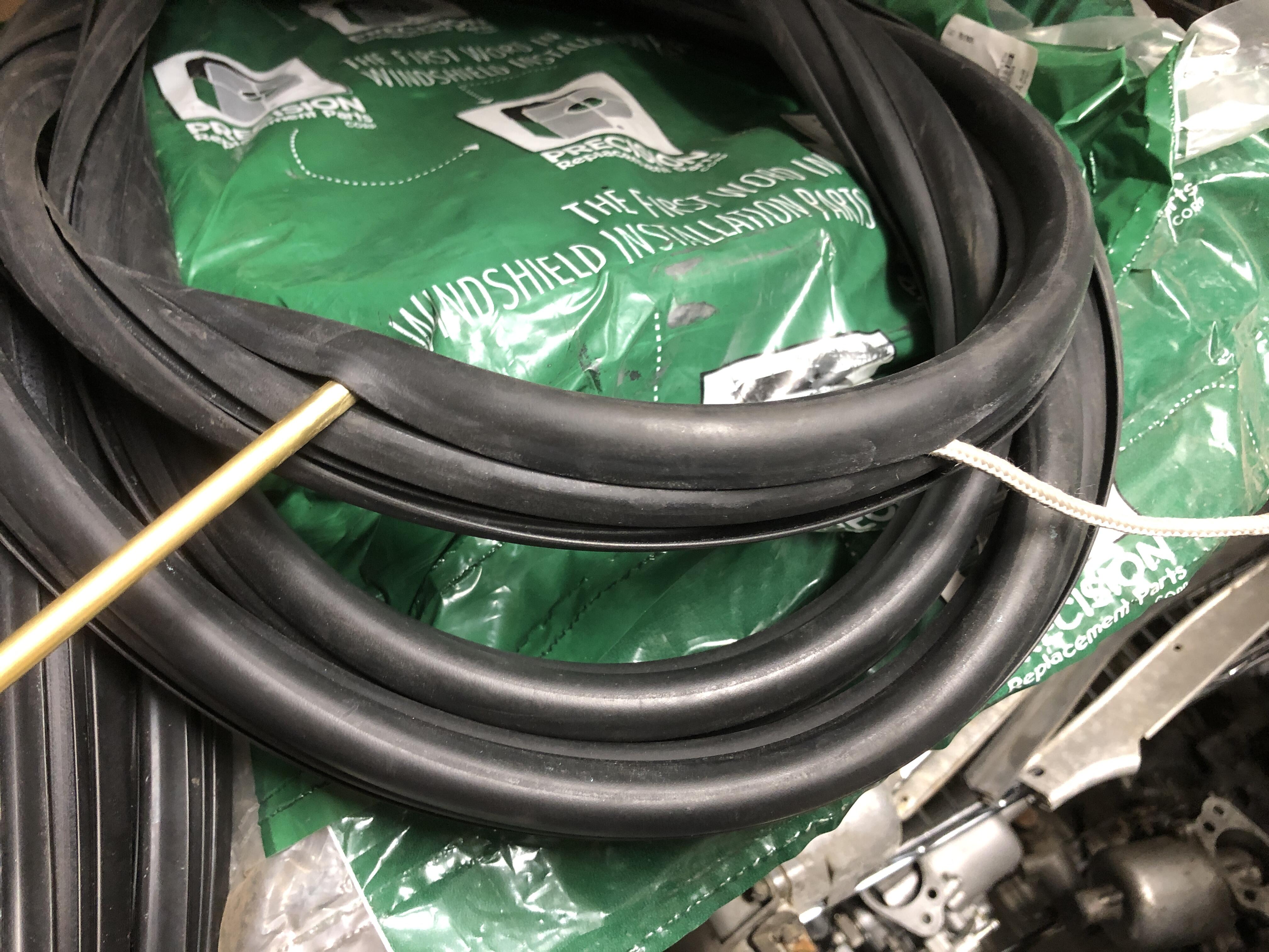

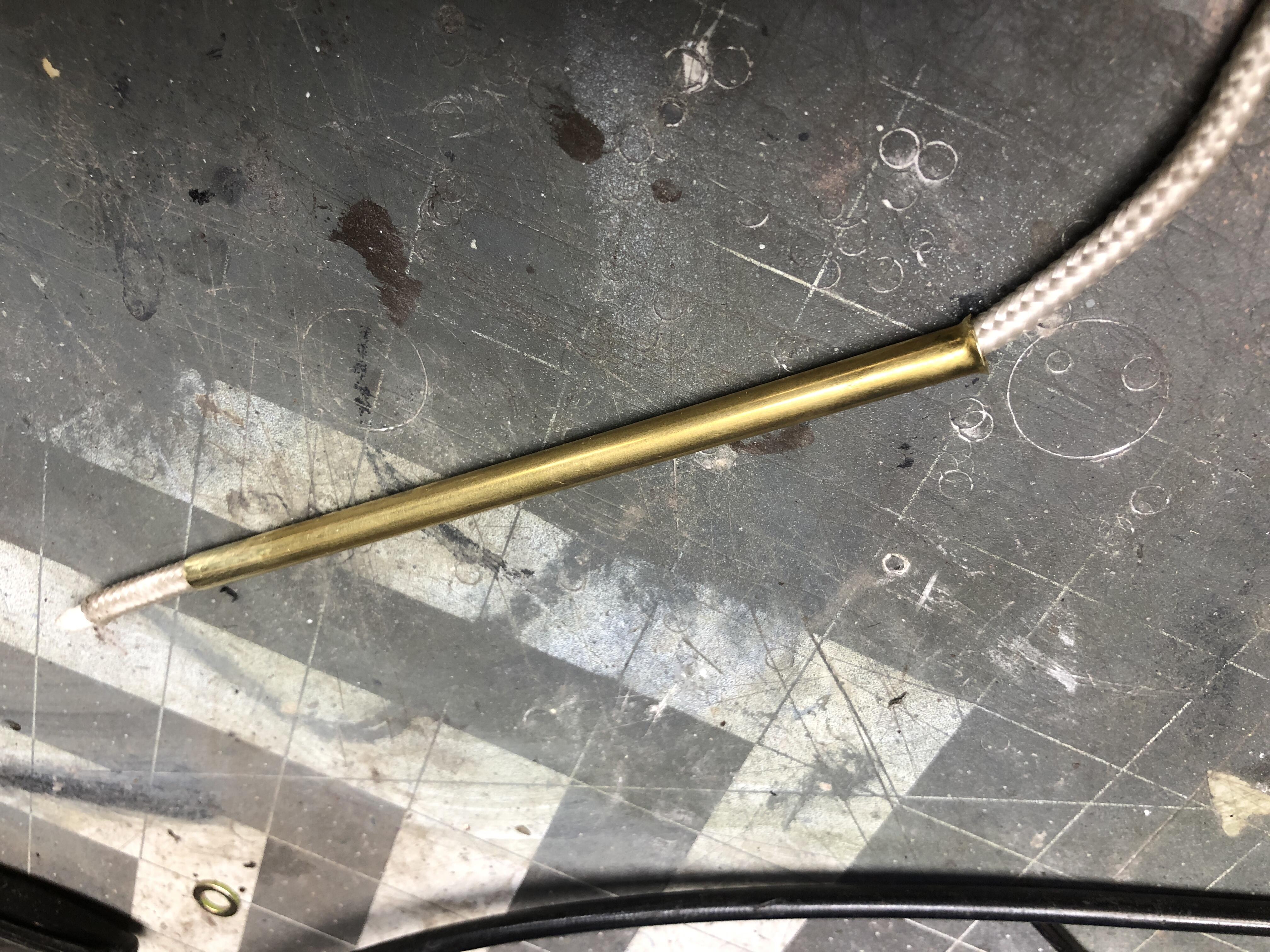

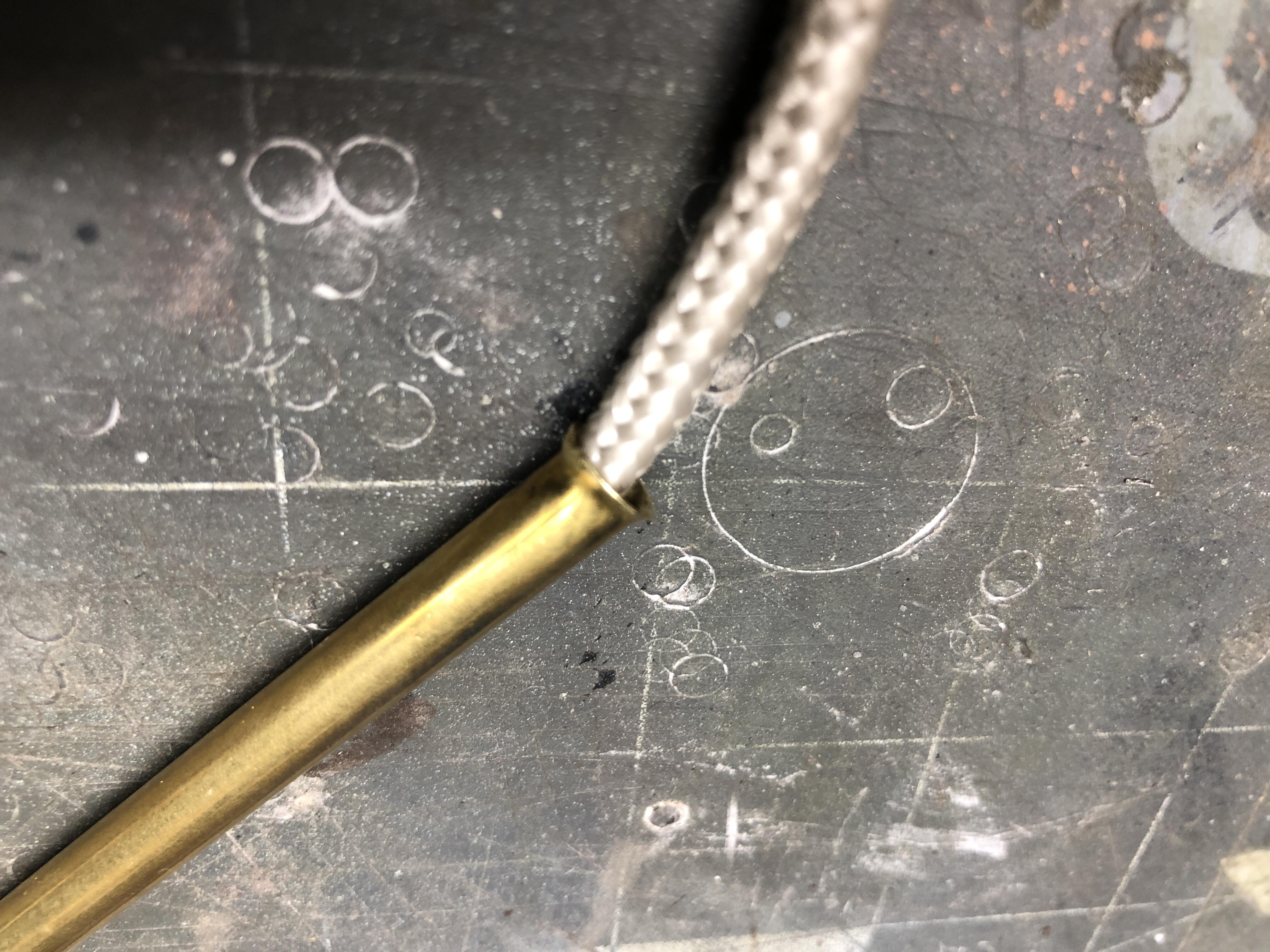

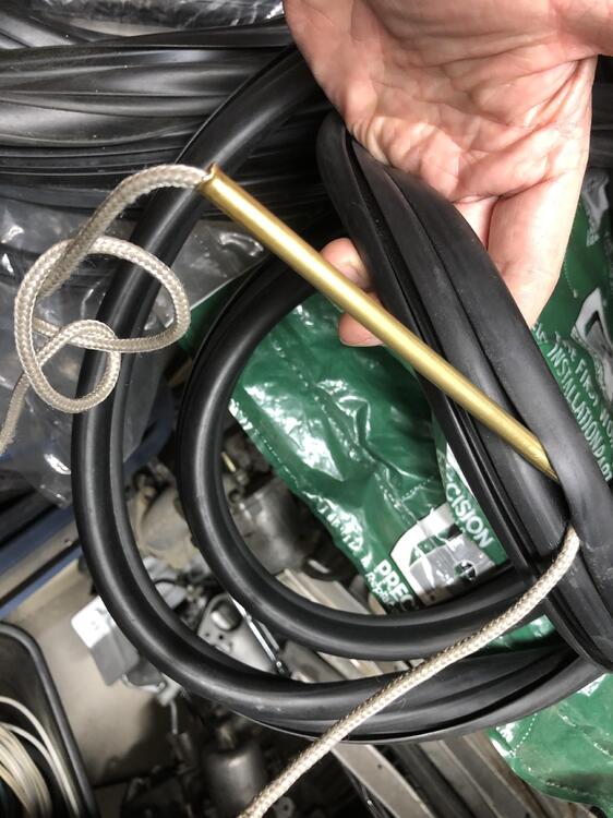

July 18, 20223 yr Author comment_642600 Just to add a couple of details that make this job easier for me. Tools. 1. Getting the rope in the groove. If getting one rope in the groove is tough for you, and my suggestion of using two ropes gives you the willies, then use this trick Go buy a 6 inch piece of 1/4 OD brass or aluminum thin wall tubing from a hobby supplier. Stuff your 3/16 rope through it (I flared one end to make it easier) and use this stiff piece of tubing to poke the rope into the groove (use the un-flared end), then just draw the tubing along the groove feeding rope into it as you pull it along. Keep it poked deep in the groove as you go. Should take you under 60 sec to get the rope all the way around and tucked in real pretty. Link to comment https://www.classiczcars.com/forums/topic/67658-making-replacing-your-windshield-yourself-easier/#findComment-642600 Share on other sites More sharing options...

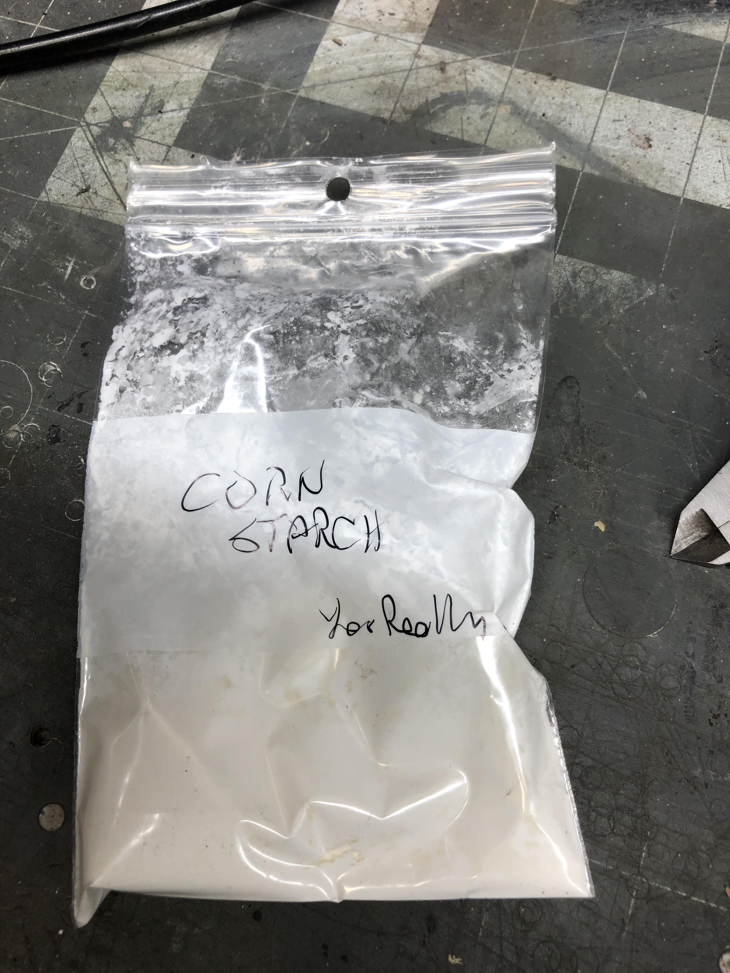

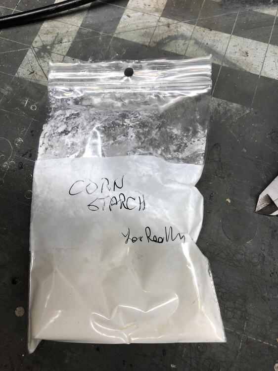

July 18, 20223 yr Author comment_642607 Tool #3: Lubricant When I first starting doing my glass, I followed almost all the on-line advice and used soapy water and / or window cleaner spray (windex or Invisible glass) to lube the rubber to help get it on the glass to start, and to get the gasket and rope to slide and slip easier during installation. I quickly found this was a messy and relatively in-effective thing to do. Both evaporate quickly and are never where and when you need them when you need it. I went dry from that point on. For one thing, keeping the gasket on the glass and having it stay there while you work on getting it all on the glass is someplace I want MORE friction to keep it in place, not less. And I have to problem pulling rope out of dry groove and if I spend time getting the whole thing settled into the window opening BEFORE I start pulling (see above about pinch weld distance) then being dry is just fine. BUT, that said, if I found a “better” lubricant, I’d use it. I think I have my holy grail on this as well. Baby powder. Well, actually Corn Starch. Dry, cheap, stays in place, wipes, blows or washed away when you’re done, and most importantly, takes away all rubber tackyness. A little goes a long way. Dip a finger in the powder, rub it on the rubber to leave a very very thin white dusting of powder where you want it. If you want to use Baby powder go for it, but you better be able to explain that pretty smell to your significant other… I’m looking forward to using it on the SS trim groove as well, to help get that nasty stuff in place a little easier. Edited July 18, 20223 yr by zKars Link to comment https://www.classiczcars.com/forums/topic/67658-making-replacing-your-windshield-yourself-easier/#findComment-642607 Share on other sites More sharing options...
