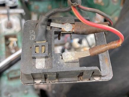

May 23, 20223 yr Author comment_640771 Hay Patcon, Thank you, do i need to disconnect the battery to replace the bulb ? Link to comment https://www.classiczcars.com/forums/topic/67496-parts-wanted-looking-for-a-interior-light-lens-for-a-1975-datsun-280z/?&page=2#findComment-640771 Share on other sites More sharing options...

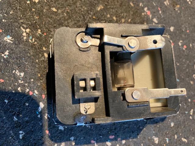

May 23, 20223 yr comment_640773 I have a few of those too. There are three wires. One ground. One comes from the door pin switch. The other is just 12V to the light so it will come on when you push the lens. If you swap the wires over one at a time you should be fine. You could also pull the fuse, or disconnect the battery if you like. Link to comment https://www.classiczcars.com/forums/topic/67496-parts-wanted-looking-for-a-interior-light-lens-for-a-1975-datsun-280z/?&page=2#findComment-640773 Share on other sites More sharing options...
May 23, 20223 yr Author comment_640783 3 hours ago, Terrapin Z said: I have a few of those too. There are three wires. One ground. One comes from the door pin switch. The other is just 12V to the light so it will come on when you push the lens. If you swap the wires over one at a time you should be fine. You could also pull the fuse, or disconnect the battery if you like. Hay Thank you Terrapin-Z, I didn't want to pull it down and short out the light and then have to see what fuse I just blew. Do you know how much the suppliers want for a light like this ? anywhere from $137.00 plus shipping to $265.00 plus shipping And Nissan still make the light it's PN # 26410-E4101. All I want is to replace the lens and while I'm inter swap out the bulb with a LED unit. But anything you want to do on a Z-car it is going to be pricy ? Thank you, Edited May 24, 20223 yr by Killain Link to comment https://www.classiczcars.com/forums/topic/67496-parts-wanted-looking-for-a-interior-light-lens-for-a-1975-datsun-280z/?&page=2#findComment-640783 Share on other sites More sharing options...
