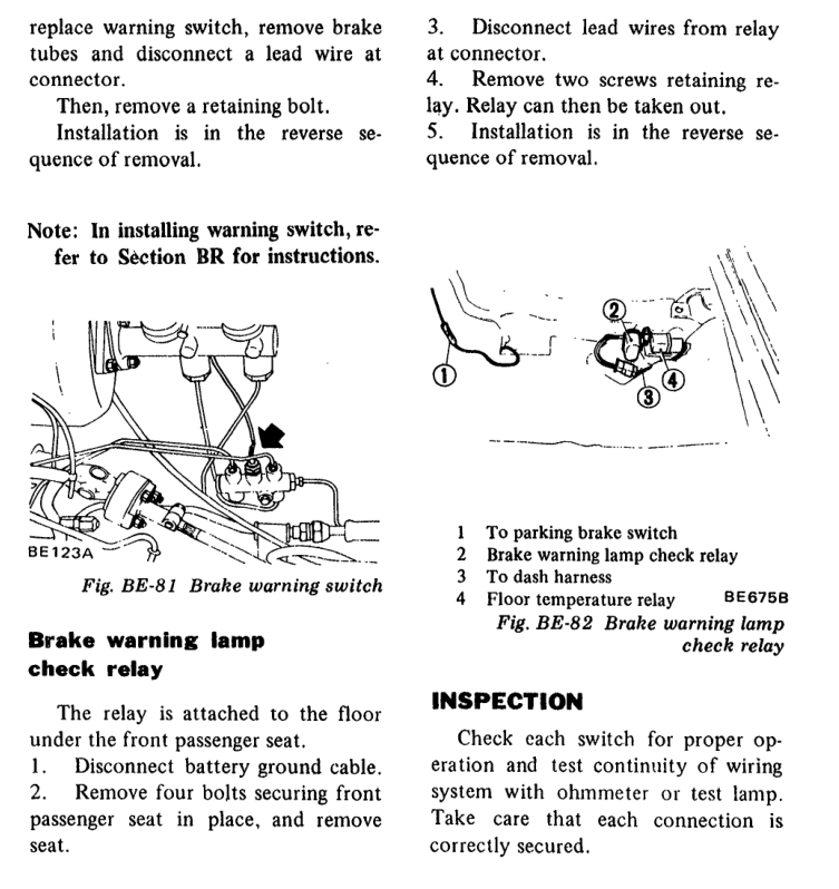

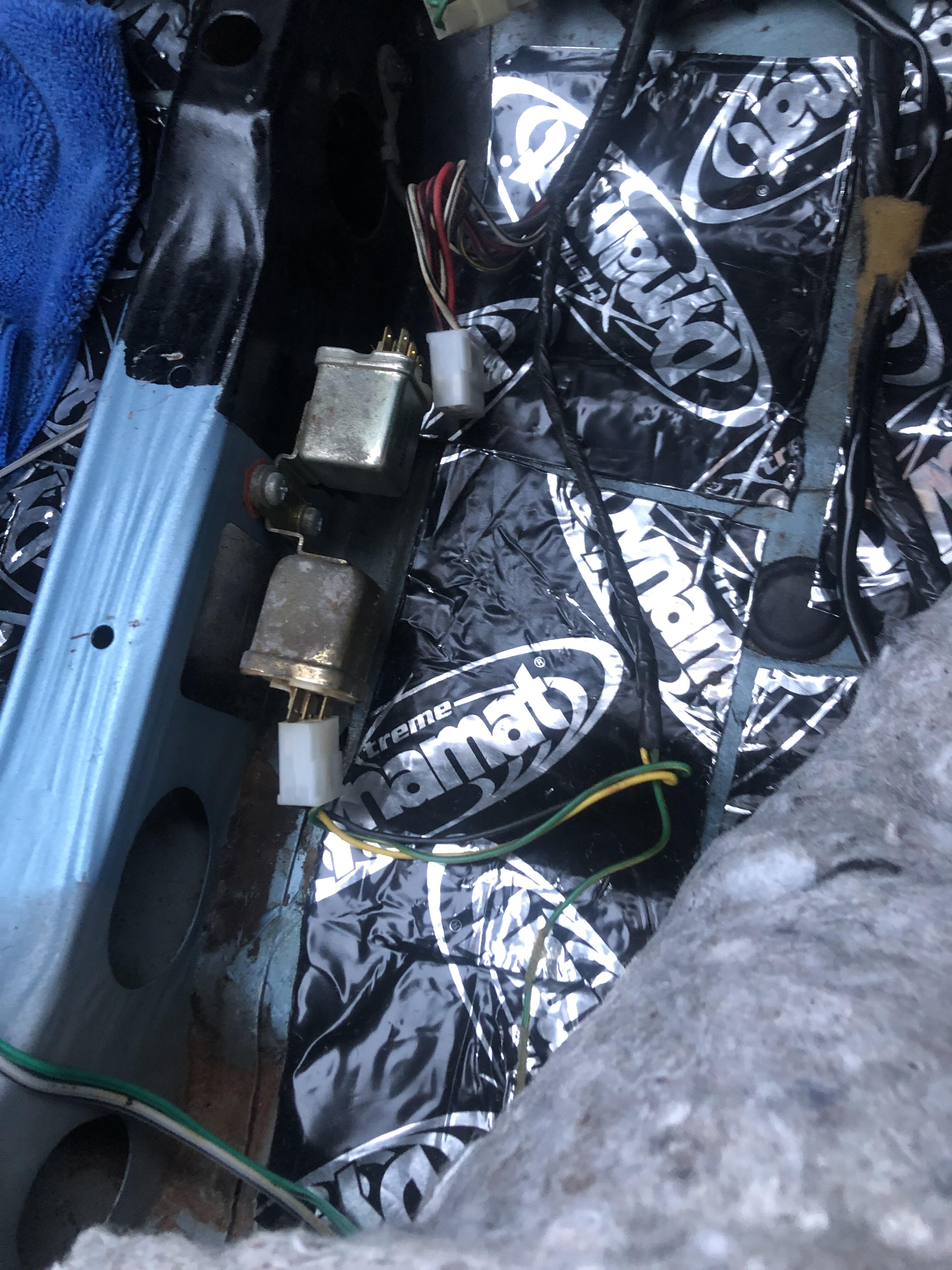

Is there a way to test the ignition relay near the passenger kick side panel? I do hear sound of clicking there. But not sure if it is ignition relay.

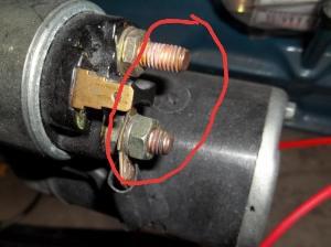

I posted this for a minute then deleted it because it's a work around fix that won't give you answer but will get you home so take it as an emergency fix. It scare the crap out of me when I do it but I have a long screwdriver that has so many arch burns on it I could use it to sharpen a chainsaw. 😁
You can turn the key to ON and jump the solenoid by making contact with the 2 threaded bolts with a screwdriver. It'll spark and scare the hell out of you but I've done it many times. Kind of of an emergency fix but it eliminates bad starters/ solenoids too. Leave the small wire on, thats the ignition switch wire.
Like I said it's gonna arch but it bypasses the solenoid and if it cranks you have a bad starter. Please be careful with the 12V. Don't hit anything else and make sure it's in PARK.
Dumb Q: if u jump these two terminals will it actually activate the plunger in the solenoid?
I mean if it bypasses the solenoid the plunger will not activate and will not let the starter make contact with the flywheel etc.?

You can also take a piece of wire and connect it to the solenoid small terminal then touch the other end to the battery positive post.  A poor man's remote starter switch.  Cliff/site's suggestion is the quick and easy way, but using a piece of wire adds some convenience.
Supplying battery power to the small solenoid terminal is exactly what the ignition wire does.  It will actuate the solenoid which will move the plunger and cause the starter to turn and the gear to engage the flywheel or flex plate.
I lnow nothing about plungers but you can jump those two post and it'll arch and scare you but it should crank. If it fires up you should take the stater to a local chain and have it tested. Once again PLEASE be careful! That's some major shade tree I watched my Dad do since I was a kid.

I connected the remote started between two big solenoid posts.
And while ignition ON, I pressed the remote starter and also touched 12v to the solenoid pin and the engine cranked perfectly like it was before. Removed everything and the car is idling.
I think the issue is down in the ignition relay i think.
