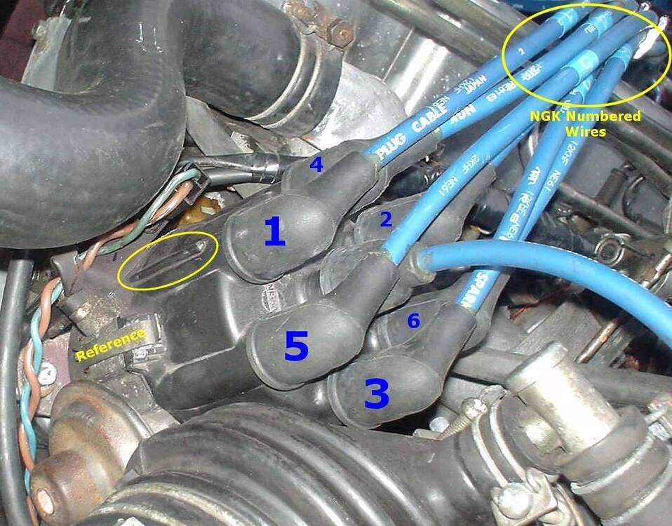

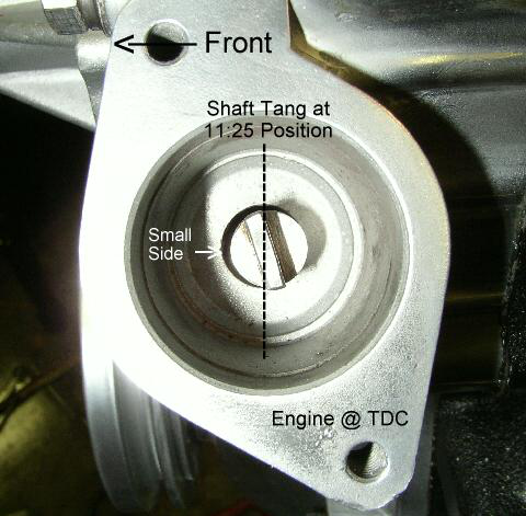

I guess I'm saying once the pump is installed and timed correctly at TDC the tang should be in the position on that pic. There's a fat side and a small side you need to keep in mind. Once the pump is timed correctly your distributor should fit in place with the rotor button on #1 that lines up with the raised line on the outside of the cap just above the front clip.
