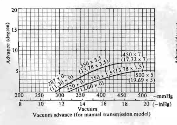

you don’t want that much vacuum advance( map curve) added on top of your base timing . You have your numbers reversed  . With speed density system the kpa increases with load . So instead of adding timing during cruise( lower kpa) , you are adding during timing during heavy loading
Madkaw I did add the extra 10 degrees but the kpa is the same as the chart. So your saying I should do more like 8-4-0 not 0-4-8

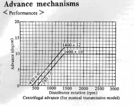

Have you studied the factory curves?  Vacuum advance disappears pretty quickly, and it's only vacuum (pressure based).
Does the software allow you to change units?  It will make things easier.  There are conversion charts.  I'd match a factory setup and then tune from there.

This should the stock configuration with a little more timing up top.
