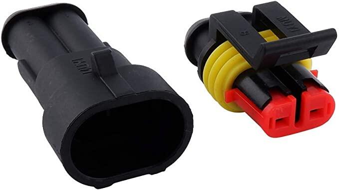

Okay here’s my plan.  This should be fun.   I’m going to mount both the HEI and the Nissan matchbox ignition modules near the coil.  I’ll use the heat sink I bought for the HEI and then build a small aluminum mount/bracket to put the Nissan module on, somewhere below the coil. I’m going to run waterproof modern auto connectors to both units where is can quickly swap the ends that go to the modules from both the coil and the distributor easily.   This will allow a few things.  One to test the difference in both of the modules.  If both function well I can keep running my Nissan matchbox ignition and if I have a problem I can swap to the HEI by just swapping one end of each connector.   I’ve also got a design in mind to mount one half of the connector to where the pickup wires exit the distributor on a plate screwed to the body do the distributor that is neat and sealed up.   This way I don’t have to mess around under there to swap ignition modules as the other end will connect to either module 18” downstream with the female side of the of the wire connector I build.
I think getting the Nissan Module away from the heat if faces near the distributor will make it far more reliable and give me easy swap out capabilities.  I’m going to mount the HEI like this other forum member did with the same heat sink,  see pic.
Here are the connectors I bought.

Here is what I suggest to help your project. For the terminations, either for the HEI or matchbox, buy a kit like this: https://www.amazon.com/HUAREW-Connecto-Terminal-Insulating-Electrical/dp/B098DX41Y8/ and a crimper like this: https://www.amazon.com/ProsKit-300-035-Multi-Purpose-Crimping-Tool/dp/B002PI8D4K
I like open barrel terminals more than single crimp since they clamp onto the insulation and the wire. With the proper crimping tool, the open barrel terminals rarely come off. The kit includes insulators so you can reduce the chances of shorting something out.
Make sure that you have a good path to ground through the mounting hole grommets.  That is the main ground for the coil charging circuit.  The 4 pin module is actually 5, essentially.
That is probably true for the E12-80 module also.  The manufacturer instructions/labels don't cover that because they expect these parts to be bolted on to the distributors.

Steve, I agree.  I bought that kit and Crimper you recommended.  ZedHead, great input there. Your think the mount bolted to the body would be enough, or you think I should run a dedicated ground wire too?
I think that it depends on how good the mounting surface is grounded.  It might be why the distributor has a ground wire attached (that sometimes gets left off).  Who knows, it might be why your E12-80 failed.  Can't hurt.  A meter reading will tell a lot.
Even if you use conductive paste the heat sink will need to be grounded.  So it's kind of a question of which bolt is doing what.
