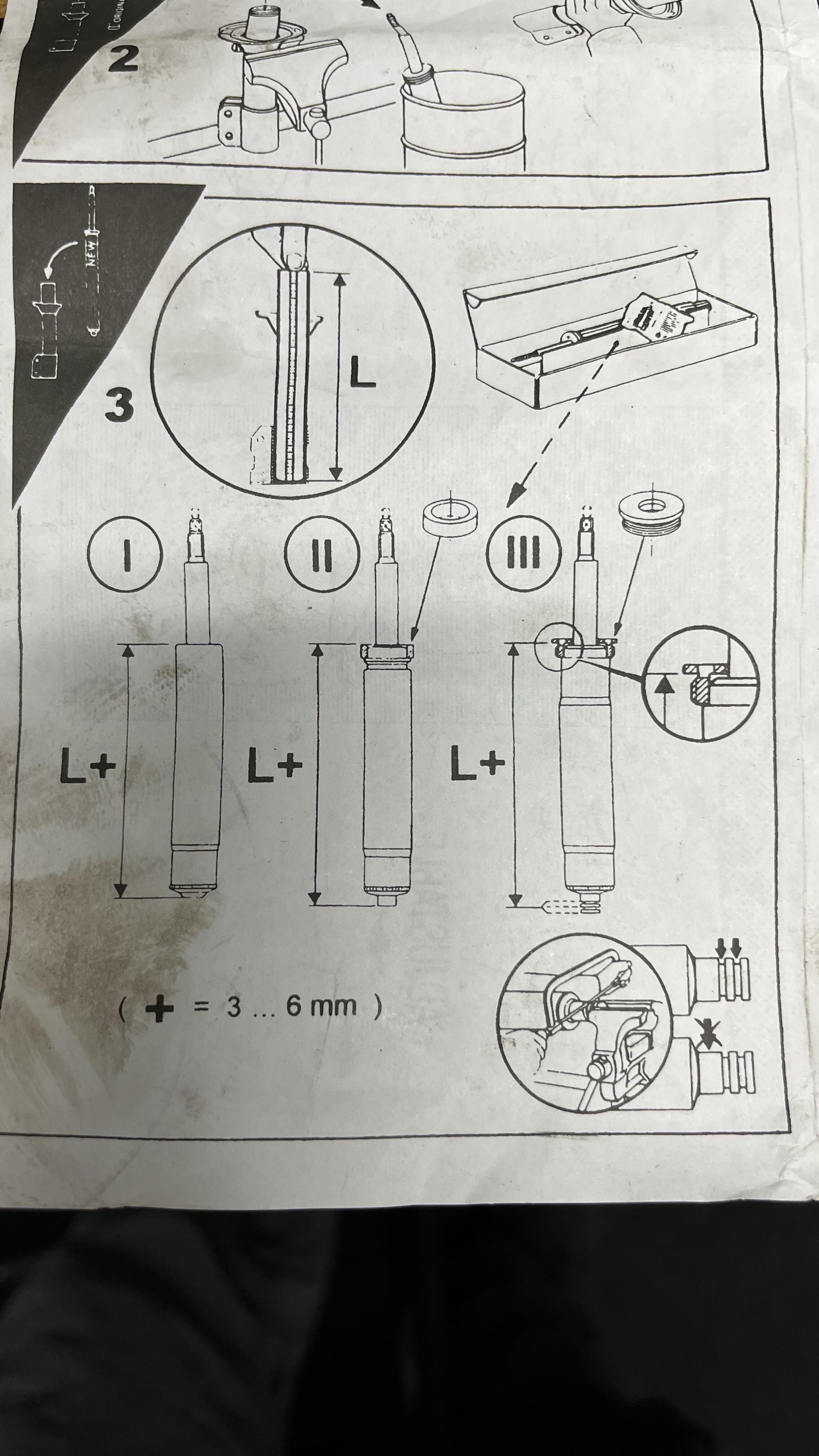

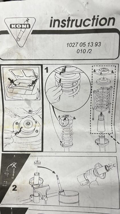

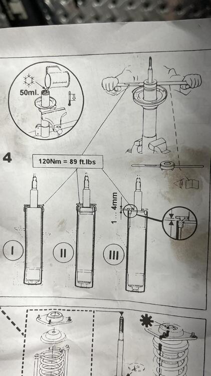

Dan, thanks! Right now it set where they came from the factory. I don’t have enough miles to make a determination of what I like. The ride is smooth, not rough like many would expect with a lower configuration. Some install issues with the Koni’s I discovered is that the strict spins inside the strut when trying to tighten the top nut, not the gland no but the one at the very top. Can’t really set a torque either so this may account for the small knock. Don’t happen on big bumps and can’t repeat it but pushing down the body. Happens at a higher frequency smaller bumps . I might call MSA and ask.

Same issue here during my install. The strut rod would spin as soon as any meaningful amount of torque was applied to the top nut. I ended up using a make shift strap wrench to get it tightened down more, but definitely not to the Koni specs still. I believe you can buy a socket with a cutout that will let you slide in a wrench to hold the strut...but who has time for that! 😂
Strut Socket - 21mm - VW (T10001-5) | Assenmacher Specialty Tools | 3186

Re:the top nut for the struts, in the past I've just blasted them on with an impact wrench, but I'll have to be more careful with the Konis as I believe it voids the warranty if you do that with them...

My issue with the Koni’s is poor instructions. They come with the 1” metal washer of some sort. Didn’t show in the instructions where it went so I placed it (in the logical location) just under the plate that holds the spring. I think this os the rattle I’m hearing. Without an impact wrench I think this install is not possible. The instructions show a place to hold the shock but it’s not on the actual shock. I hate when companies do this crap. I’m going to call MSA and talk to Joe and see what he says.

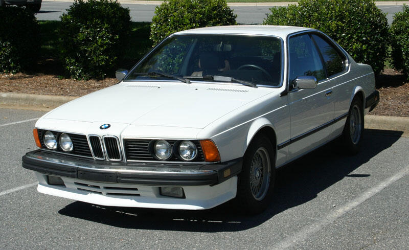

My old BMW 635's urethane air dam was warped at the bottom, and I had a couple of guys from the shop at work take a length of 1" aluminum angle, notch a V in it, bend it, and rivet it to the inside lip of the air dam to straighten it out.
Before:
After:
