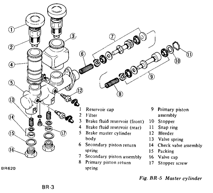

p.s. And, just because others, apparently, use a residual pressure valve on mixed drum and disc systems it doens't mean that Nissan did.  Despite the extensive descriptions that Nissan put in to the brake chapters, the only mention of a difference at the MC between front and back is about the reservoir.  The closest thing to an RPV is the check valve that they show.  But there is one on each side and they look the same.

I only use wilwood because of their reputation with brakes.  If I could contact the engineer that made the m/c for these cars, that would be better.  I bet there are docs somewhere that discuss that m/c design. I'm just looking for data to help me make a decision.  I'm there now.
All my brake problems are fixed.  I'm not sure what happened to the rear wheel that was locking up.  After I freed it with a screw driver and removing the wheel, there were no more problems with that. I don't know if it got stuck when I used the e-brake, or something else, but after freeing it, all the problems went away.
I attached two videos.  PreFix.mov, this one I jacked up the front of the car and spun the tire, the brakes rubbed a little, this was prior to making changes to the master cylinder.   After reconfiguring my master cylinder with the larger reservoir servicing the front I jacked it up and did the same thing and the brakes weren't rubbing.   The second test was done after bleeding the brakes and driving the car for about 80 miles.  A great day driving around.  Just sharing, my results.
