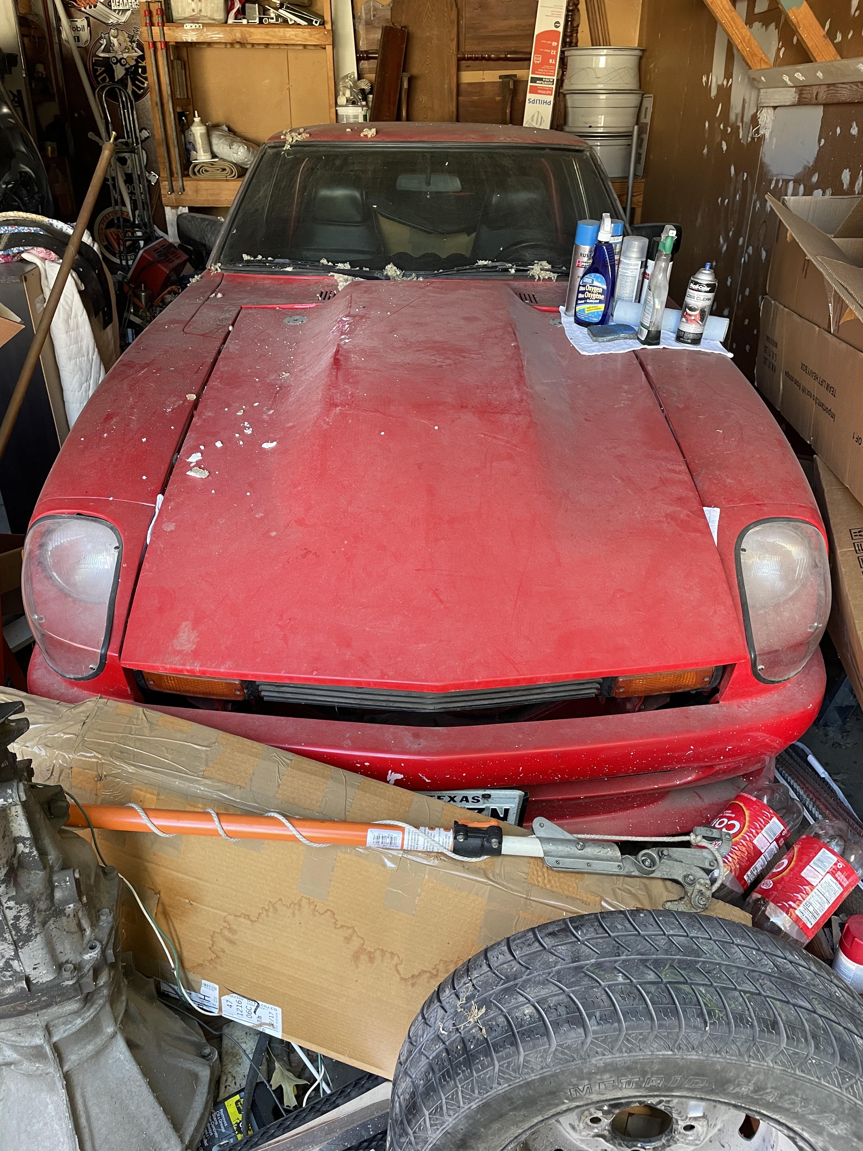

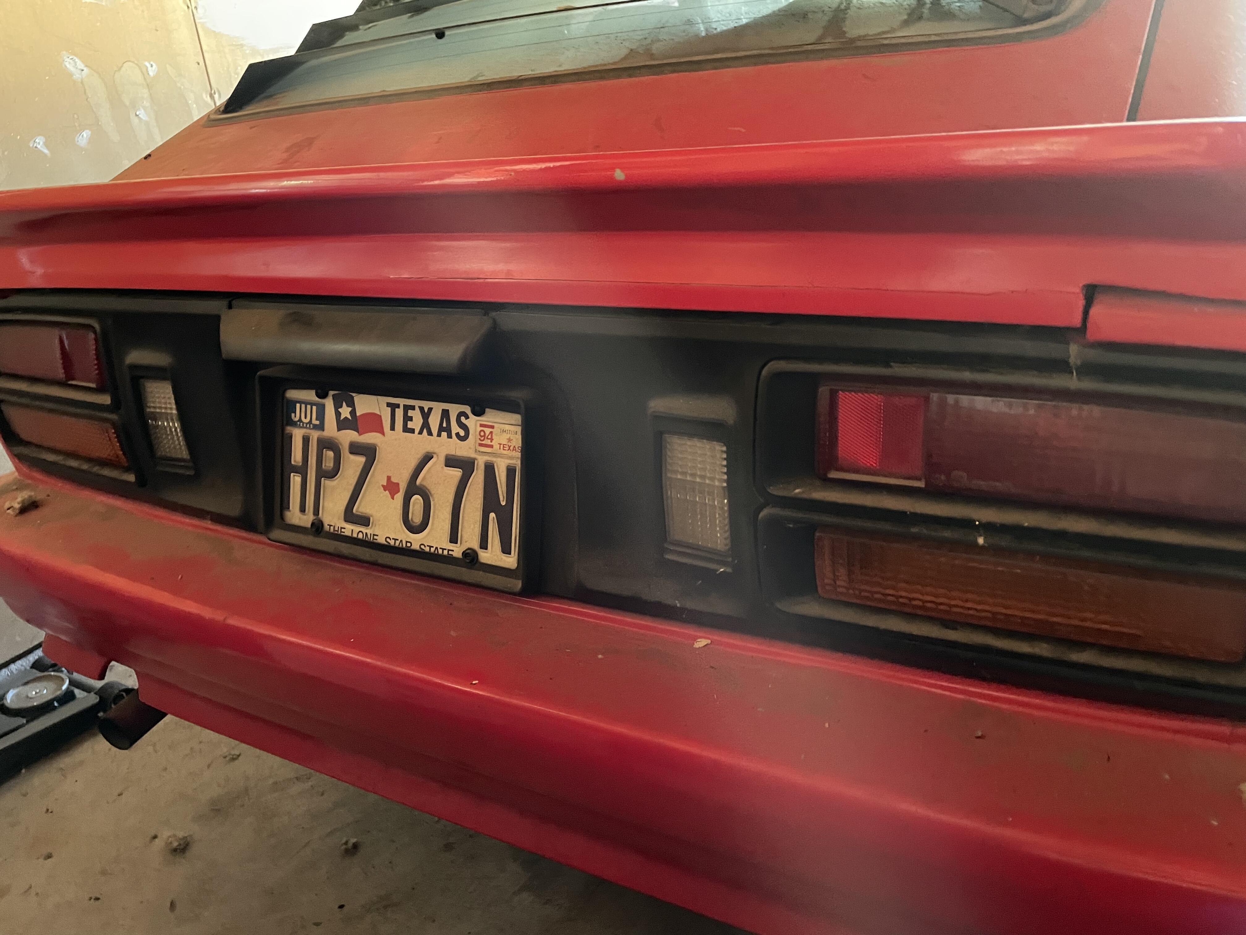

I am looking to put new wheels on my 280z. It is currently at my fathers house on blocks. I need to get it moved ASAP due to foundation issues, but the brakes are 50% complete and the drivetrain is pulled out.
I am looking at getting Enkei92 classics placed on. From what I gather, it is +25mm offset, would it be safe to assume I’d need to get 4x100 spacers?
I’ve seen conflicting information on these wheels for fitment. I want to make sure they wheels will fit.
thanks!
