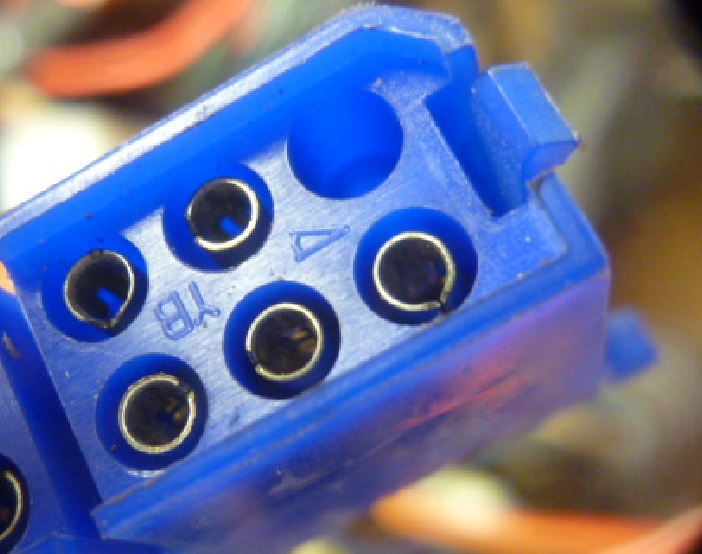

The connectors were made in Japan. I would be surprised if you found a source in the EU. The factory service manual (FSM) has most of the connectors drawn in the EE section. Some of the connectors, such as for the 74 and later, are essentially not available (headlight connectors, distributor connectors, voltage regulator connectors, and even many of the harness interconnections). If they are available, no one has made a source widely known in this forum.
Most of my hands on experience is with the later years (280's), and on those, pretty much all the connector stuff on the Z's was made by Yazaki.
Logo is sorta an arrowhead and it looks like this:
Some of the fuel injection stuff used on the 280's is AMP. But other than that, it's probably Yazaki.
