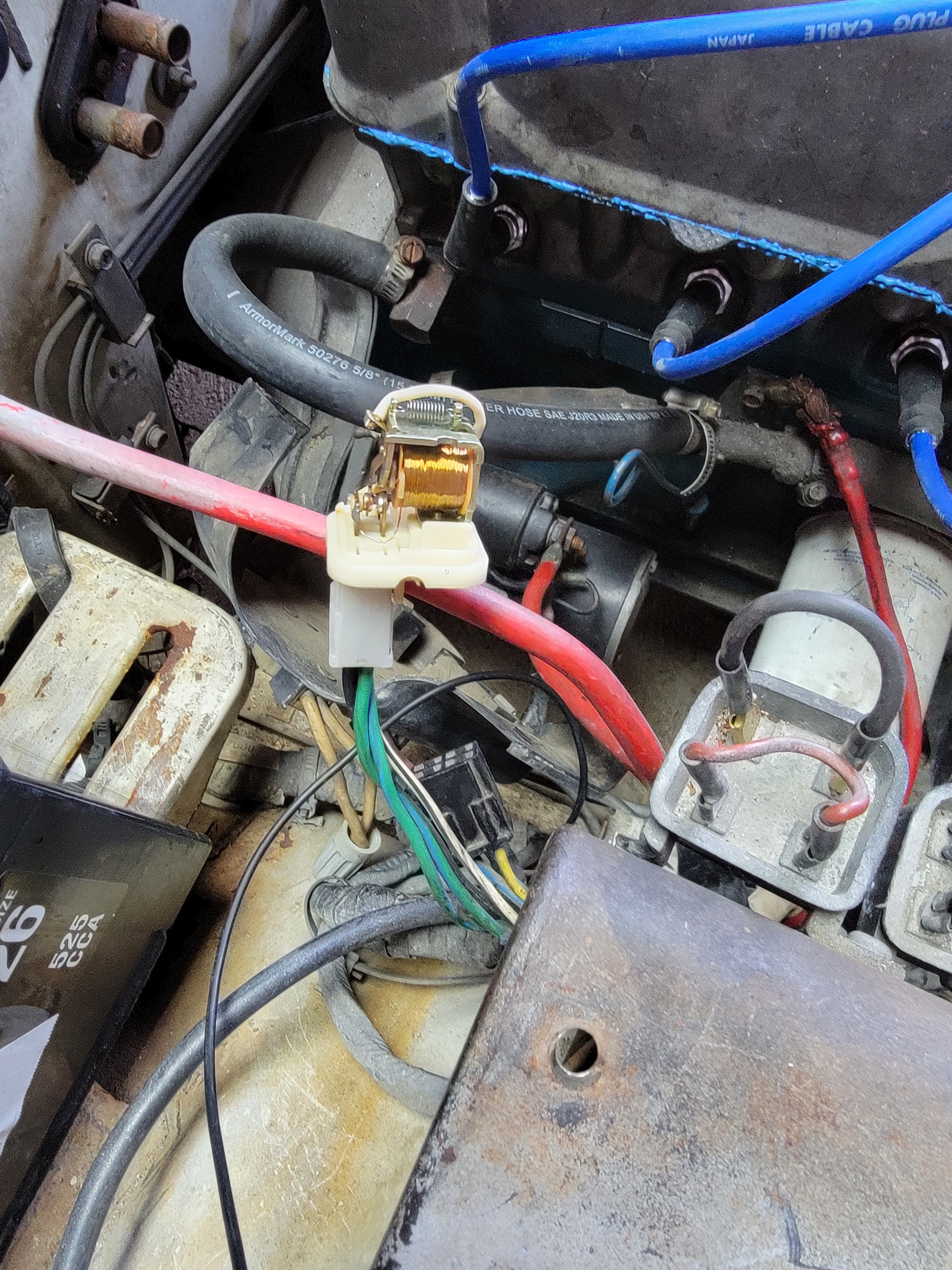

Fuel pump will not run. However, It will run when I jump across relay #25230. Please advise if there are other possible solutions to the problem. See picture of the relay. 20211011_171534.heic

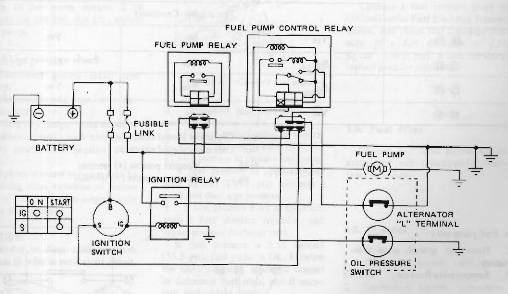

I'm not familiar with the safety features for a 280z, but isn't there a triggering circuit for that relay that is related to the oil pressure from the sender? There was a similar circuit added to a 260z to prevent the pump from running in the event of an accident.

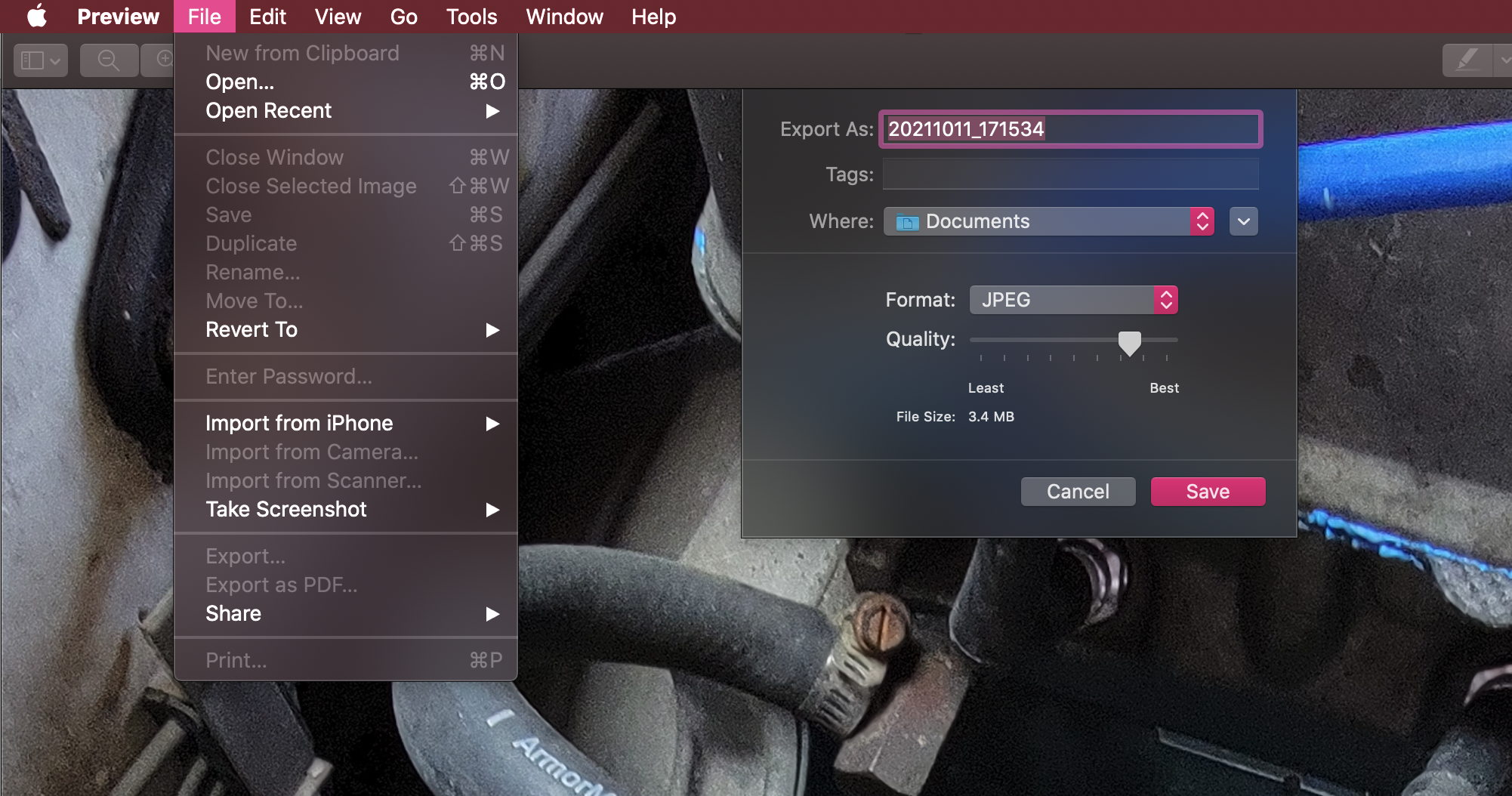

I've also attached the export window in the `Preview` application if you are using `Mac OS`... if not please ignore, just know that the `.heic` images are not visible...
`Preview -> File -> Export -> JPEG`

When does it not run?  It is only supposed to run during Start and when the engine is running.  How are you testing it?

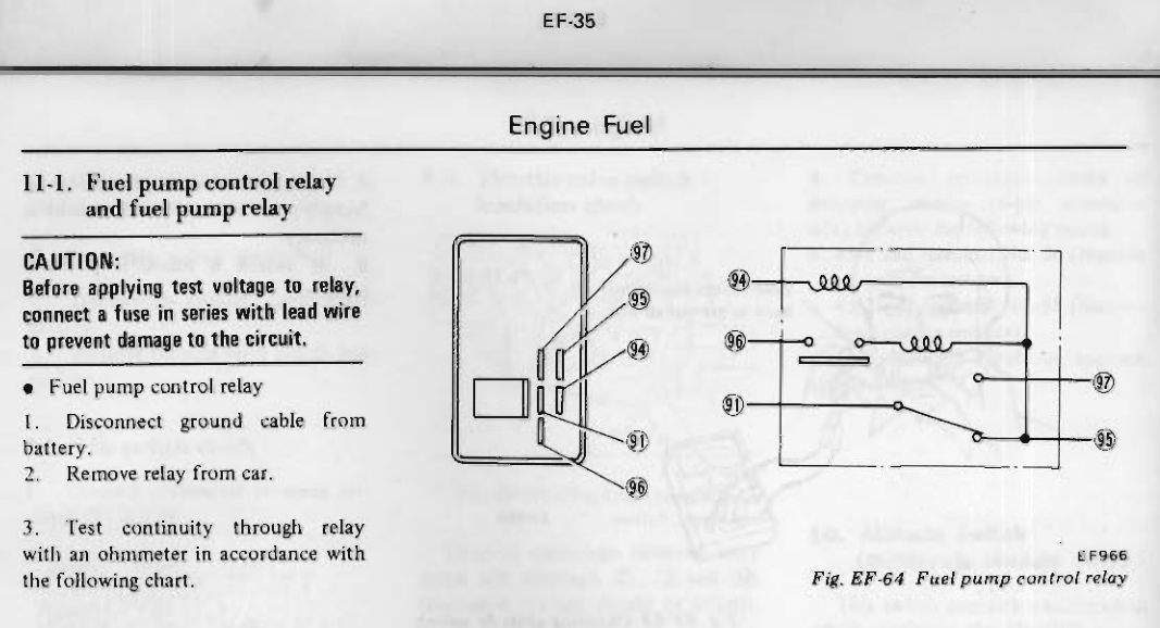

Might be the fuel pump control relay.   Nissan doesn't list the relay numbers so it's not clear what relay  #25230 is.  Also not clear why you decided to jump some pns on it, you must have some knowledge of the system.
Another pump test you can try on a 78 is to remove the oil pressure sender wire from the sensor/switch.  When you turn the key on the pump should get power.  It will be a clue about at least one function of the system.
There's a ton in the FSM about testing the relay, if you want to get in to that.
