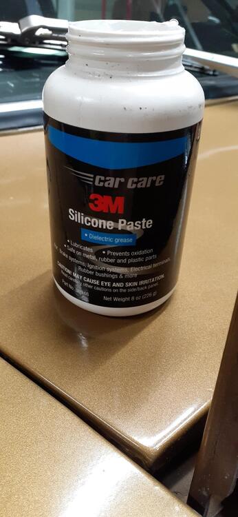

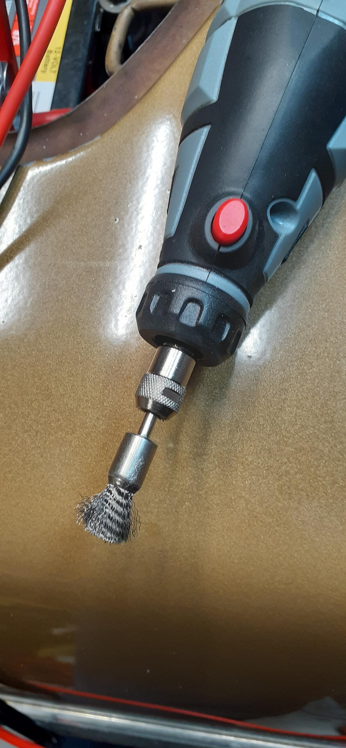

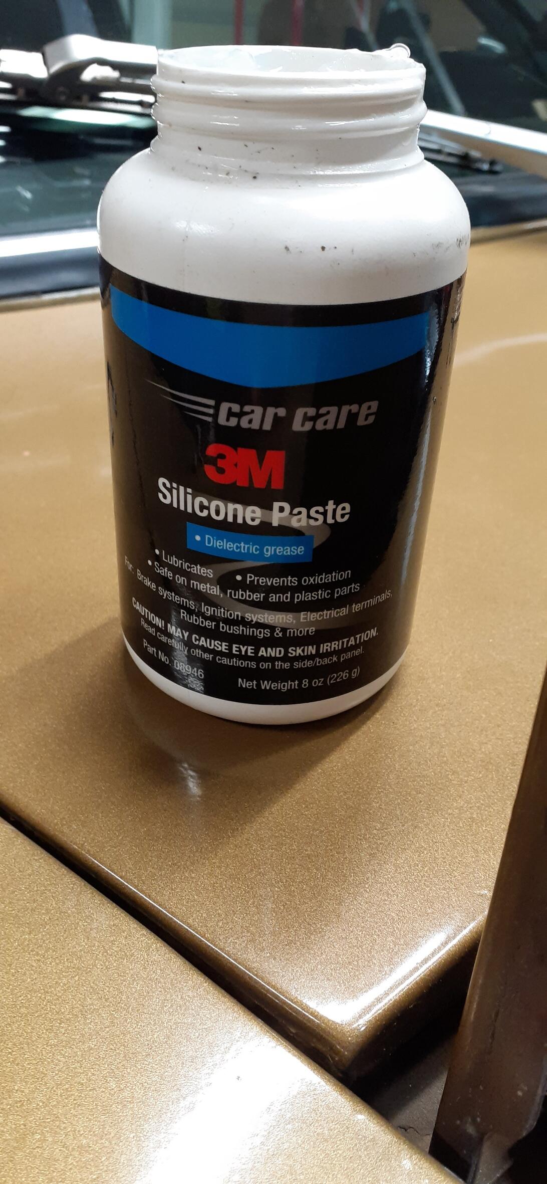

Get some Tarn-X, dielectric grease, rotary tool (Dremel) with a small wire cup brush.

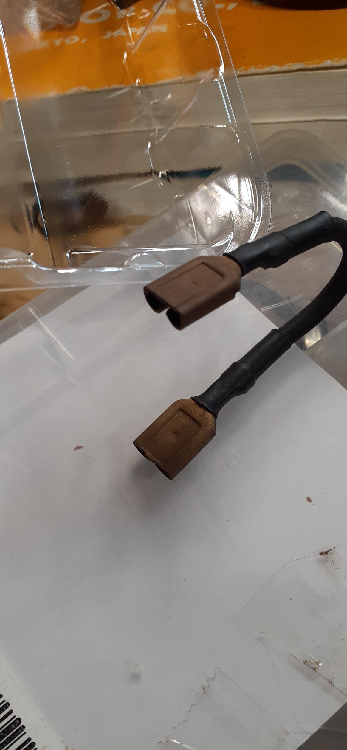

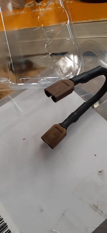

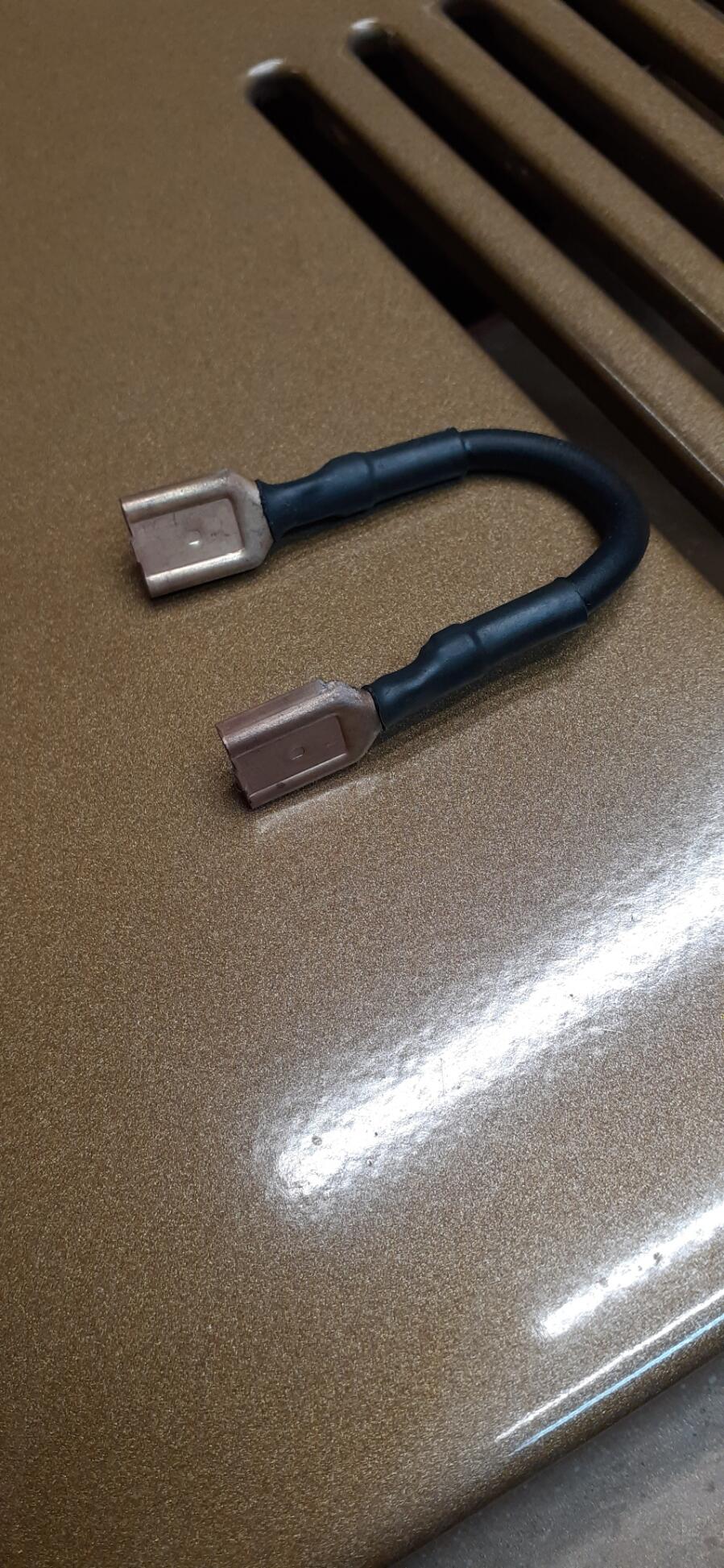

Here is a fusible link I replaced many years ago.
I put it in some Tarn-X for less than a minute, rinsed, and beat the water out.

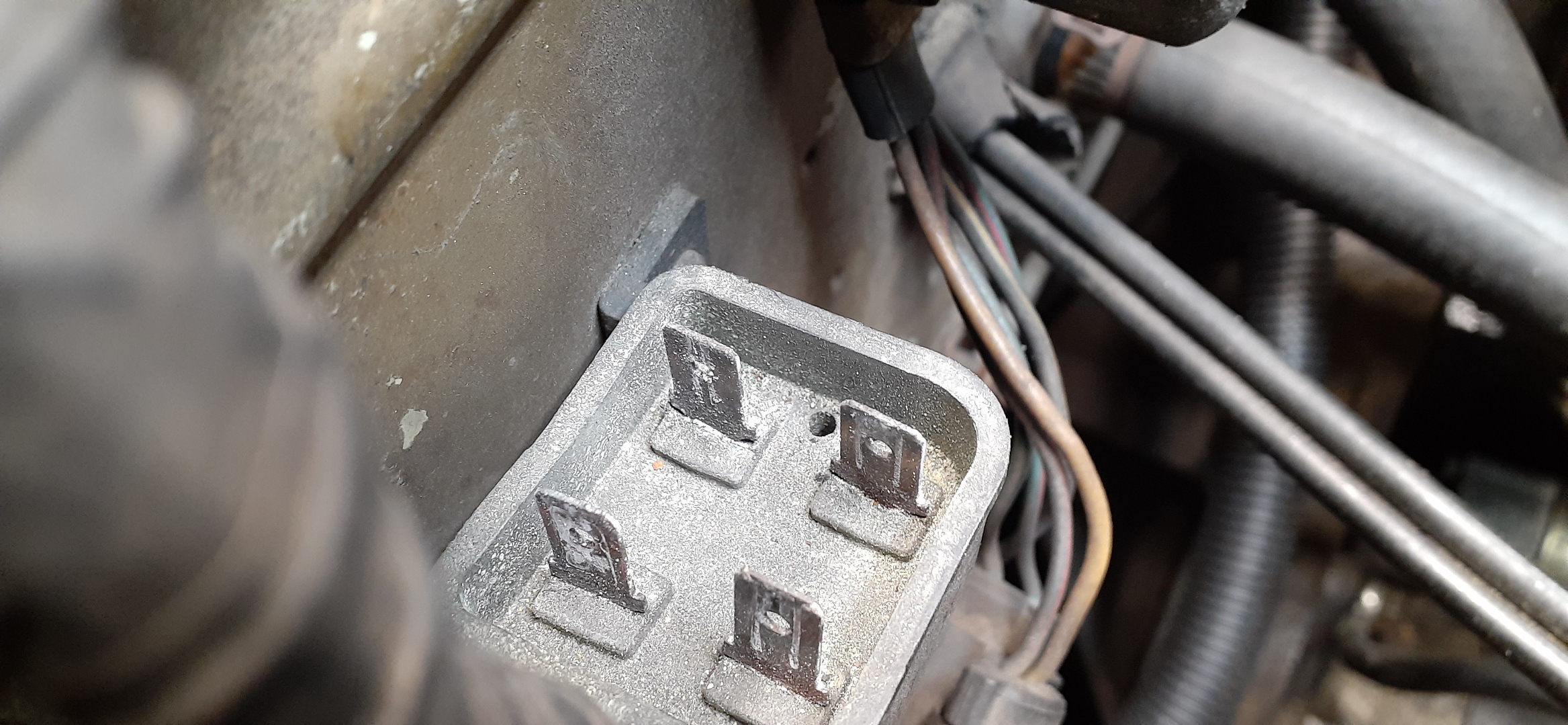

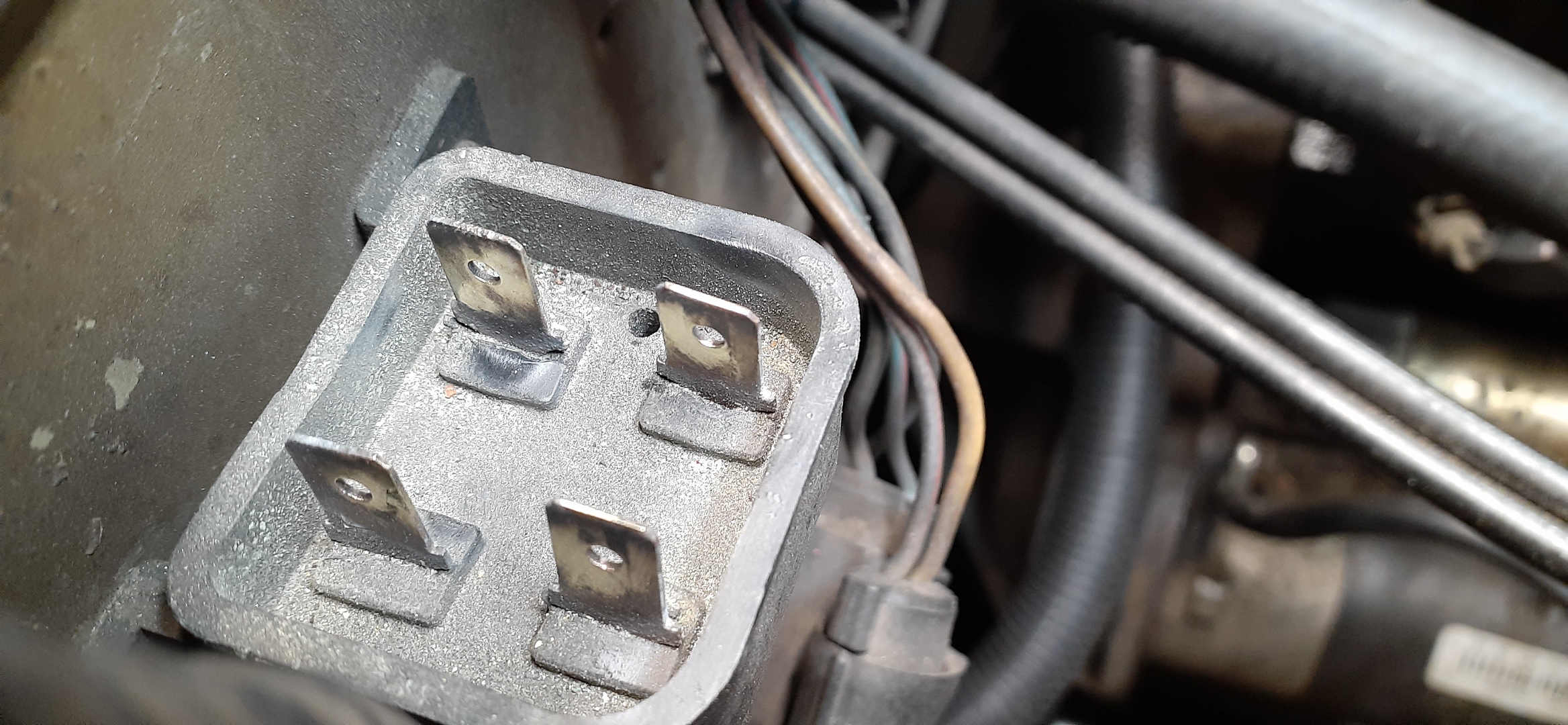

Here is how the fusible link box looked when I took off the links.
Here's how it looked after some work with the wire brush.
I coated the terminals with dielectric grease and replaced the links.
Try that, and re-test.
