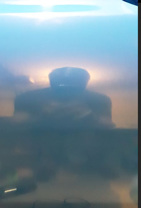

This is my reflection in the upper part of the door - I tried to mask the glare of the light with my head - sort of gives me a halo!

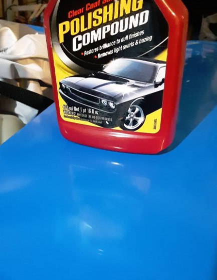

This is a reflection off the fender top:
The reflection is not well-defined.

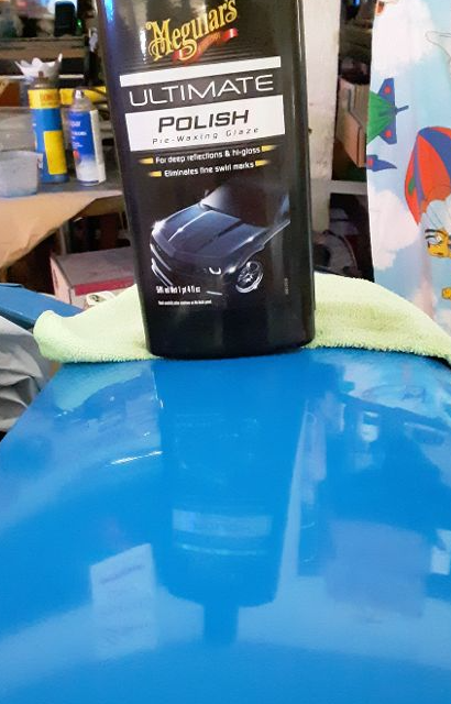

Now, I think I've just been too timid with the polish.  The guys on youtube are done after 5-6 passes.  I tried several more passes and now I get this:
I don't know if I can make it better (I killed my HF polisher trying), or if that's as good as it gets.  I suppose I could sacrifice the clear on one of the hood side flaps to see how far I can go (after I get another polisher).
