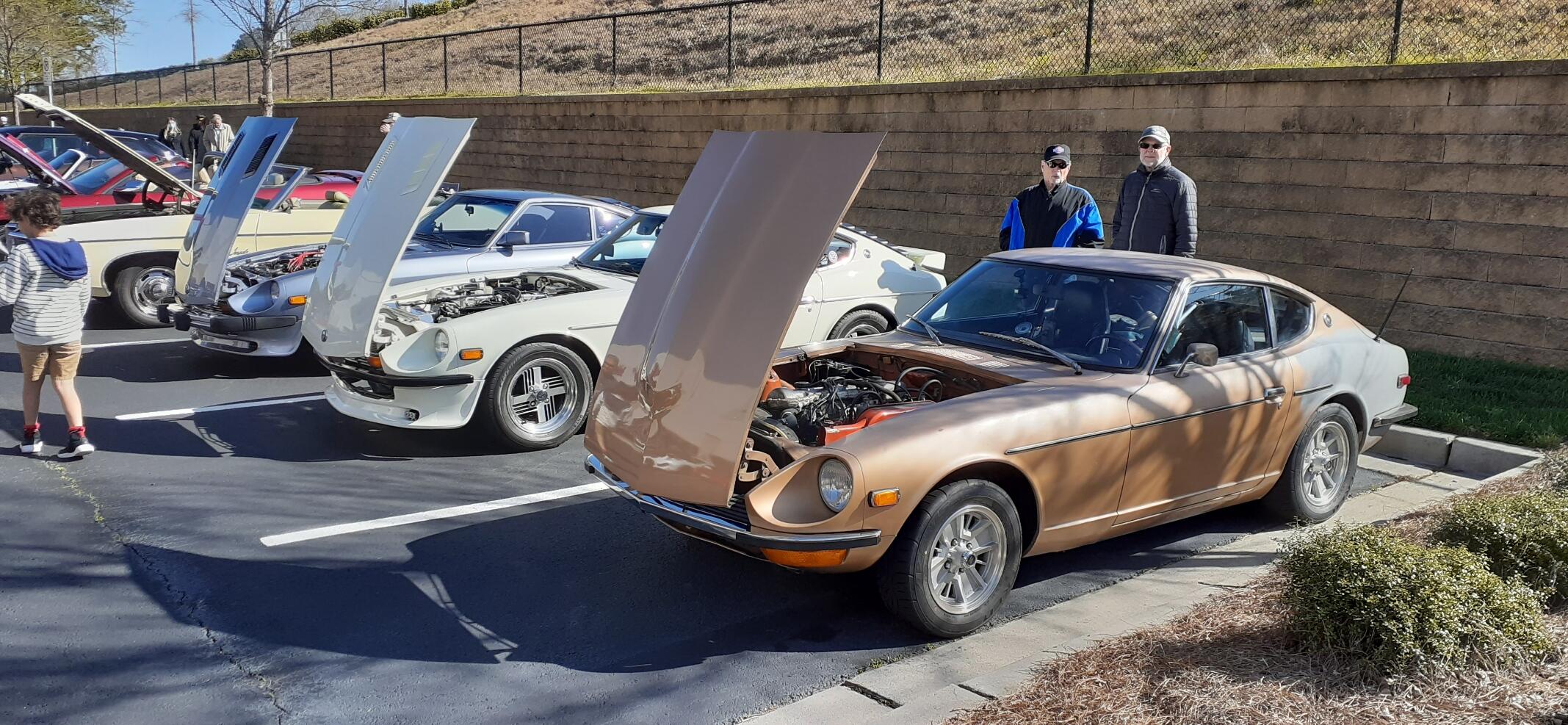

I took the car to a meet today. Aside from a short test drive after replacing the brakes, this was the true test of my work (and diagnostics). Sure enough, the pulling to the left is gone. It's about time for me to pivot to the 260Z and get all of the parts together for the rear bushings to see if I can fix the toe-in on that car.
Here's a photo from the meet with a couple of fellow GZC members.
