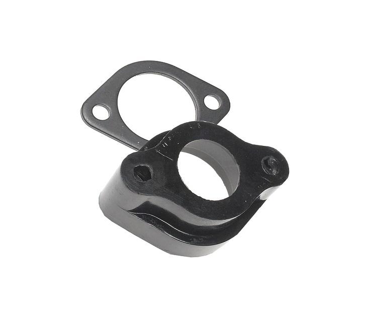

I am installing my fuel injector / railing and one of the plastic injector holders broke.  I am pretty sure that all of the parts including the injectors were original.
I am having trouble locating the proper part to purchase.

https://www.thezstore.com/page/TZS/PROD/11-3491
Rockauto.  I'll bet your local auto parts store might even have them.  NAPA maybe.  Give them the  Standard part number and they can cross-ref.
https://www.rockauto.com/en/catalog/nissan,1976,280z,2.8l+l6,1209226,fuel+&+air,fuel+injector+seal+/+o-ring,13679
Edited by Zed Head
I believe the original fuel injector holders were a 2 piece metal item, steel ring and an aluminum mounting block.   The plastic ones work fine but are easy to crack and break with too much torque when mounting them.
I rember the plastic and the metal hold down piece.
The zcardepot ones hopefully come with the rubber O-rings. You can use the old ones just be careful removing them from the old injectors. Try spinning them loose while they're still on instead of prying them off with a screwdriver.
