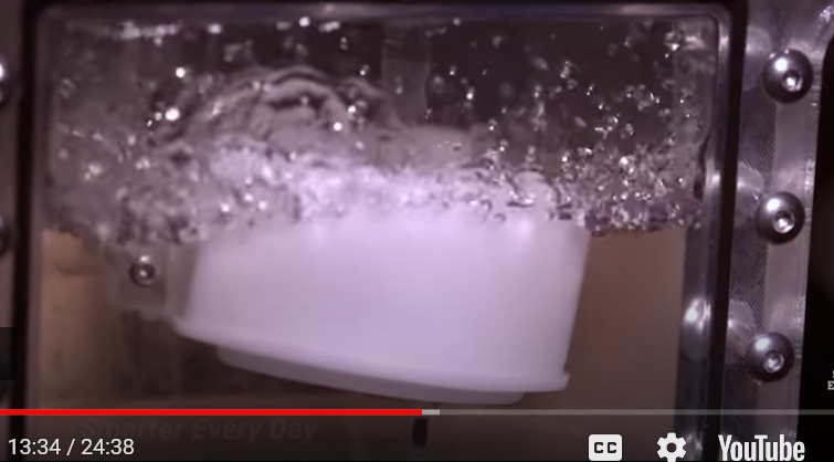

Darn it, Google must have showed me this video because YZFMax posted it in a different thread.  It should be here anyway.  Double odds of seeing it.  Look at the float bowl action.

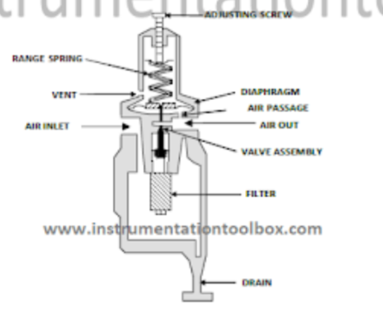

22 hours ago, Mark Maras said:
 @Captain ObviousPlease define "cracking pressure when the valve is closed"
Cracking pressure is a term most associated with check valves. They are be held closed by something (usually a spring), and there is a certain amount of pressure required to overcome the combination of stiction and the force of the spring in order to force fluid through the valve. And even though not necessarily considered a check valve, the construction of the needle valve is identical to a check valve. The only difference is that the compression of the spring (and hence the force supplied) is variable because of the moving float.
Here's some good pics and description of cracking pressure:
https://www.hydraulicspneumatics.com/technologies/hydraulic-valves/article/21884995/engineering-essentials-pressurecontrol-valves
And from that page, here's a neat sketch showing why (even though it's not a "check valve", the concepts cannot be ignored even for the float valve. If you replace the adjustment screw with the float tang, here's the carb float valve:
hydraulicspneumatics_com_sites_hydraulic
And by the way, I think we're all saying the same thing here...
Carbs need fuel in the bowl in order to operate correctly. And that fuel won't get into the bowl by magic. It takes pressure. It might not take much... In fact, in many circumstances, simple gravity is enough. But there must be something that pushes fuel into the bowl.
But for a car like the Z with a tank located below the level of the carbs, you need a pump. And a pump needs specs. So Datsun provided some specs in order to qualify and test the pump(s) used in the cars. "Should be able to provide this volume at this pressure and no higher than this."
It can be somewhat arbitrary as long as there's enough fuel provided at extended full throttle, but not so much as to force the float valve open at idle when you don't need nearly as much fuel.
In theory, principle of operation, when the engine is running the valve is never fully closed, so cracking pressure is never needed.  The bowl supply is always being depleted and the valve never fully closes.
OR, if you consider the transparent carb video demonstration, cracking pressure is needed between each intake cycle if the needle closes fully, depending on how fast the bowl refills, which would depend on pressure/flow rate of the fuel supply.  With more cylinders per carb, the needle has less time to seat fully, and things move toward constant flow through a partially open needle valve.   Always open, never fully closed.
And, stiction would really only be a factor at the pivot point for the floats.  The needle and seat are a conical shaped neelde, and the metal edge of a the orifice.  Not really a lot of stiction there.
