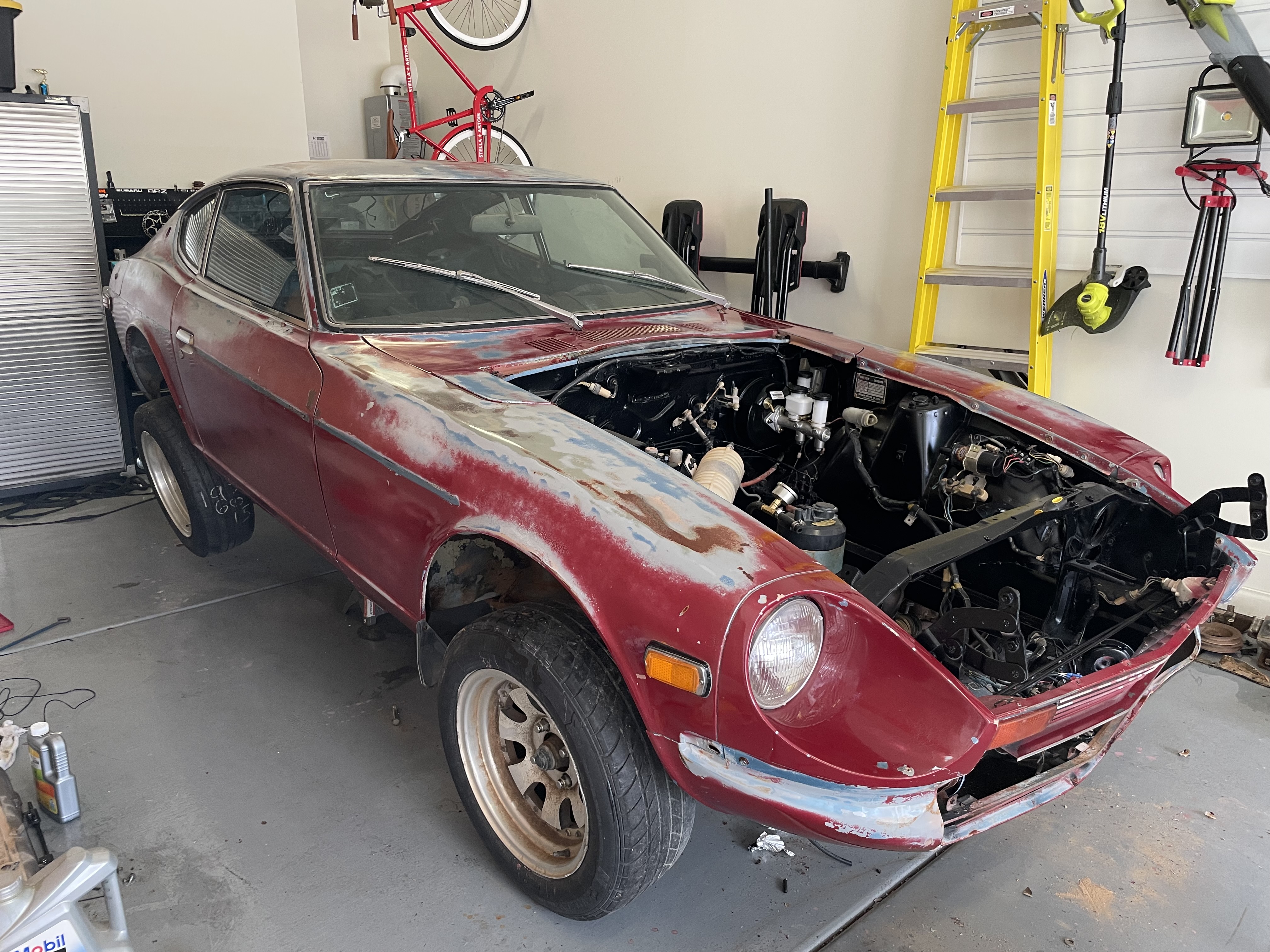

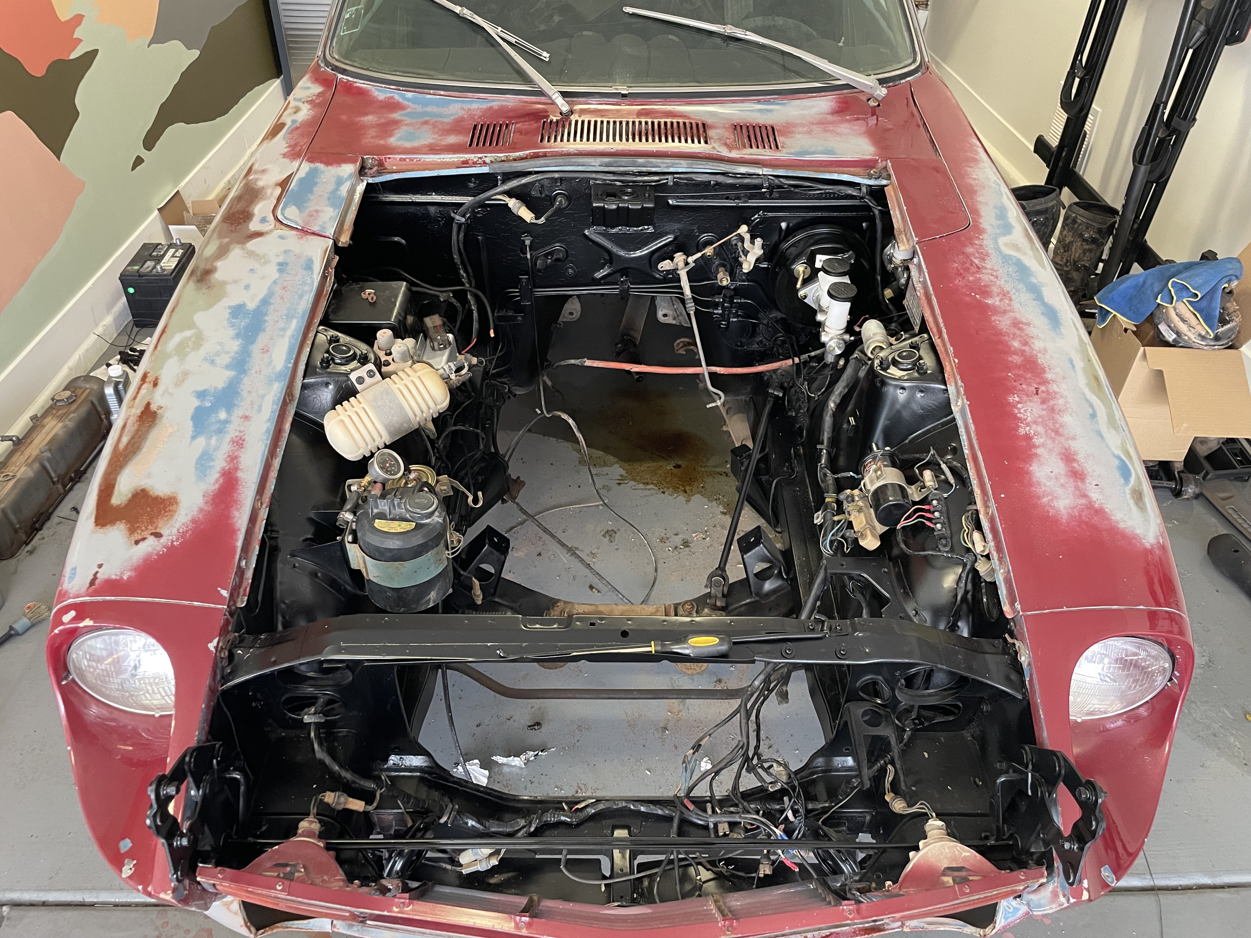

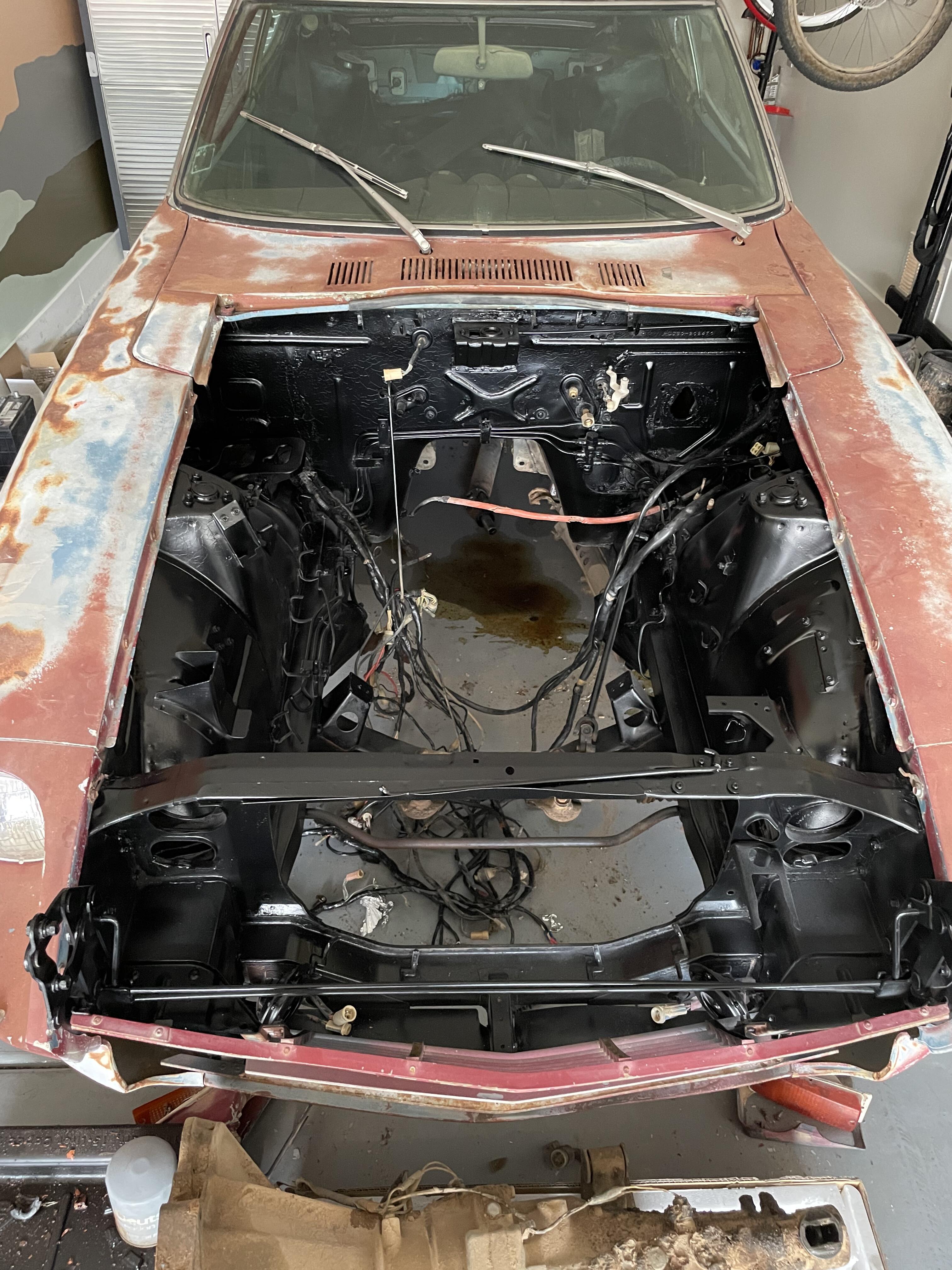

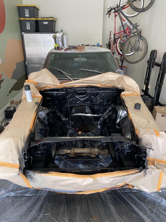

July 27, 20214 yr Author comment_625771 Finally got some new photos! The painting of the engine bay went smooth. It’s nothing permanent, but at least it will all be one color now 🙂 Edited July 27, 20214 yr by Barefootdan Link to comment https://www.classiczcars.com/forums/topic/65237-barefootdans-280z-build/?&page=7#findComment-625771 Share on other sites More sharing options...

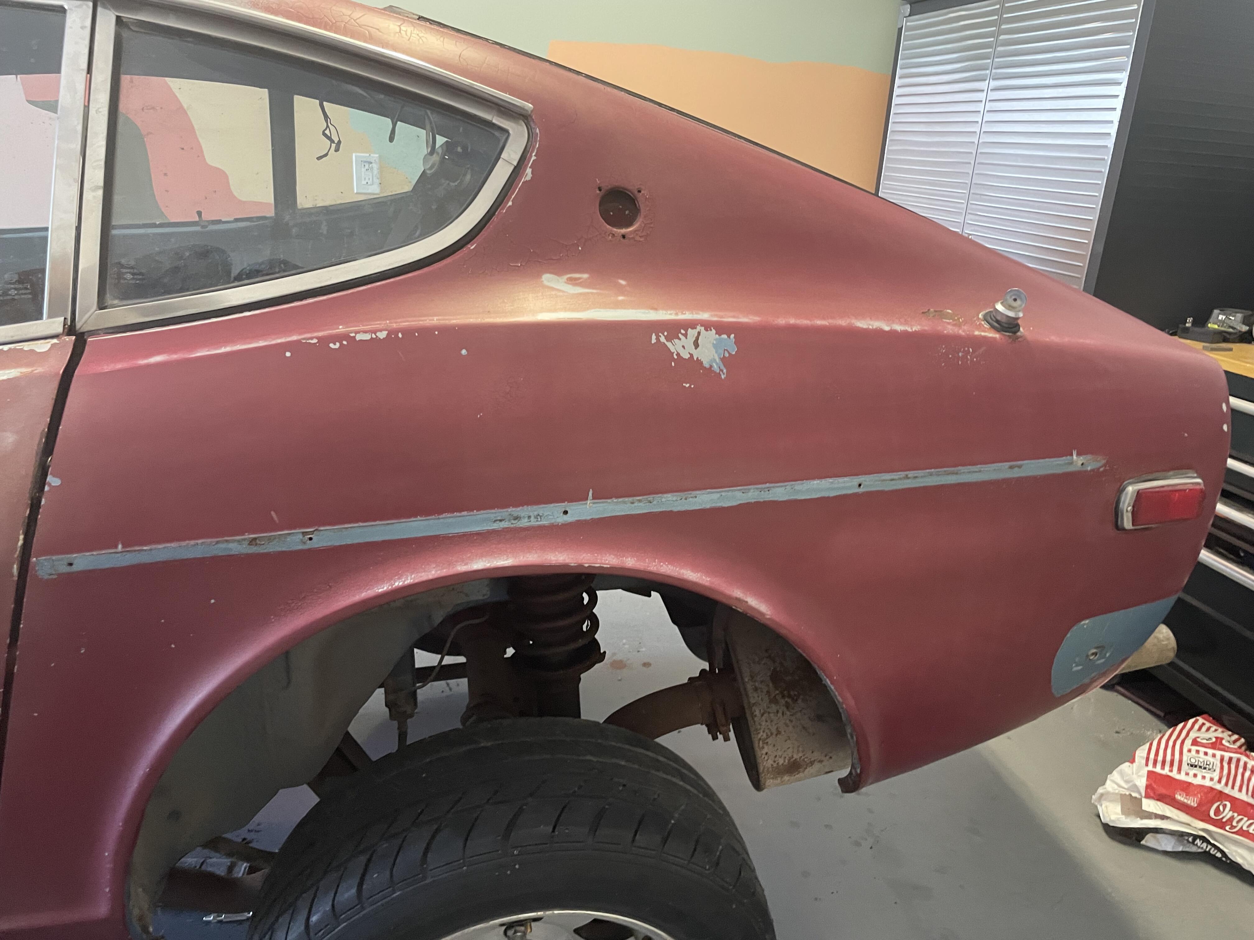

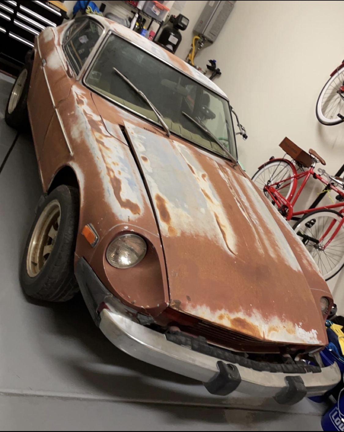

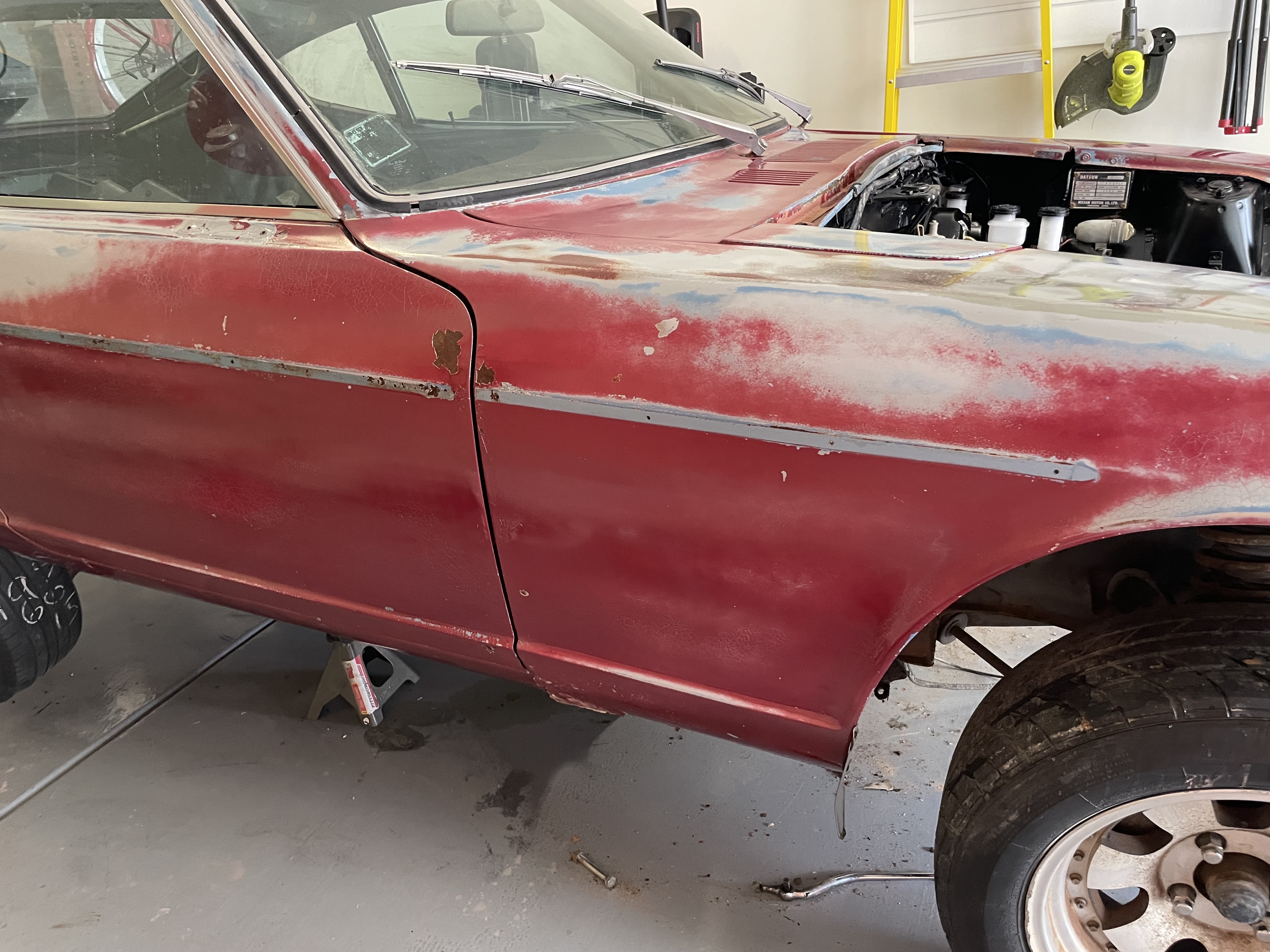

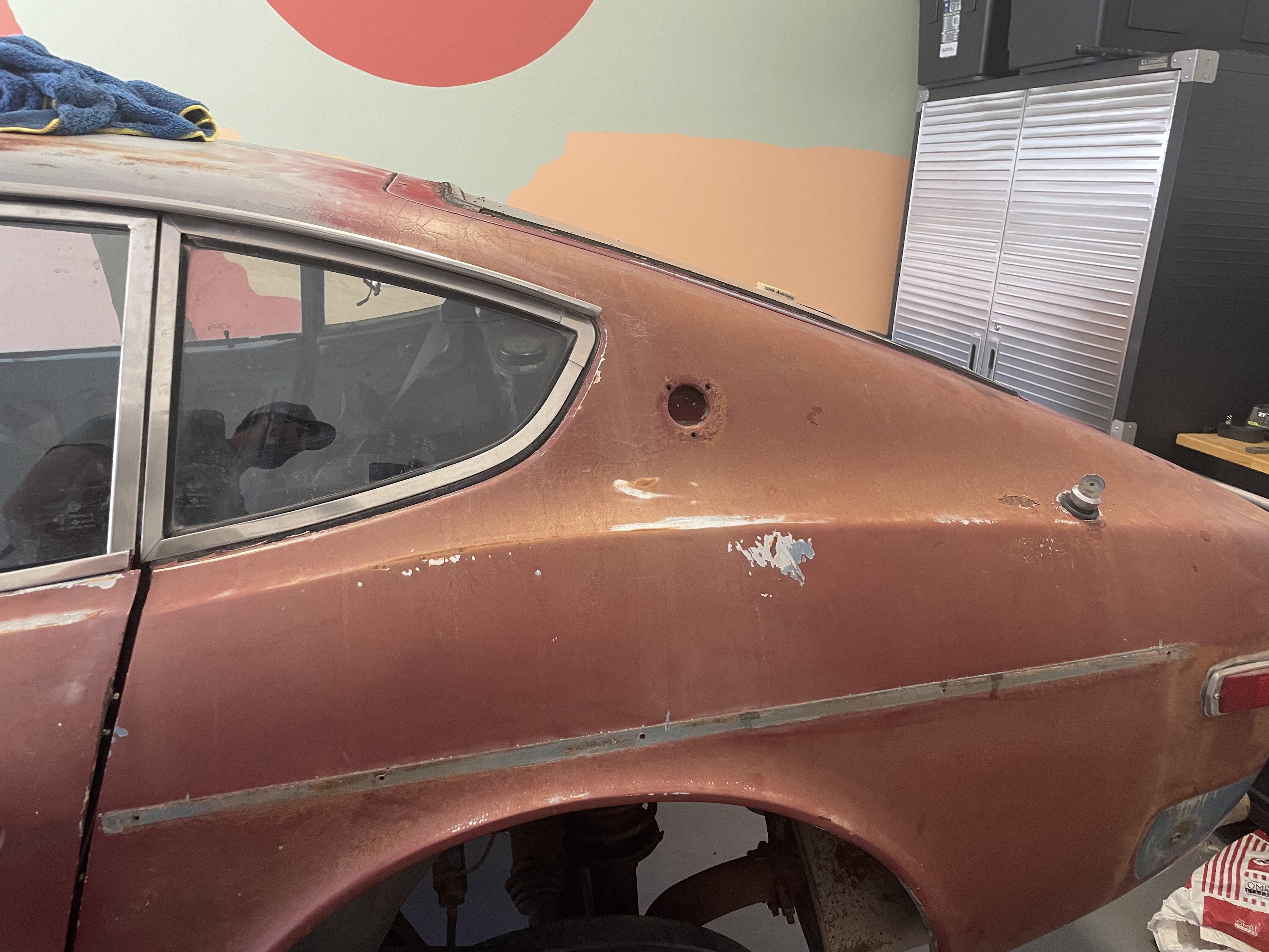

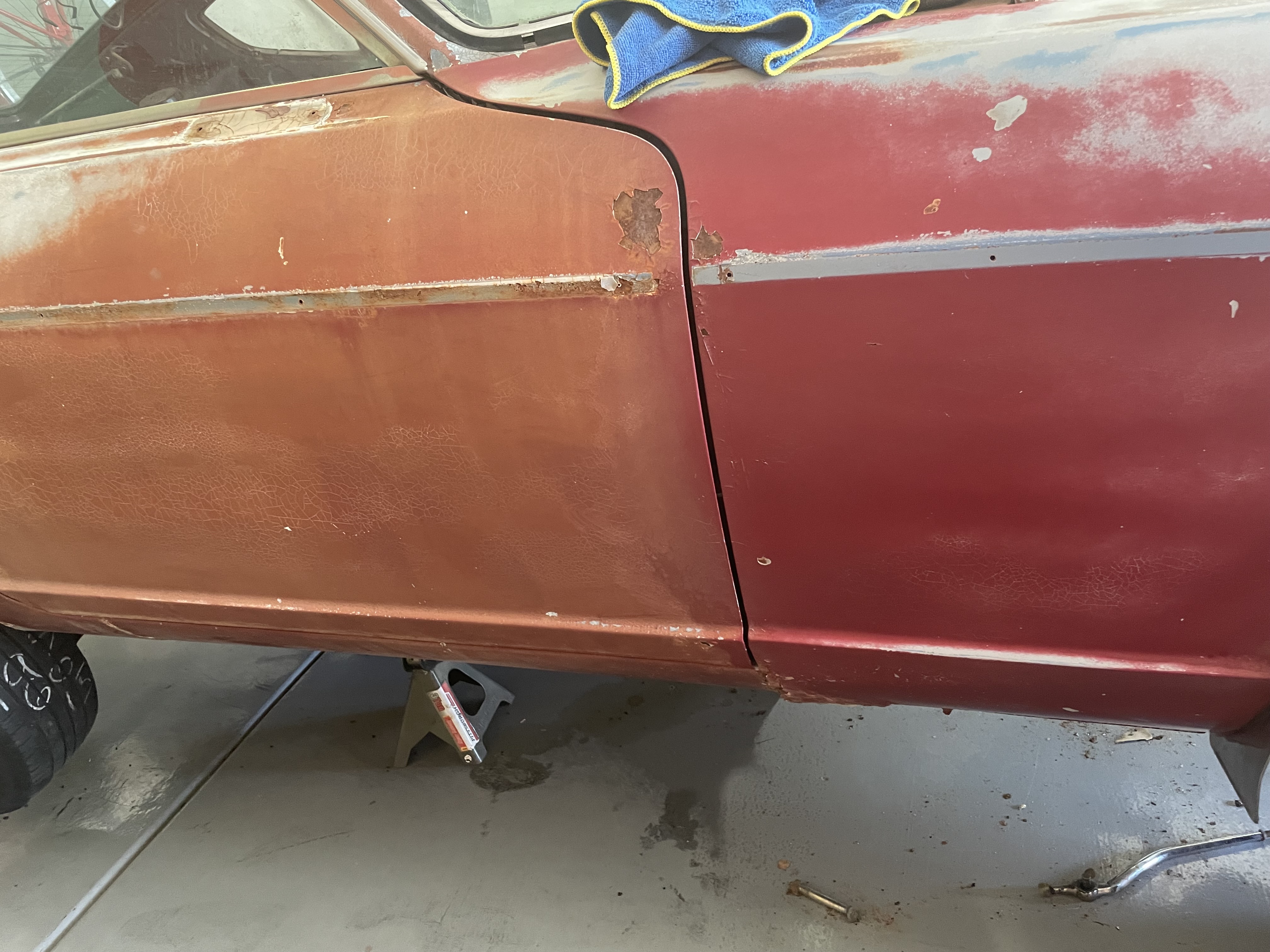

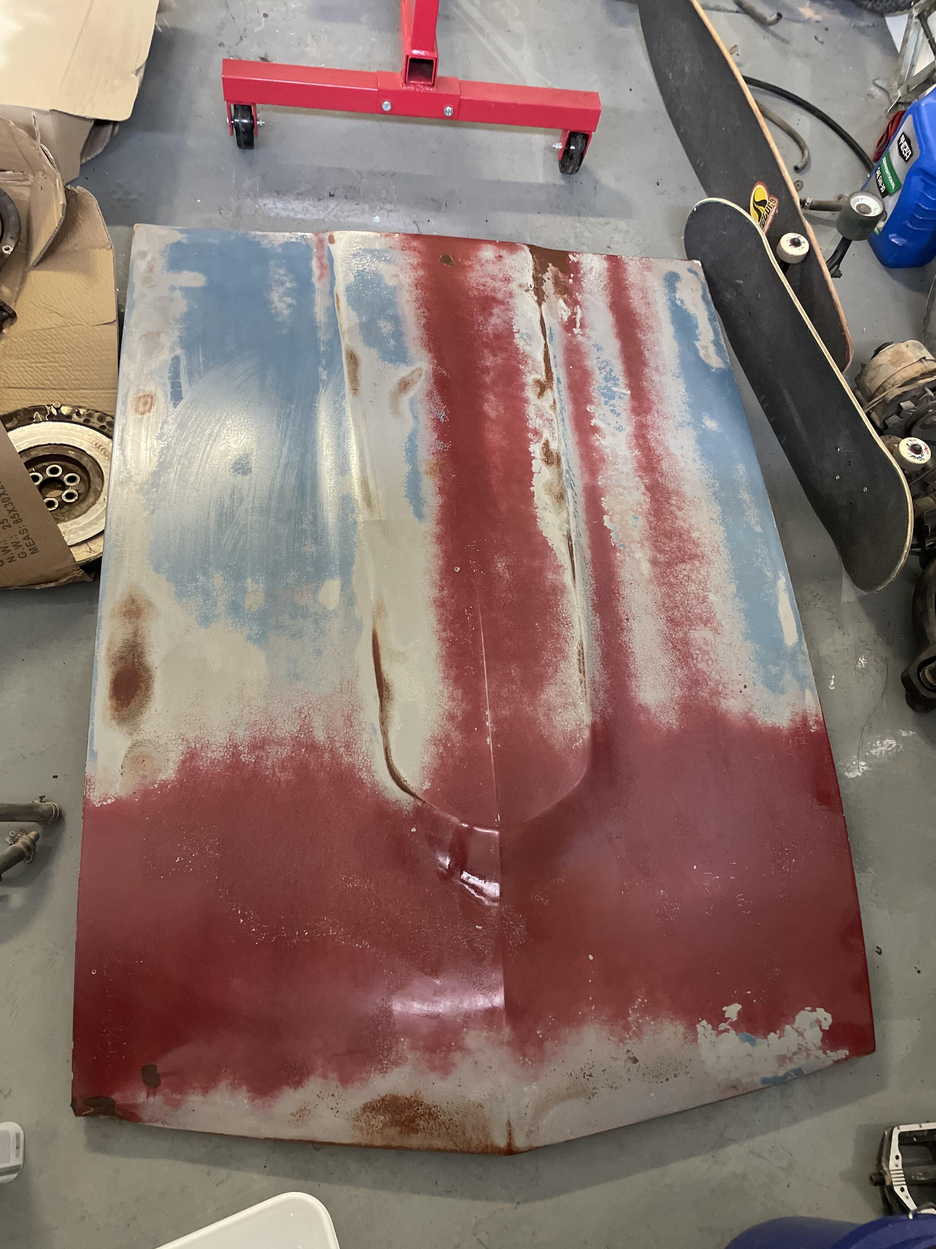

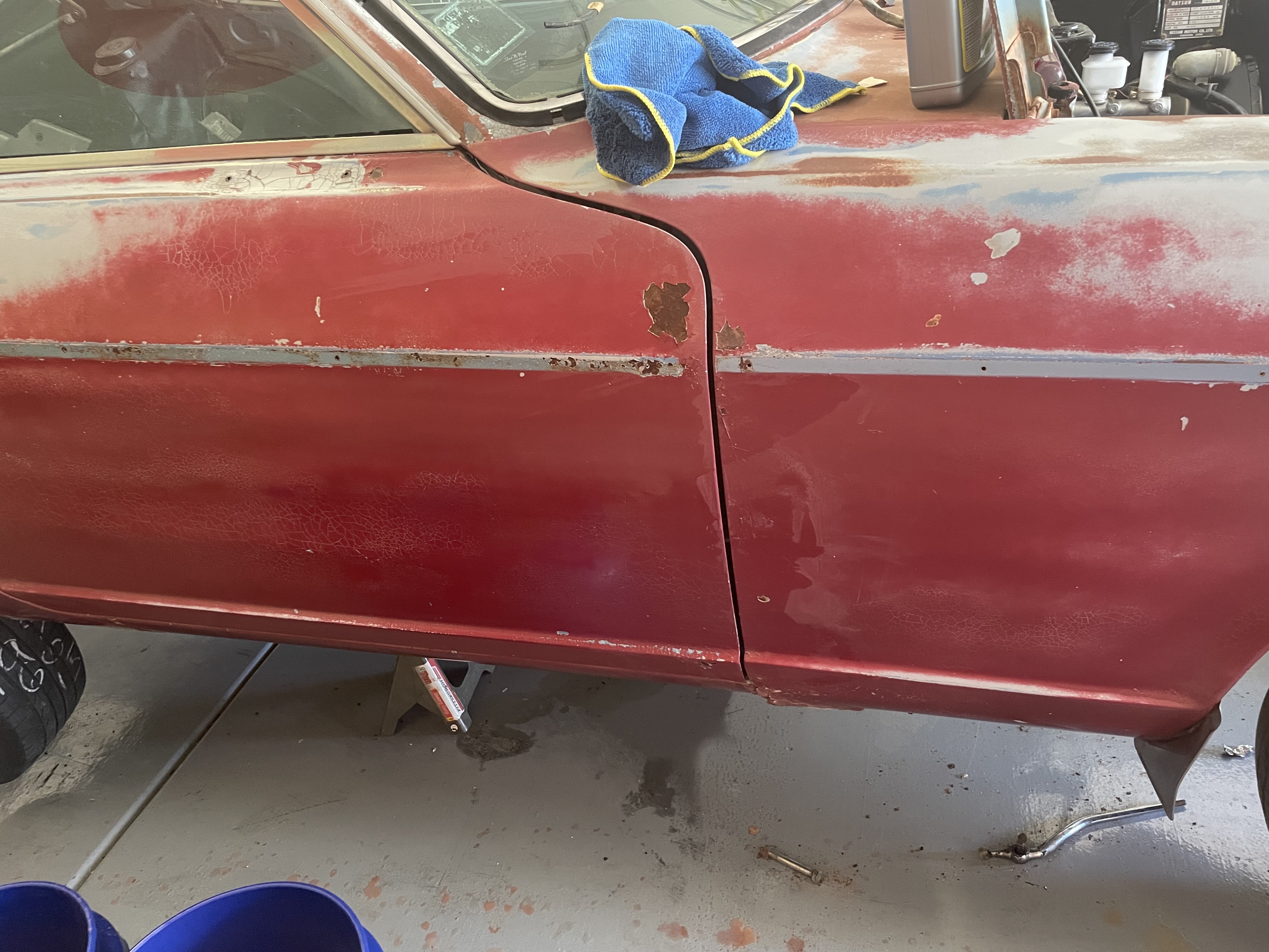

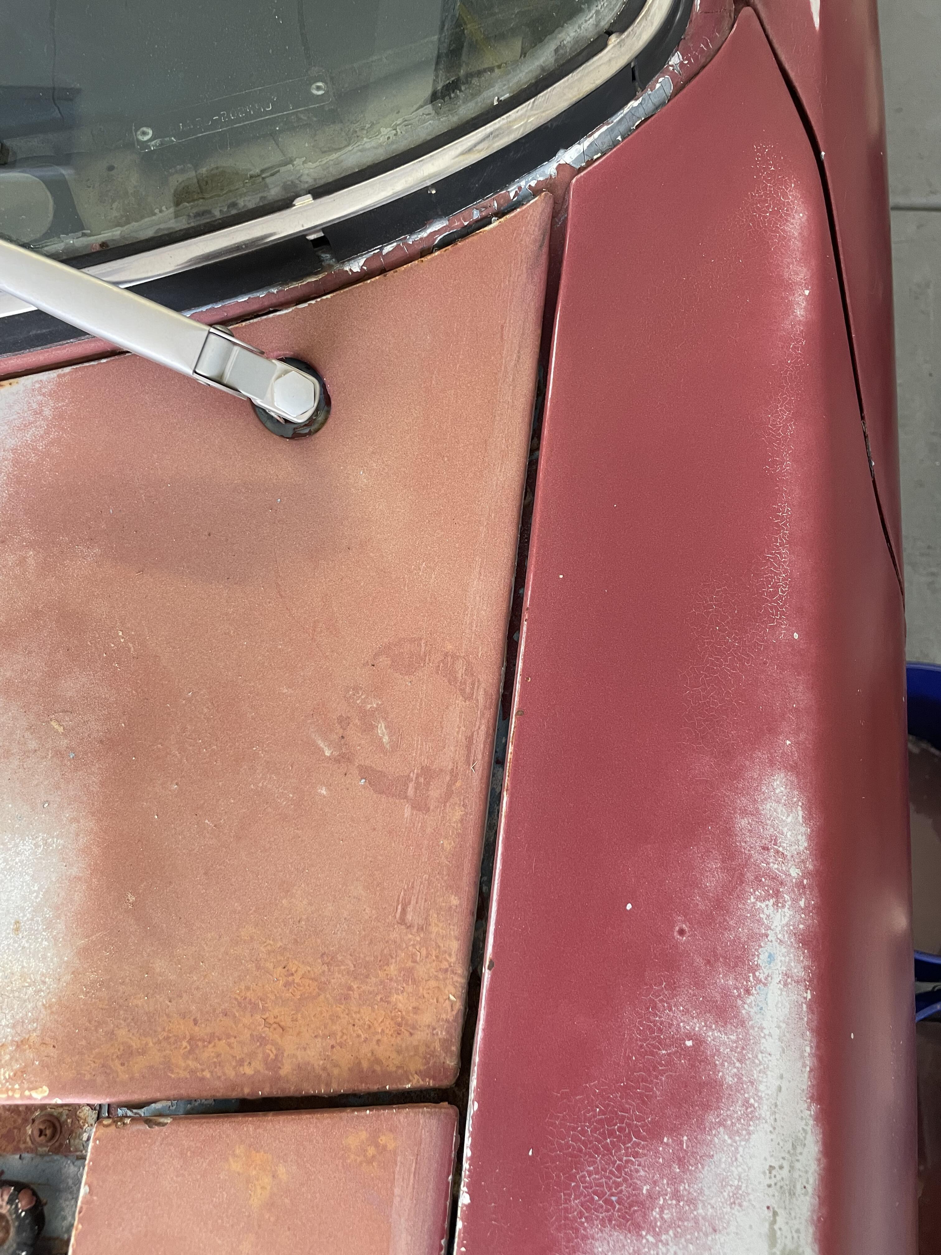

July 30, 20214 yr Author comment_626000 Thanks to @Zed Head for the idea of just cleaning up the body work for the time being. I spent the past couple days getting all the surface rust off the car. I originally thought that the paint faded to the ugly brown, but there was a nice surprise hiding underneath! I started off using a scotch pad and water. Then stepped up to some light CLR mix for the rust spots:  As I went through, my process changed and I didnt like the look of the bare metal (where the CLR took off the rust). So I went back to just water and scotch pad. I had to remind myself that we arent preparing for paint, and just trying to clean up the surface! 🙂 I didnt like how rough the surface felt still after, so I hit it with some fine steel wool to smooth things up a bit. This was taken right after a wipe down so it is still moist in some areas and streaky in others. But the difference was amazing. Here are a few more comparisons:  From there I went and grabbed some Penetrol to "seal" the paint temporarily. It gives a satin/gloss finish that also makes the colors and rust *Patina* some extra vibrance. Just a reference of where we started:  The streaks on the hood leveled out, I just took the photo too soon 🙂   She absolutely deserves better body work in the future, but this will at least give me a finish that I can wipe down without my microfiber snagging immediately! 😄 Link to comment https://www.classiczcars.com/forums/topic/65237-barefootdans-280z-build/?&page=7#findComment-626000 Share on other sites More sharing options...
