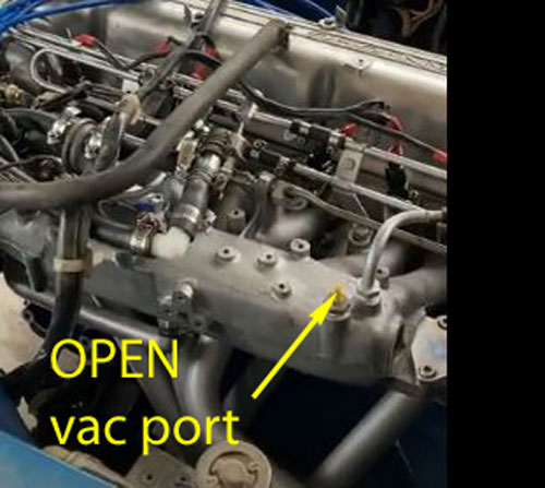

May 21, 20214 yr comment_621900 I've tried to follow this thread and it appears you a have a lot going on. Been there and done that . Don't give up you have to work one problem at a time and you will get there. The valves should not make that much noise. If they were adjusted correctly you should hear an even clatter. If they are tooo tight they wouldn't make much noise. In an earlier thread you mentioned spray bar gaskets. Do you have a spry bar on this car or do you have an oil hole in each lobe? you can't do both or you will have very low oil pressure. If you have a very flat lobe you can not adjust out the noise. Second it appears that you have NO vaccuun if i'm reading your gauge correctly. Where are you connecting the vacuum gauge? Third did you check the fuel pressure? The way use started the car it appears the pressure was low and it took three try to reach the 30 psi to start. Link to comment https://www.classiczcars.com/forums/topic/65230-1977-280z-efi-nightmare/?&page=12#findComment-621900 Share on other sites More sharing options...
May 21, 20214 yr Author comment_621901 @zclocksThanks for the morale boost. Definitely need it. Yah, I have no idea what is going on with the valves, but clearly it has issue. I will pop off the cover again tommorow and post my findings. It is just a spray bar that I had to make custom gaskets for. Thanks @Zed Head for the tip. So it turns out at 1k rpm I am getting 16Hg of vacuum. Maybe a little low, but the oil pan also pisses about a 1/5 of a cup of oil every night so I am sure that could be considered a small vacuum leak. I connected the gauge to the brake booster fitting on the intake. Another good thing to note is when I rev it to full throttle the vac pretty much goes to 0 and when I let off it shoots to about 25 Edited May 21, 20214 yr by ckurtz2 Link to comment https://www.classiczcars.com/forums/topic/65230-1977-280z-efi-nightmare/?&page=12#findComment-621901 Share on other sites More sharing options...
May 21, 20214 yr comment_621903 Hey, I think I see an open vac port. This should be plugged Link to comment https://www.classiczcars.com/forums/topic/65230-1977-280z-efi-nightmare/?&page=12#findComment-621903 Share on other sites More sharing options...
May 21, 20214 yr Author comment_621904 @zclocks my bad. Not sure where you saw that, but it is plugged now. Must have forgotten earlier when I was trying to figure out which vac port I could connect to. Link to comment https://www.classiczcars.com/forums/topic/65230-1977-280z-efi-nightmare/?&page=12#findComment-621904 Share on other sites More sharing options...

May 21, 20214 yr comment_621907 I snipped it from your video , but couldn't tell if it was plugged. A couple of vac sources are all vac lines suspect due to age, dip stick seal, pan gasket, maybe, cover plate, like where yours is plugged off on intake manifold. and valve cover gasket. Link to comment https://www.classiczcars.com/forums/topic/65230-1977-280z-efi-nightmare/?&page=12#findComment-621907 Share on other sites More sharing options...

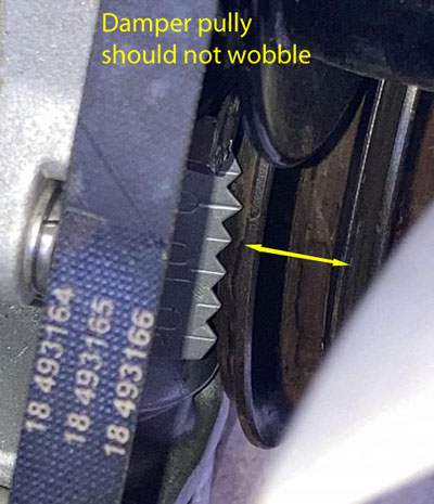

May 21, 20214 yr comment_621912 When that happens I usually say" I 'm here to take the secretary out to dinner! Something else I saw in a previous thread about damper pulley. This is near and dear to me as I just had to do mine several months ago. The damper should not wobble. Link to comment https://www.classiczcars.com/forums/topic/65230-1977-280z-efi-nightmare/?&page=12#findComment-621912 Share on other sites More sharing options...
