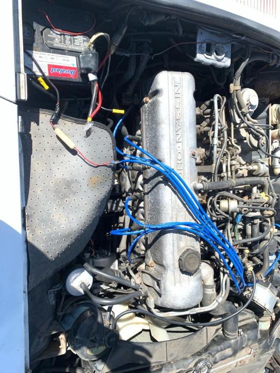

Im new to this im no grease monkey, and im 18
I have had trouble with my 1978 280z starting ive gotten the car to run even do a lap around but it has trouble when starting the car cranks and sounds like it wants to start but wont, starting fluid really helps to turn it on but if i let my foot off the clutch and off the gas the car will turn off, if i give it constant gas it will stay on as long as i keep giving it has if it dips under 1k rpm it will die, after many many attempts I can get the car to stay on and idles around 800-1000rpm and will stay on, im guessing it may be a fuel Issue it does not read temperature on the temp gauge so sensors may not be working. I can provide more info, photos, or videos if it could help you guys help me, im novice and have been going off forums i have no prior experience with cars this is the first, running tests will be difficult for me and will take me time but recommend away.
New parts list:
-ngk spark plugs and wires
-ignition coil
-new afm boot
-oil filter
-fuel filter
-new fuses
-new cap and rotor
-new alternator
-new battery cables
It does need a new battery as the battery is completely dead and must be jump started
Planning on getting a fuel pump, battery, and either fpr or cold start ignition valve
482541045cc80c0e8cce8f7993d8ab85.jpg&key=316d8d1a6038b86267b7e16148410280dfebb327f2fccb6c5d4329d73762fe1d
08cccee4d957d003aade19bec80e6037.jpg&key=6aaa0d8238df6f77dd2b6a2e983030a6e8a1dea68853160519f4e6c54bd35a02
f2dca281e2c80972bf45e882e98985ff.jpg&key=12f153c2d4eaf81698eef26fd638dade3e804aabb8d1ed9765d320fb63c97d60
c4435599019075112086393ca674bc8a.jpg&key=6fe88eab477b4b3140522381d2f3dcc23574c3fd1529826368de852a647bb99e

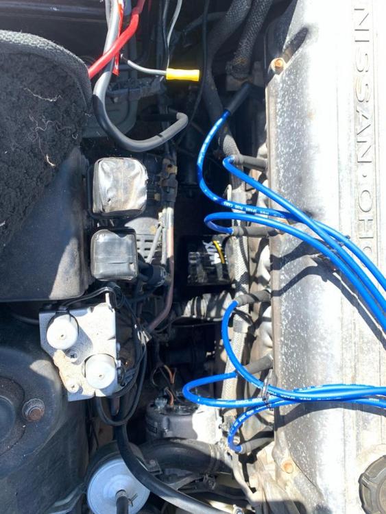

Here are some engine bay photos, the previous owner did some really bad jobs. For example that carpet to protect it from the rain which im planning on removing, and failing at installing a sub in the car. I couldn’t upload videos of the engine running sadly the app did not let me.

Just doing a favor for anyone else who tries to read your post.
Sorry but the run on train of thought tapping on the phone texts are hard to read... (Edited - I was being an arse.  Well done, Dylan.)
How long have you had the car and has it ever run right?
Edited by Zed Head
I've got the thought processes of an 18 year old so maybe I can help.
Fuel, fire and air are the main 3 things needed to run a combustion engine. You need to get them all working but can do so one at time.
Get a good battery, unhook the small solenoid wire on the starter. That should let the fuel pump run without cranking the car. Pull the hose off the top of the filter on the passenger's side up front in the engine bay. Put it in an empty gas can and see if you have a good flow of fuel.
Pull a spark plug and turn the motor over to look and see if you have a good spark.
Take the air filter out for testing. Clean any debris out of the air box.
Not necessarily in that order but you'll have to do those basic things no matter what.
I would put a new filter on and some new 10w30 oil. Get the cheap stuff at walmart if the car hasn't run in awhile. Clean the spark plugs before buying new ones.

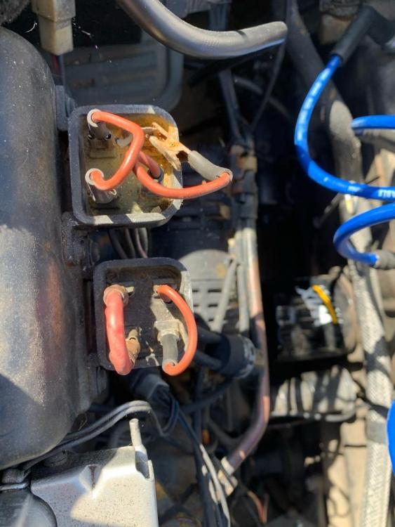

That's always been a hard buger to figure out, the idle adjustment. This thread shows what you need to be turning. Good luck and as said above keep us posted. Pictures are very helful also. I'd like to see the fusible links on the passenger's side, about a foot forward of the battery. Those are super important to your car.
